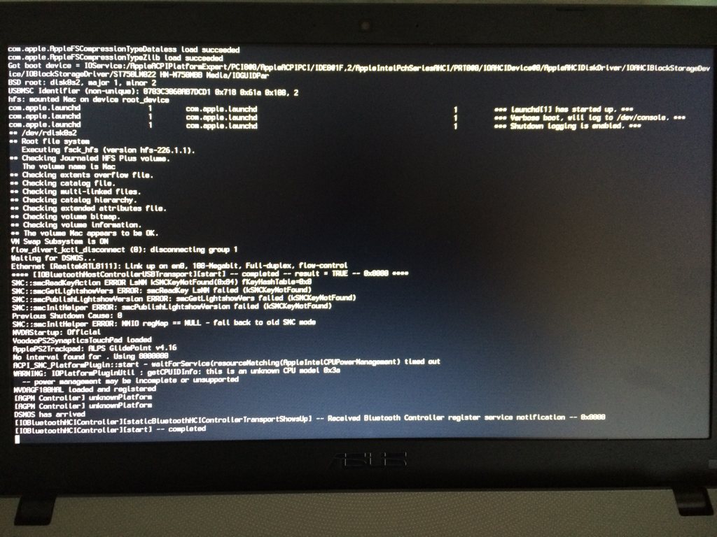

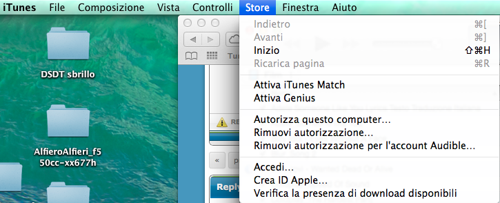

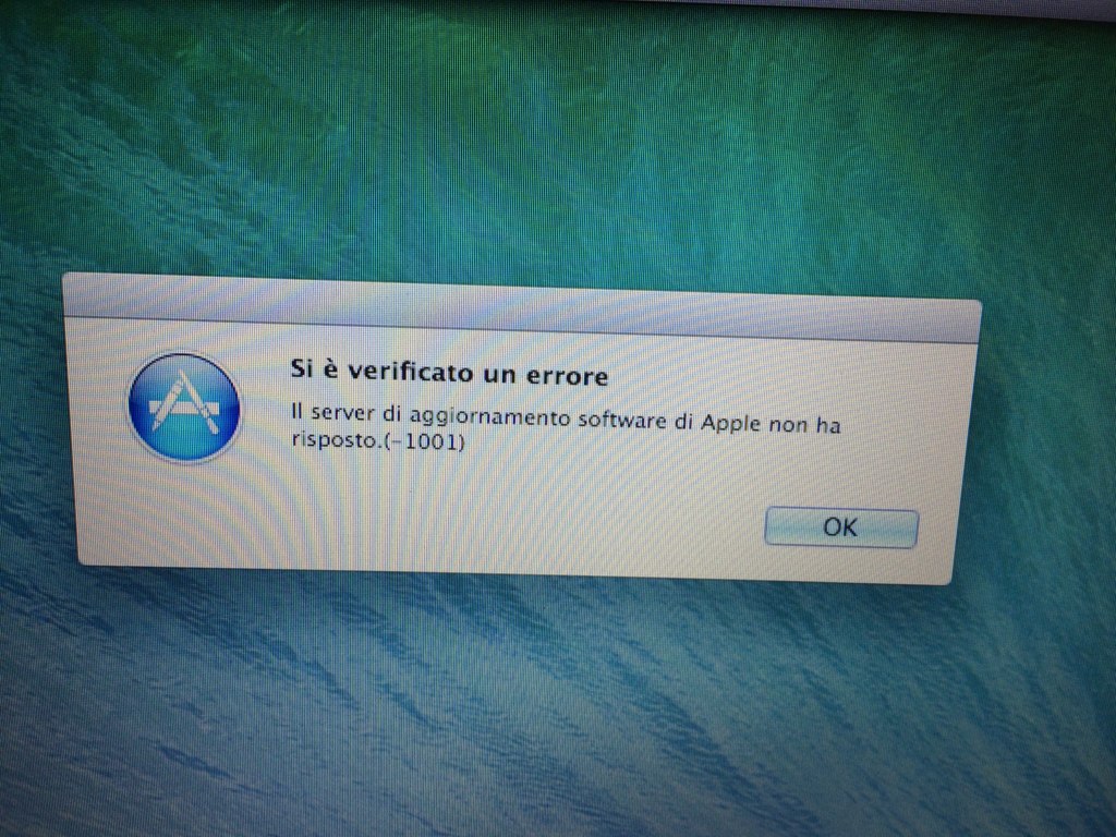

Simone94toro Posted April 10, 2014 Share Posted April 10, 2014 I kext della scheda video non li ho ancora installati, volevo prima aggiornare ma guarda che mi dice: Link to comment https://www.insanelymac.com/forum/topic/296808-mavericks-1092-su-asus-f550c/page/28/#findComment-2011740 Share on other sites More sharing options...
carbo178 Posted April 10, 2014 Share Posted April 10, 2014 Apri iTunes, vai su Store e clicca "autorizza questo computer" (devi anche avere un id Apple) Altrimenti scarica l'update da questo link: http://support.apple.com/kb/DL1725 Link to comment https://www.insanelymac.com/forum/topic/296808-mavericks-1092-su-asus-f550c/page/28/#findComment-2011743 Share on other sites More sharing options...
Simone94toro Posted April 10, 2014 Share Posted April 10, 2014 @carbo mi si blocca nuovamente all'avvio Link to comment https://www.insanelymac.com/forum/topic/296808-mavericks-1092-su-asus-f550c/page/28/#findComment-2011747 Share on other sites More sharing options...
carbo178 Posted April 10, 2014 Share Posted April 10, 2014 Prova -x, se ancora non si avvia devi avviare con -s scrivere i comandi: fsck -fymount -uw /mkdir /kext_backupcd /System/Library/Extensionsmv GeForce* NVDA* /kext_backuprm ../Caches/com.apple.kext.caches/Startup/kernelcachereboot Link to comment https://www.insanelymac.com/forum/topic/296808-mavericks-1092-su-asus-f550c/page/28/#findComment-2011749 Share on other sites More sharing options...

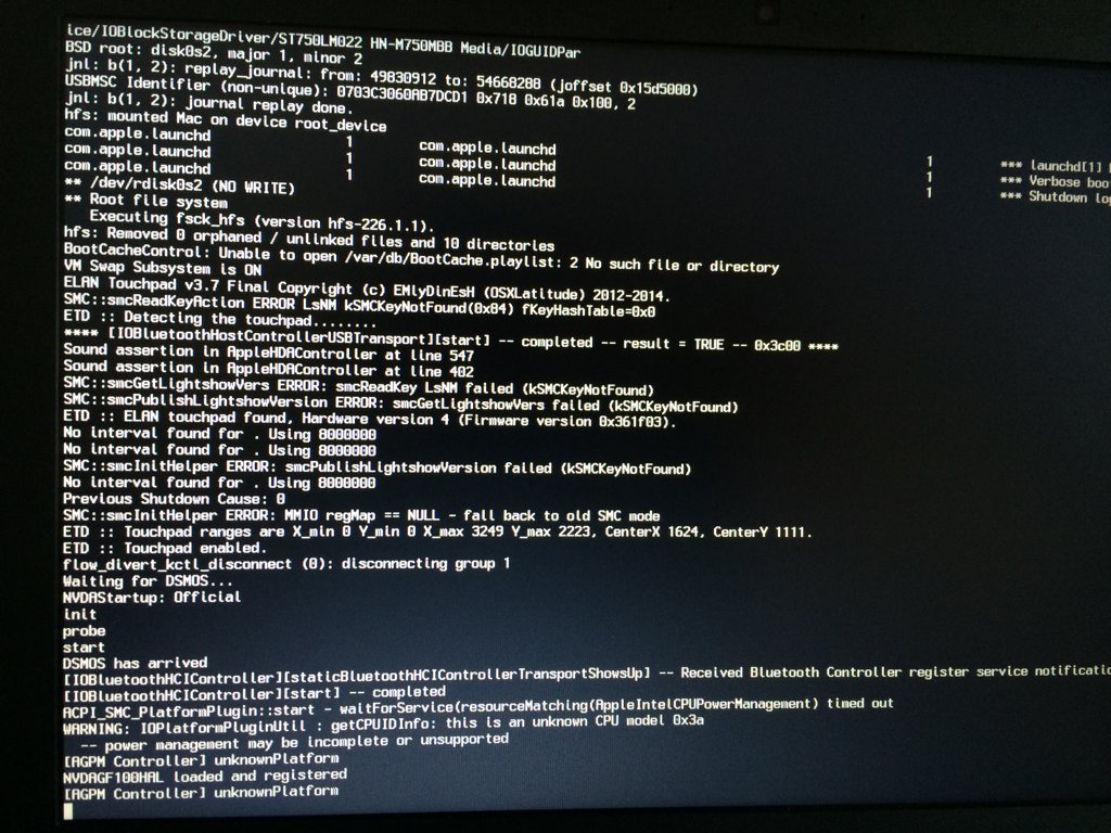

Simone94toro Posted April 10, 2014 Share Posted April 10, 2014 Con -x non si avvia! Provo con - s Link to comment https://www.insanelymac.com/forum/topic/296808-mavericks-1092-su-asus-f550c/page/28/#findComment-2011750 Share on other sites More sharing options...

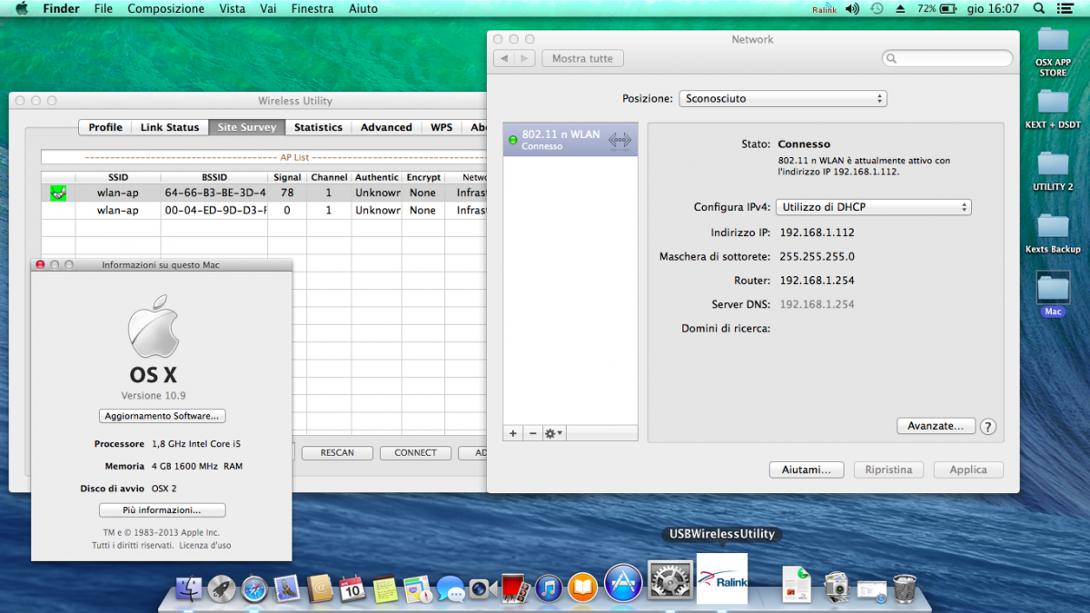

AndyB82 Posted April 10, 2014 Share Posted April 10, 2014 AGGIORNAMENTO SITUAZIONE: Anche la WiFi ora è funzionante!!! Grazie al Dongle USB con chip Ralink RT5370 1 Link to comment https://www.insanelymac.com/forum/topic/296808-mavericks-1092-su-asus-f550c/page/28/#findComment-2011753 Share on other sites More sharing options...
carbo178 Posted April 10, 2014 Share Posted April 10, 2014 AGGIORNAMENTO SITUAZIONE: Anche la WiFi ora è funzionante!!! Grazie al Dongle USB con chip Ralink RT5370 Puoi fare uno screen di resoconto di sistema-audio? Link to comment https://www.insanelymac.com/forum/topic/296808-mavericks-1092-su-asus-f550c/page/28/#findComment-2011754 Share on other sites More sharing options...

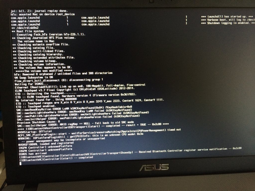

Simone94toro Posted April 10, 2014 Share Posted April 10, 2014 Carbo niente si blocca Link to comment https://www.insanelymac.com/forum/topic/296808-mavericks-1092-su-asus-f550c/page/28/#findComment-2011759 Share on other sites More sharing options...
carbo178 Posted April 10, 2014 Share Posted April 10, 2014 Avvia con -v altrimenti non si vede nulla Link to comment https://www.insanelymac.com/forum/topic/296808-mavericks-1092-su-asus-f550c/page/28/#findComment-2011761 Share on other sites More sharing options...
Simone94toro Posted April 10, 2014 Share Posted April 10, 2014 Carbo niente si blocca Sorry ho sbagliato foto xD Avevo* Link to comment https://www.insanelymac.com/forum/topic/296808-mavericks-1092-su-asus-f550c/page/28/#findComment-2011764 Share on other sites More sharing options...

AndyB82 Posted April 10, 2014 Share Posted April 10, 2014 Puoi fare uno screen di resoconto di sistema-audio? Si, appena ho 5 minuti liberi lo faccio! Link to comment https://www.insanelymac.com/forum/topic/296808-mavericks-1092-su-asus-f550c/page/28/#findComment-2011773 Share on other sites More sharing options...
