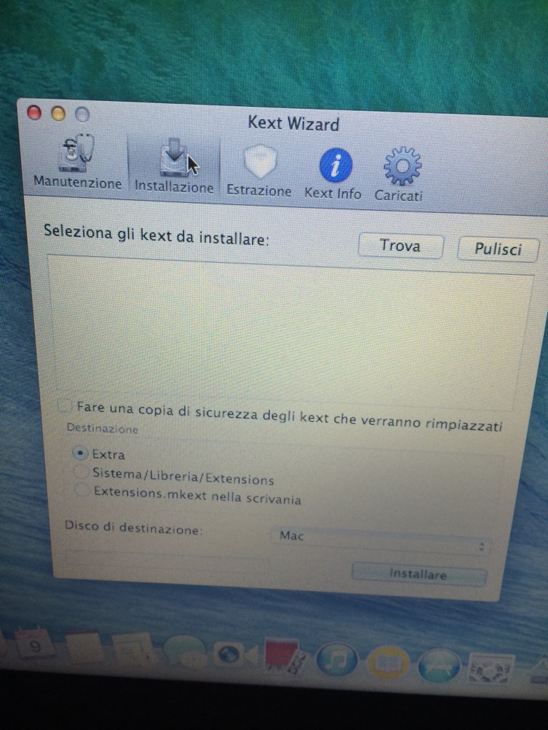

Simone94toro Posted April 9, 2014 Share Posted April 9, 2014 Ragazzi da kext wizard, cosa devo scegliere? Â 1, 2 o 3? Link to comment https://www.insanelymac.com/forum/topic/296808-mavericks-1092-su-asus-f550c/page/27/#findComment-2011579 Share on other sites More sharing options...
carbo178 Posted April 9, 2014 Share Posted April 9, 2014 Devi installare in S/L/E (2) Link to comment https://www.insanelymac.com/forum/topic/296808-mavericks-1092-su-asus-f550c/page/27/#findComment-2011580 Share on other sites More sharing options...

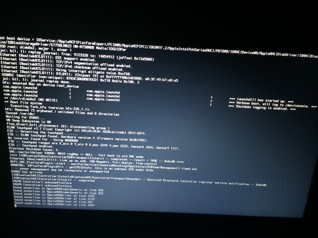

Simone94toro Posted April 9, 2014 Share Posted April 9, 2014 Okok! Sono riuscito a far funzionare mouse, batteria, lettore dvd e ethernet ora provo la scheda video e l'audio ? @carbo iinstallando i kext video che mi hai fornito non avvia e si blocca a questa schermata Link to comment https://www.insanelymac.com/forum/topic/296808-mavericks-1092-su-asus-f550c/page/27/#findComment-2011585 Share on other sites More sharing options...
carbo178 Posted April 9, 2014 Share Posted April 9, 2014 Avvia con GraphicsEnabler=No dart=0 Link to comment https://www.insanelymac.com/forum/topic/296808-mavericks-1092-su-asus-f550c/page/27/#findComment-2011589 Share on other sites More sharing options...

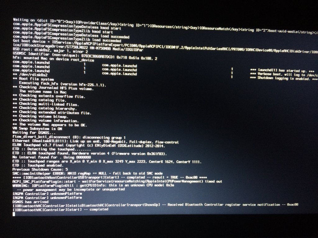

Simone94toro Posted April 9, 2014 Share Posted April 9, 2014 Nulla si blocca qui Link to comment https://www.insanelymac.com/forum/topic/296808-mavericks-1092-su-asus-f550c/page/27/#findComment-2011592 Share on other sites More sharing options...

Simone94toro Posted April 9, 2014 Share Posted April 9, 2014 Si blocca alla prima schermata che ho postato!! -.-' Link to comment https://www.insanelymac.com/forum/topic/296808-mavericks-1092-su-asus-f550c/page/27/#findComment-2011607 Share on other sites More sharing options...
carbo178 Posted April 9, 2014 Share Posted April 9, 2014 Allora evidentemente i kext che ti ho postato non sono della giusta versione (questi sono estratti dalla 10.9.2) Avvia con -s poi quando sarà il momento di scrivere digita questo:  fsck -fymount -uw /mkdir /kext_backupcd /System/Library/Extensionsmv AppleIntelHD* AppleIntelSNB* AppleIntelFramebuffer* /kext_backuprm ../Caches/com.apple.kext.caches/Startup/kernelcachereboot  Arrivato al desktop lancia aggiornamento software ed aggiorna alla 10.9.2 Link to comment https://www.insanelymac.com/forum/topic/296808-mavericks-1092-su-asus-f550c/page/27/#findComment-2011611 Share on other sites More sharing options...

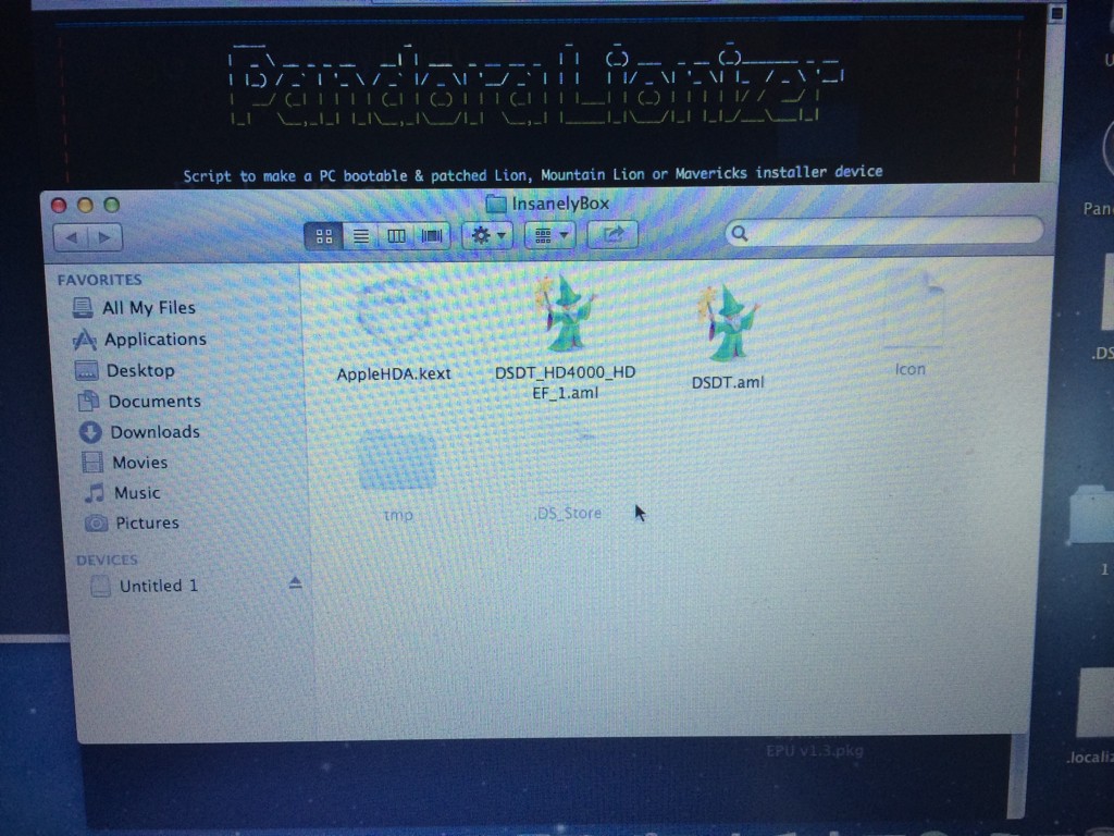

Simone94toro Posted April 10, 2014 Share Posted April 10, 2014 Carbo sto rifacendo la penna usb, xk non si avviava con i flag e così metto anche il nuovo dsdt! Nell'insanely box ci sono altre cartelle, probabilmente quei file che mi avevi fatto mettere qualche giorno fa, quelli li elimino e lascio solo il DSDT che mi hai allegato o li lascio? Questi sono i file presenti: Link to comment https://www.insanelymac.com/forum/topic/296808-mavericks-1092-su-asus-f550c/page/27/#findComment-2011695 Share on other sites More sharing options...
carbo178 Posted April 10, 2014 Share Posted April 10, 2014 Lascia solo DSDT.aml Link to comment https://www.insanelymac.com/forum/topic/296808-mavericks-1092-su-asus-f550c/page/27/#findComment-2011701 Share on other sites More sharing options...
