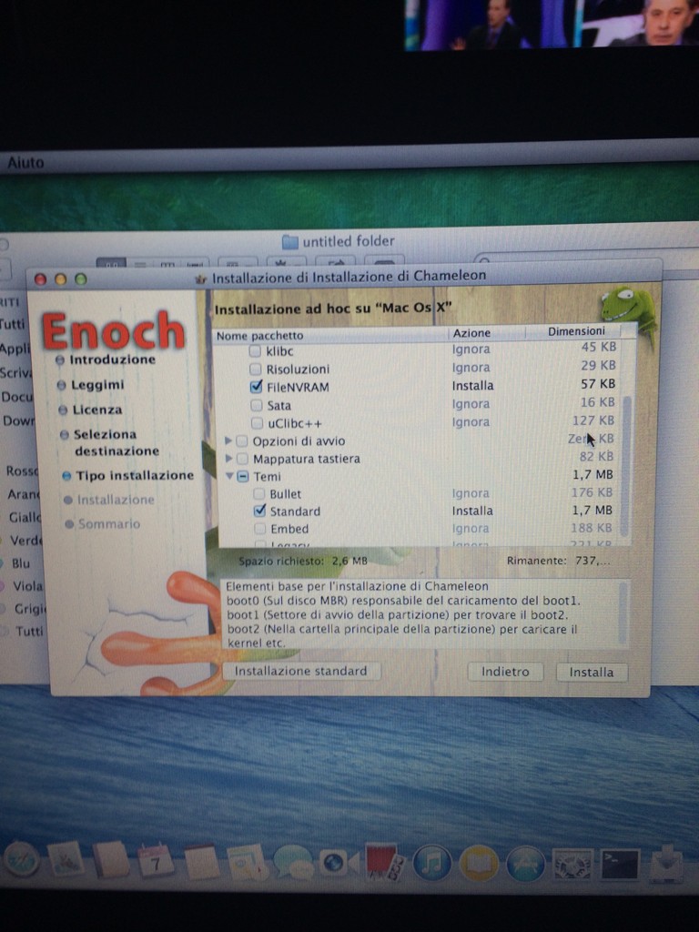

Simone94toro Posted April 7, 2014 Share Posted April 7, 2014 Ok! Scelto fileNVRAM e TEMA STANDARD Link to comment https://www.insanelymac.com/forum/topic/296808-mavericks-1092-su-asus-f550c/page/21/#findComment-2010903 Share on other sites More sharing options...
carbo178 Posted April 7, 2014 Share Posted April 7, 2014 OK, ora fai il resto e riavvia senza usb Link to comment https://www.insanelymac.com/forum/topic/296808-mavericks-1092-su-asus-f550c/page/21/#findComment-2010905 Share on other sites More sharing options...
Simone94toro Posted April 7, 2014 Share Posted April 7, 2014 La cartella extra è quella della chiavina usb di pandora? E sove la vado a mettere esattamente? E quella cartella extra appena creata dal wizard la devo eliminare? Link to comment https://www.insanelymac.com/forum/topic/296808-mavericks-1092-su-asus-f550c/page/21/#findComment-2010906 Share on other sites More sharing options...
carbo178 Posted April 7, 2014 Share Posted April 7, 2014 La devi mettere nella root del disco, dove ci sono le cartelle "Applicazioni" "Utenti" "Sistema" e "Libreria" (vai a sostituire quella appena creata) Link to comment https://www.insanelymac.com/forum/topic/296808-mavericks-1092-su-asus-f550c/page/21/#findComment-2010910 Share on other sites More sharing options...

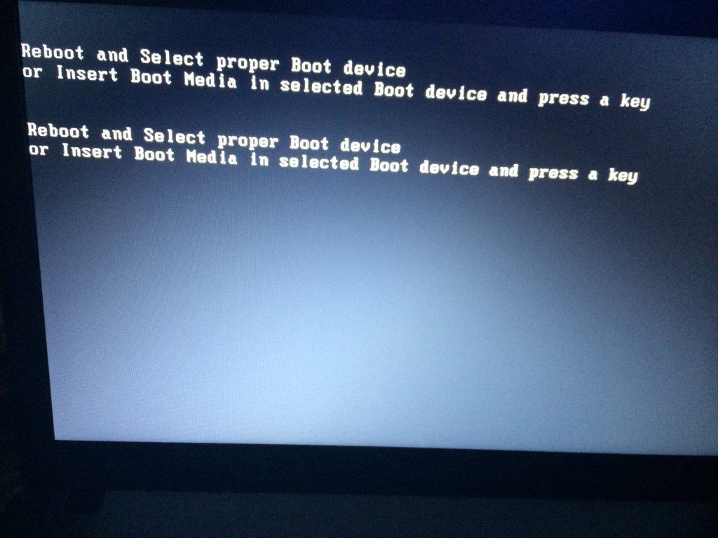

Simone94toro Posted April 7, 2014 Share Posted April 7, 2014 Ecco che succede Dal bios non vede più l'hd pare! Se inserisco l'usb di pandora ecco cosa c'è scritto! Link to comment https://www.insanelymac.com/forum/topic/296808-mavericks-1092-su-asus-f550c/page/21/#findComment-2010912 Share on other sites More sharing options...
alfieroalfieri Posted April 7, 2014 Author Share Posted April 7, 2014 avvia la chiavetta come se dovessi fare un'installazione poi apri utility disk e ripara l'hd! Ma pandora te lo vede? Link to comment https://www.insanelymac.com/forum/topic/296808-mavericks-1092-su-asus-f550c/page/21/#findComment-2010916 Share on other sites More sharing options...
Simone94toro Posted April 7, 2014 Share Posted April 7, 2014 Fatto ma nessun risultato! Devo comunque inserire l'usb! Però se avvio con l'usb è comparso il tema! @intendi dire se il bios riconosce l'usb dove è caricata pandora? Link to comment https://www.insanelymac.com/forum/topic/296808-mavericks-1092-su-asus-f550c/page/21/#findComment-2010920 Share on other sites More sharing options...

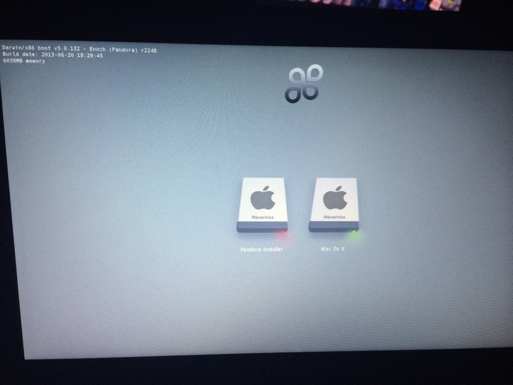

Aigors Posted April 7, 2014 Share Posted April 7, 2014 io pero vedo che l'hard disk lo vede, nella schermata dove compare il tema, vedo sia pandora che mavericks, suppongo che mavericks sia l'hard disk Prova a fare cosi', lascia la chiavetta usb nel portatile, riavvia, quando compare il tema invece di avviare da pandora, avvia da mavericks, una volta li dentro puoi installare il bootloader con annessi e connessi dando come disco target mavericks Link to comment https://www.insanelymac.com/forum/topic/296808-mavericks-1092-su-asus-f550c/page/21/#findComment-2010939 Share on other sites More sharing options...
Simone94toro Posted April 7, 2014 Share Posted April 7, 2014 Si ma appunto solo quando avvio con l'usb inserita, xk il bios vede come primo boot l'usb! Così parte il bootloader di pandora e vede l'hd Link to comment https://www.insanelymac.com/forum/topic/296808-mavericks-1092-su-asus-f550c/page/21/#findComment-2010940 Share on other sites More sharing options...

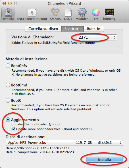

carbo178 Posted April 7, 2014 Share Posted April 7, 2014 Chameleon wizard finestra principale clicca semplicemente Installa, ti cambierà solo il file di boot, che sarà quello di Chameleon e non di Enoch Link to comment https://www.insanelymac.com/forum/topic/296808-mavericks-1092-su-asus-f550c/page/21/#findComment-2010943 Share on other sites More sharing options...

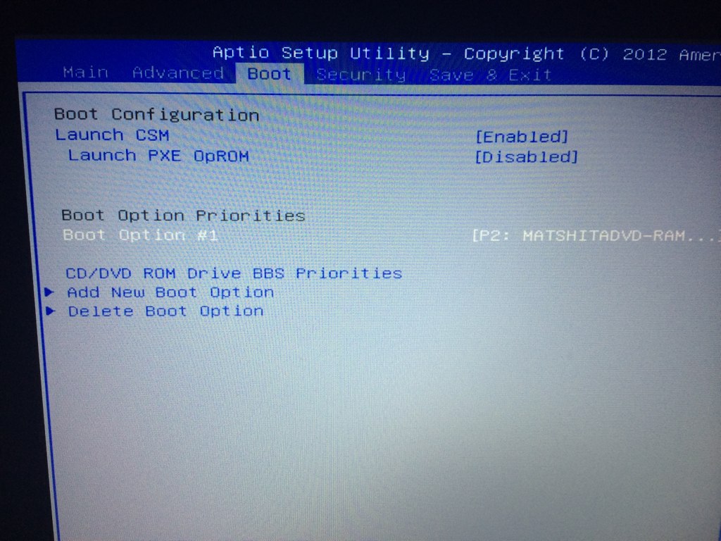

Simone94toro Posted April 7, 2014 Share Posted April 7, 2014 L'errore iniziale è lo stesso! Cooè appunto il problema secondo me è proprio il bios! Può essere che l'hd essendo stato formattato in un'altro formato questo non viene riconosciuto da bios? Link to comment https://www.insanelymac.com/forum/topic/296808-mavericks-1092-su-asus-f550c/page/21/#findComment-2010945 Share on other sites More sharing options...

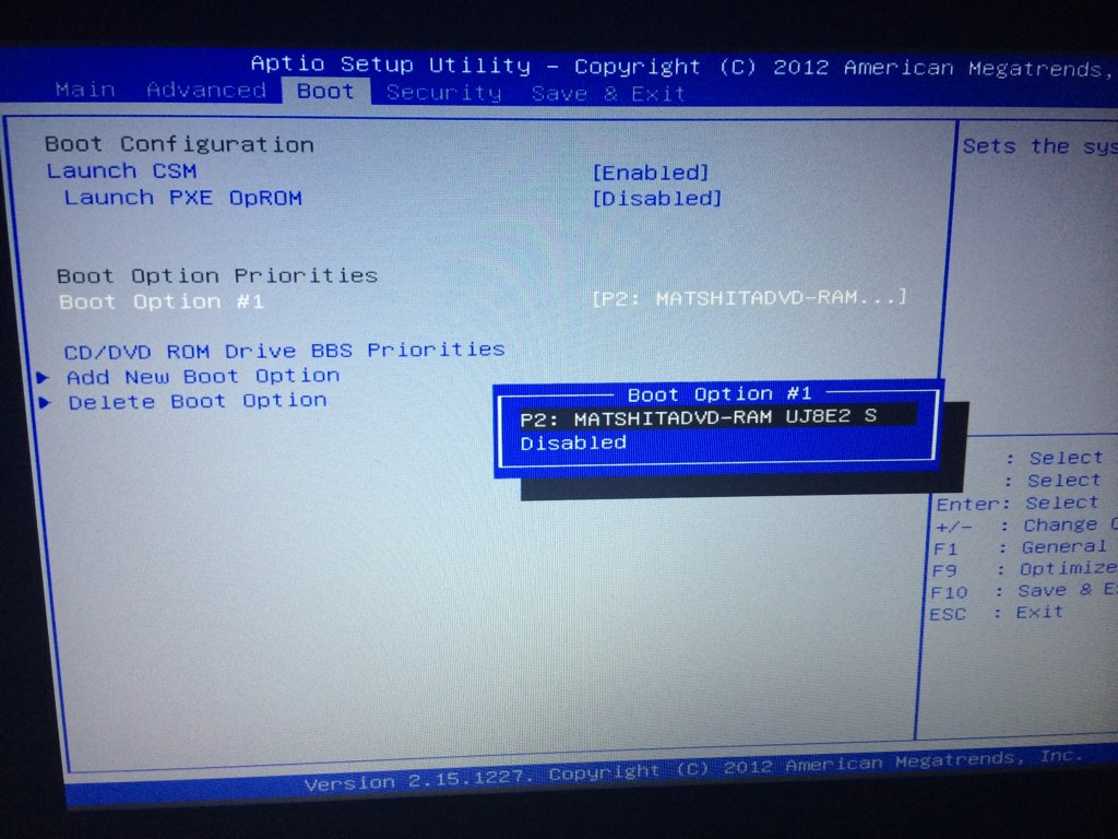

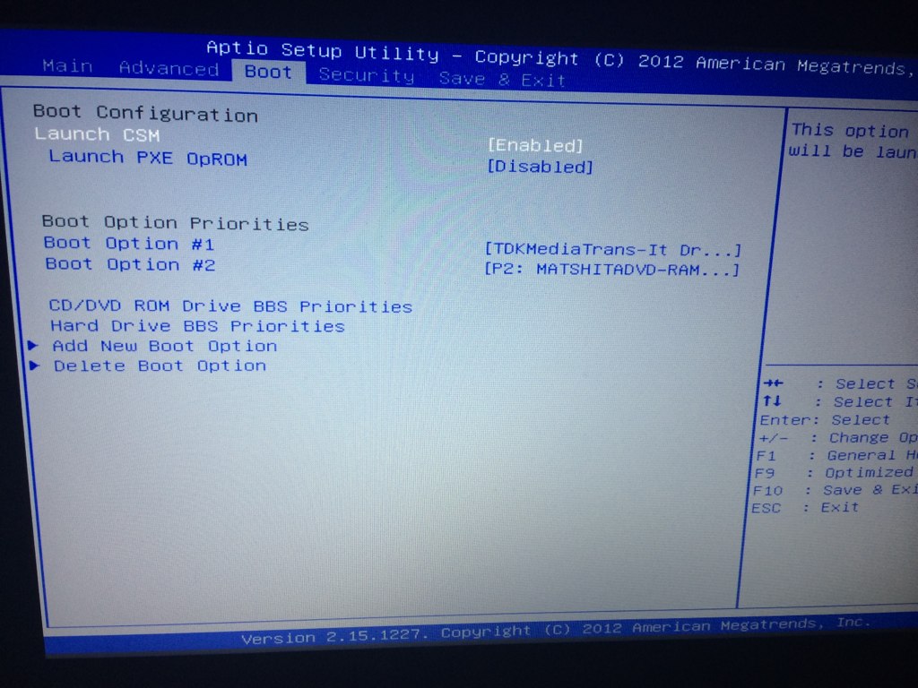

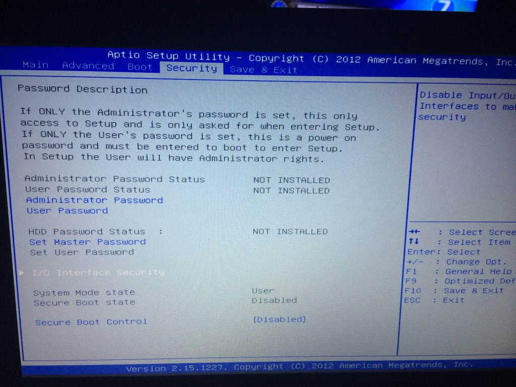

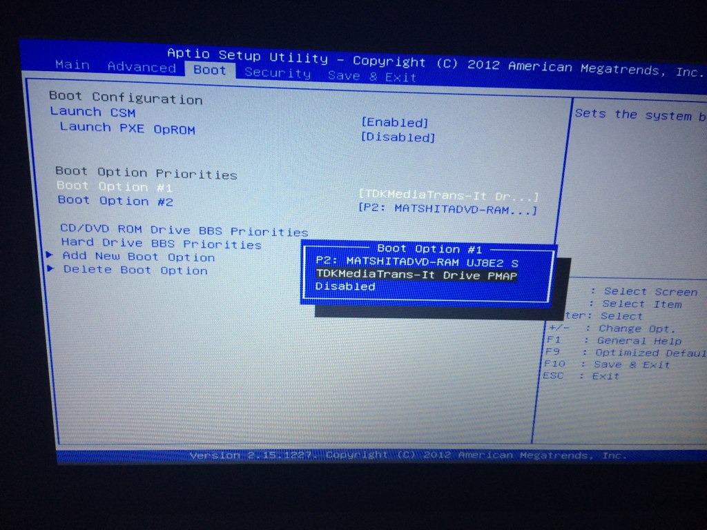

carbo178 Posted April 7, 2014 Share Posted April 7, 2014 Il problema è sicuramente nel bios, devi abilitare il Legacy mode Fai le schermate di tutte le pagine del bios (main, advanced etc) Link to comment https://www.insanelymac.com/forum/topic/296808-mavericks-1092-su-asus-f550c/page/21/#findComment-2010955 Share on other sites More sharing options...
