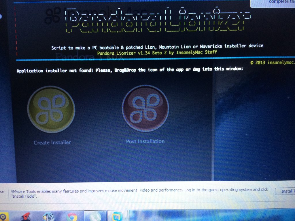

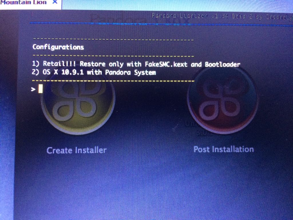

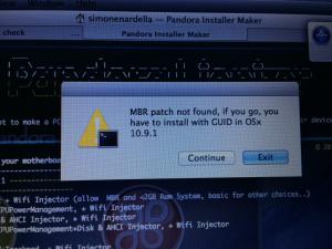

Simone94toro Posted April 5, 2014 Share Posted April 5, 2014 Allora proviamo a fare passo passo! Avvio pandora, poi mi appare questa schermata: cosa scelgo? Link to comment https://www.insanelymac.com/forum/topic/296808-mavericks-1092-su-asus-f550c/page/16/#findComment-2010339 Share on other sites More sharing options...
carbo178 Posted April 5, 2014 Share Posted April 5, 2014 3 Link to comment https://www.insanelymac.com/forum/topic/296808-mavericks-1092-su-asus-f550c/page/16/#findComment-2010340 Share on other sites More sharing options...

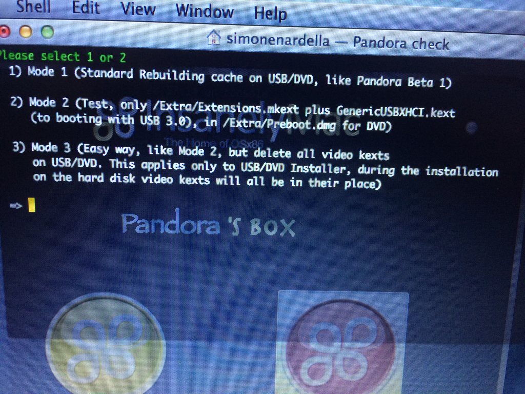

Simone94toro Posted April 5, 2014 Share Posted April 5, 2014 Lo sto facendo con te in modo tale che nn sbaglio nulla! Ora invece cosa scelgo? Link to comment https://www.insanelymac.com/forum/topic/296808-mavericks-1092-su-asus-f550c/page/16/#findComment-2010341 Share on other sites More sharing options...
carbo178 Posted April 5, 2014 Share Posted April 5, 2014 N Link to comment https://www.insanelymac.com/forum/topic/296808-mavericks-1092-su-asus-f550c/page/16/#findComment-2010342 Share on other sites More sharing options...

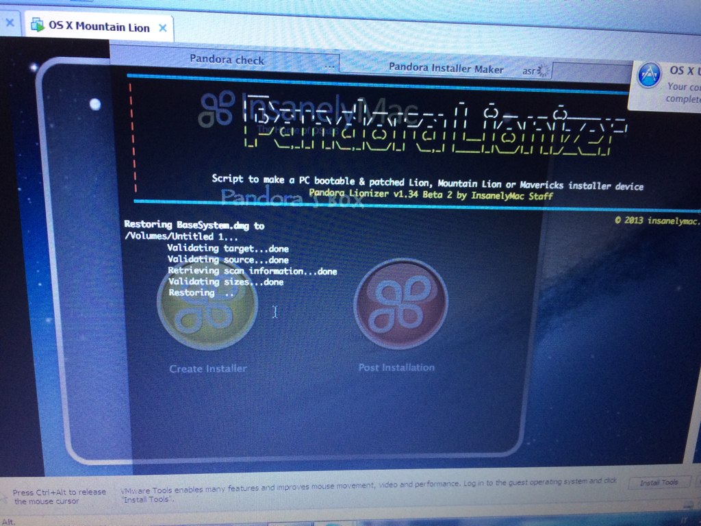

Simone94toro Posted April 5, 2014 Share Posted April 5, 2014 Mi dice che non trova mavericks e quindi io prendo l'app che ho in applicazioni e la trascino nella finestra! Sbaglio? Link to comment https://www.insanelymac.com/forum/topic/296808-mavericks-1092-su-asus-f550c/page/16/#findComment-2010345 Share on other sites More sharing options...
carbo178 Posted April 5, 2014 Share Posted April 5, 2014 Va bene, anche se è meglio avere Pandora e Mavericks nello stesso posto (ad esempio entrambi sul desktop o in applicazioni) Link to comment https://www.insanelymac.com/forum/topic/296808-mavericks-1092-su-asus-f550c/page/16/#findComment-2010346 Share on other sites More sharing options...
Simone94toro Posted April 5, 2014 Share Posted April 5, 2014 Ok ora sta estraendo e scrivendo i file sulla penna! Link to comment https://www.insanelymac.com/forum/topic/296808-mavericks-1092-su-asus-f550c/page/16/#findComment-2010347 Share on other sites More sharing options...
carbo178 Posted April 5, 2014 Share Posted April 5, 2014 Bene, poi ti chiederà smbios (MacBookPro 6,2), risoluzione (quella del monitor) Link to comment https://www.insanelymac.com/forum/topic/296808-mavericks-1092-su-asus-f550c/page/16/#findComment-2010349 Share on other sites More sharing options...

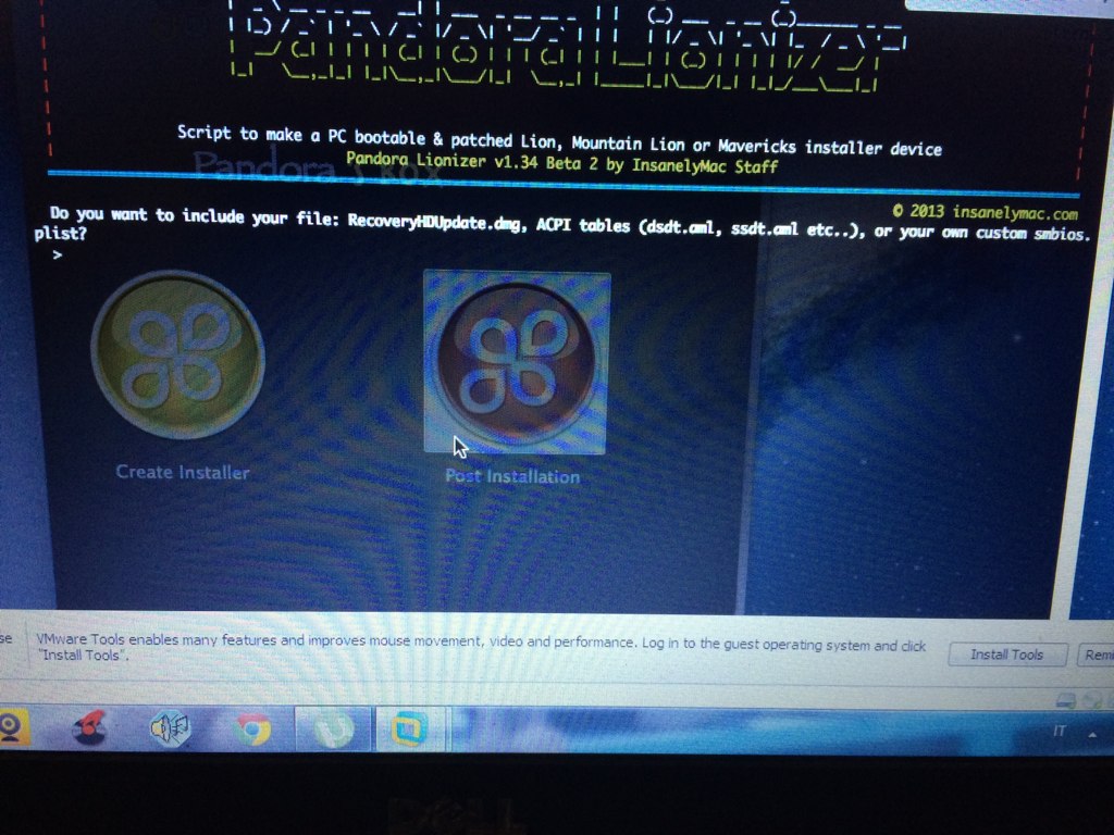

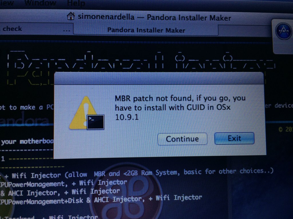

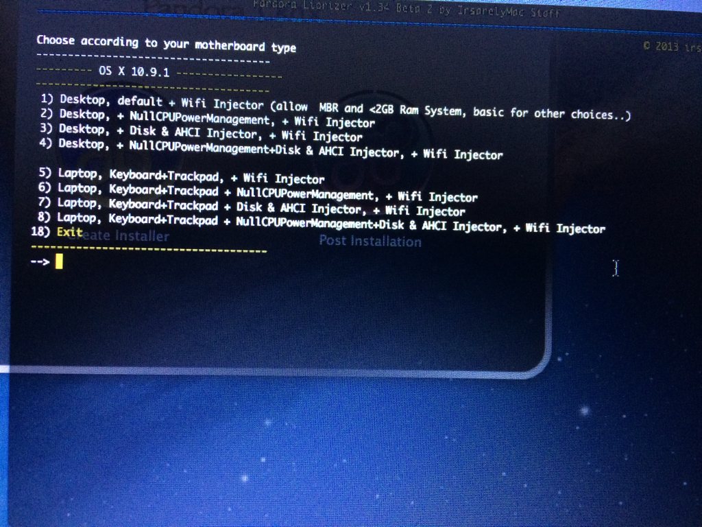

Simone94toro Posted April 5, 2014 Share Posted April 5, 2014 Appena ci arrivo posto! Scelto mbp 6,2 e risoluzione 1366x768 e arrivo qui! Cosa scelgo? Link to comment https://www.insanelymac.com/forum/topic/296808-mavericks-1092-su-asus-f550c/page/16/#findComment-2010350 Share on other sites More sharing options...
carbo178 Posted April 5, 2014 Share Posted April 5, 2014 2 Link to comment https://www.insanelymac.com/forum/topic/296808-mavericks-1092-su-asus-f550c/page/16/#findComment-2010355 Share on other sites More sharing options...

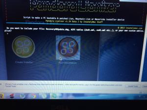

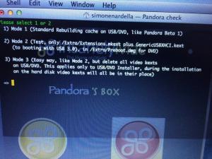

Simone94toro Posted April 5, 2014 Share Posted April 5, 2014 Ok ora invece? Link to comment https://www.insanelymac.com/forum/topic/296808-mavericks-1092-su-asus-f550c/page/16/#findComment-2010356 Share on other sites More sharing options...
carbo178 Posted April 5, 2014 Share Posted April 5, 2014 6 oppure 8, a te la scelta Link to comment https://www.insanelymac.com/forum/topic/296808-mavericks-1092-su-asus-f550c/page/16/#findComment-2010357 Share on other sites More sharing options...
Simone94toro Posted April 5, 2014 Share Posted April 5, 2014 Cosa cambia? Link to comment https://www.insanelymac.com/forum/topic/296808-mavericks-1092-su-asus-f550c/page/16/#findComment-2010358 Share on other sites More sharing options...
carbo178 Posted April 5, 2014 Share Posted April 5, 2014 Poco, solo l'iniezione per i dischi Link to comment https://www.insanelymac.com/forum/topic/296808-mavericks-1092-su-asus-f550c/page/16/#findComment-2010360 Share on other sites More sharing options...

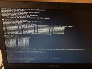

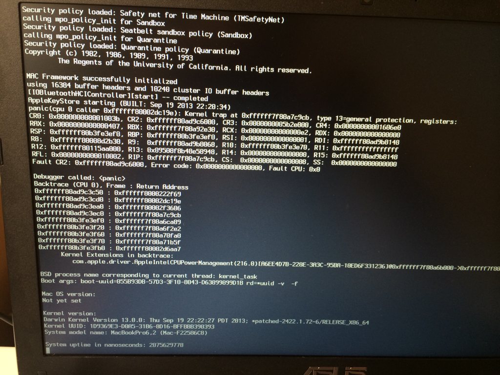

Simone94toro Posted April 5, 2014 Share Posted April 5, 2014 Premetto che la chiavetta prima di usare pandora, l'ho partizionata da disk utility scegliendo MASTER BOOT RECORD e poi mac os extended (journaled) Comunque ho scelto 8 Comunque scegliendo 8 è uscito questo errore! Ragazzi ho avviato senza flags e questo è il risultato! Si è avviato (credo) ma non si muove il touchpad devo inserire un mouse esterno? Funzionerebbe in tal caso? Link to comment https://www.insanelymac.com/forum/topic/296808-mavericks-1092-su-asus-f550c/page/16/#findComment-2010361 Share on other sites More sharing options...
alfieroalfieri Posted April 5, 2014 Author Share Posted April 5, 2014 Certo! Mouse usb! Sei quasi a dama! Link to comment https://www.insanelymac.com/forum/topic/296808-mavericks-1092-su-asus-f550c/page/16/#findComment-2010372 Share on other sites More sharing options...

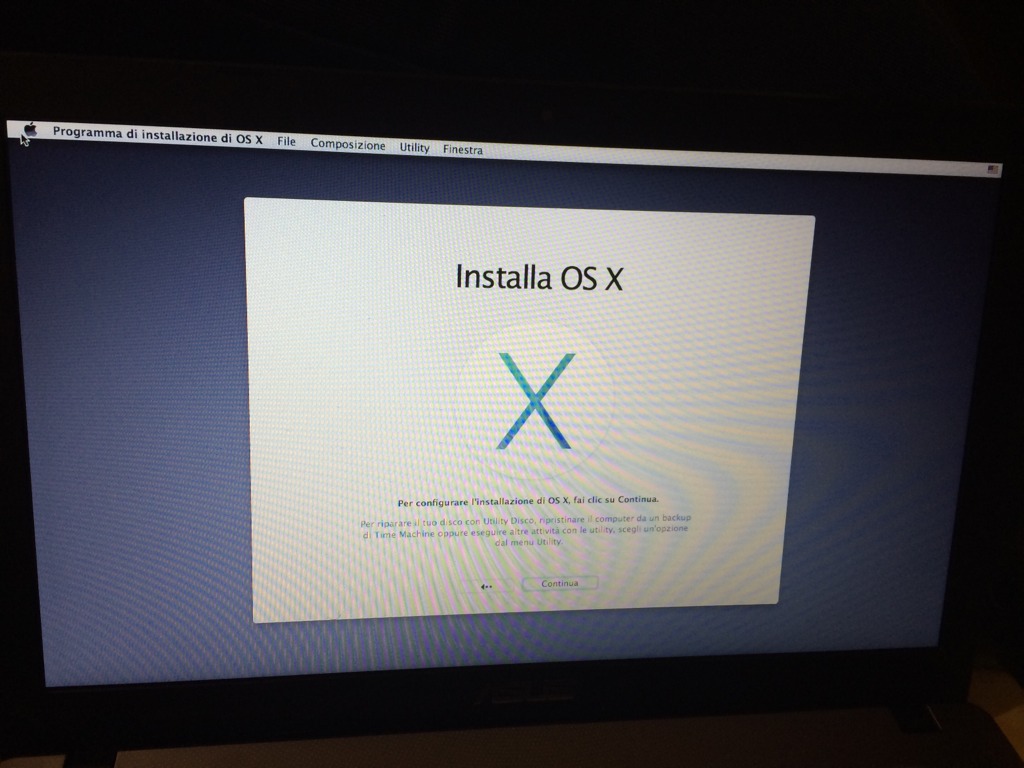

Simone94toro Posted April 6, 2014 Share Posted April 6, 2014 Buongiorno ragazzi! Finalmente sono riuscito ad installare! Ora arrivati al desktop come si procede? Link to comment https://www.insanelymac.com/forum/topic/296808-mavericks-1092-su-asus-f550c/page/16/#findComment-2010454 Share on other sites More sharing options...
carbo178 Posted April 6, 2014 Share Posted April 6, 2014 Bravo simone, ora devi installare il bootloader ed estrarre il DSDT Link to comment https://www.insanelymac.com/forum/topic/296808-mavericks-1092-su-asus-f550c/page/16/#findComment-2010455 Share on other sites More sharing options...

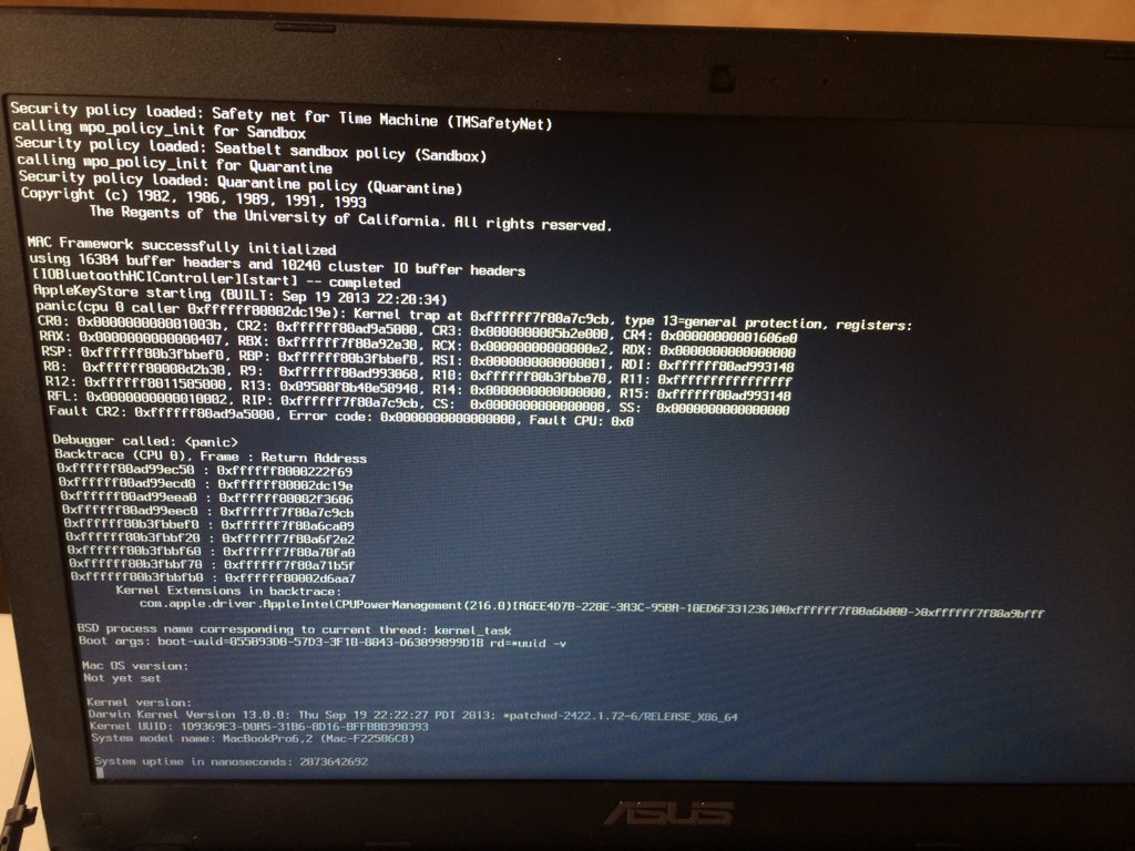

Simone94toro Posted April 6, 2014 Share Posted April 6, 2014 Un momento un momento xk sto riscontrando un problema momentaneo! Allora: terminata l'istallazione mi chiede di riavviare, riavvio e poi anzi che scegliere la chivina di pandora scelgo l'hd dove ho installato ma esce questo! Che significa? Link to comment https://www.insanelymac.com/forum/topic/296808-mavericks-1092-su-asus-f550c/page/16/#findComment-2010457 Share on other sites More sharing options...
carbo178 Posted April 6, 2014 Share Posted April 6, 2014 Significa che non ci sono NullCPU e FakeSMC sull'hard disk, quindi crea una cartella in Extra e chiamala Extensions; all'interno metti NullCPUPowerManagement.kext e FakeSMC.kext Avvia da usb scegli l'hard disk e digita -f Archivio.zip Link to comment https://www.insanelymac.com/forum/topic/296808-mavericks-1092-su-asus-f550c/page/16/#findComment-2010460 Share on other sites More sharing options...
