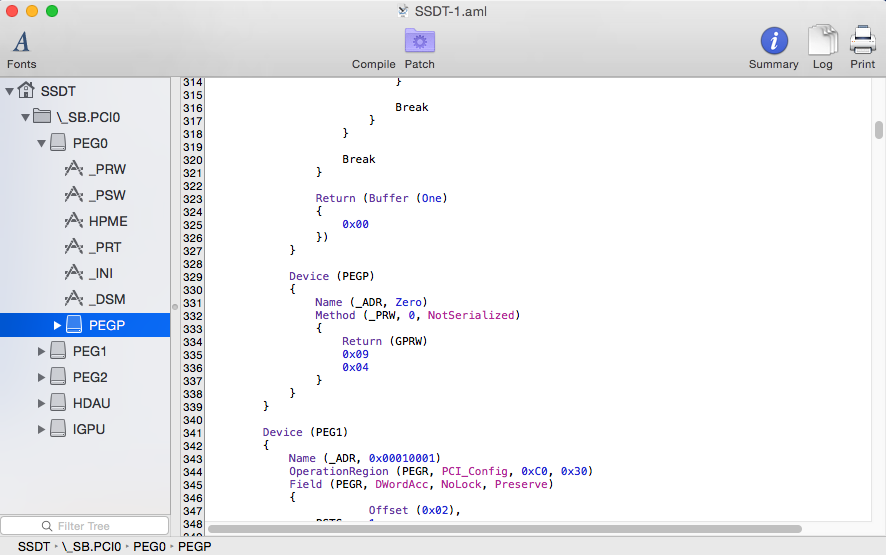

tyufhl Posted October 20, 2014 Share Posted October 20, 2014 I tried the config.plist with no improvement, sadly. When waking from sleep as a MacBookAir6,2 the computer rebooted, and from iMac14,2 the display did not wake up, but the computer made the usual wake noise. Do you know how I can learn more about this? Is it possible to do on-the-fly in Clover? slemblod, now check. You can view the report DarwinDumper? P.S. in your config.plist is DropOem= Yes . Need DropOem=No. In SSDT there is a section responsible for video PEGP . You this SSDT not read. Perhaps because of this? config.plist.zip 1 Link to comment https://www.insanelymac.com/forum/topic/295587-power-management-for-sandyivy-bridgehaswell-cpus/page/8/#findComment-2072232 Share on other sites More sharing options...

slemblod Posted October 27, 2014 Share Posted October 27, 2014 slemblod, now check. You can view the report DarwinDumper? P.S. in your config.plist is DropOem= Yes . Need DropOem=No. In SSDT there is a section responsible for video PEGP. You this SSDT not read. Perhaps because of this? I tried 3 things: Used your attached .plist. Computer wake (using only the mouse!) but no display. Used your attached .plist but removed the SMBIOS section entirely. Same as above. Used your attached .plist but changed SMBIOS to MacBookAir6,2. Same as above. I am really running out of ideas here. Link to comment https://www.insanelymac.com/forum/topic/295587-power-management-for-sandyivy-bridgehaswell-cpus/page/8/#findComment-2076831 Share on other sites More sharing options...

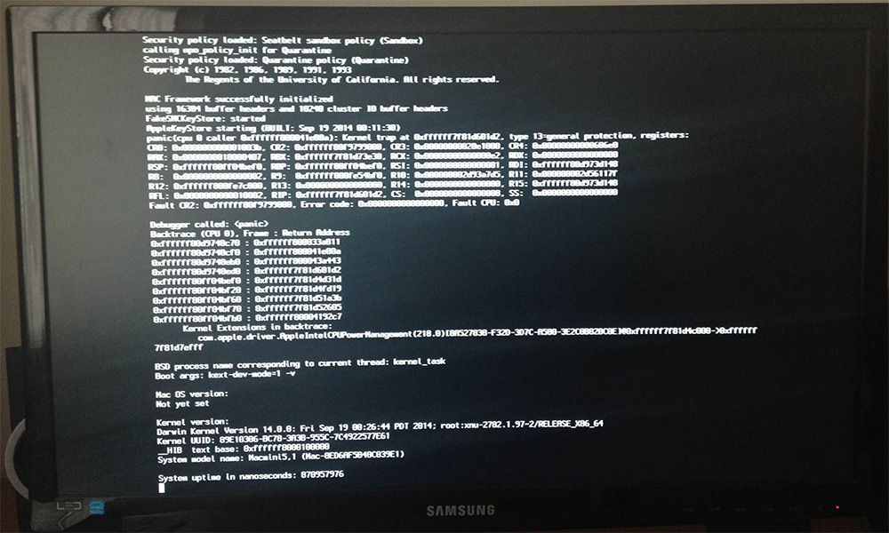

chriz74 Posted November 6, 2014 Share Posted November 6, 2014 I tried this tutorial to get rid of NULLCPUPM. I have an ASUS P8H67-V with an i7 2600k cpu. My smbios is set to Mac mini 5,1 and I use chimera 4.01 bootlader. I am using HD3000 internal gpu as graphic card. The script generates an ssdt.aml however I get a warning while generating: Warning: 'cpu-type' may be set improperly (0x0703 instead of 0x0603) Anyway I moved the ssdt.aml to EXTRA and added these keys to chameleon.plist I don't get the rename ssdt_pr part (rename what for? ) <key>DropSSDT</key> <string>Yes</string> <key>GenerateCStates</key> <string>No</string> <key>GeneratePStates</key> <string>No</string> I removed NullCPUPowerManagement.kext for extensions. I patched AppleIntelCPUPowermanagement result: kernel panic Link to comment https://www.insanelymac.com/forum/topic/295587-power-management-for-sandyivy-bridgehaswell-cpus/page/8/#findComment-2081966 Share on other sites More sharing options...
Pimentel Posted November 7, 2014 Author Share Posted November 7, 2014 Hello did you run these commands line by line? curl -o ~/ssdtPRGen.sh https://raw.githubusercontent.com/Piker-Alpha/ssdtPRGen.sh/master/ssdtPRGen.sh chmod +x ssdtPRGen.sh ./ssdtPRGen.sh Anyway, set your SMBios for iMac 12,1/12,2 or MacPro 3,1 I don't get the rename ssdt_pr part (rename what for? ) Yes, rename for SSDT.aml Link to comment https://www.insanelymac.com/forum/topic/295587-power-management-for-sandyivy-bridgehaswell-cpus/page/8/#findComment-2082194 Share on other sites More sharing options...
