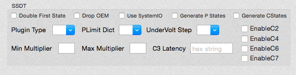

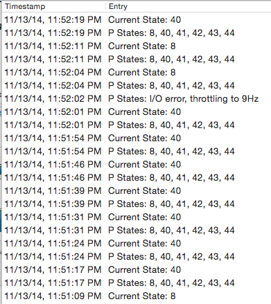

Jared Taskin Posted November 14, 2014 Share Posted November 14, 2014 Thanks for your hard work PimentelX86. I'm on Yosemite, with Clover Bootloader, and a Haswell i7 4790K. Before I did your guide, I was getting three p-states: 8, 40, 44. After doing your guide, I now have 6 but they are: 8, 40, 41, 42, 43, 44. This is better than before but still not really correct right? I also occasionally get throttling errors. Are those normal? I'm using Clover Configurator. Do any of these things need to be checked? Sorry if I haven't given the enough details. Thanks! Link to comment https://www.insanelymac.com/forum/topic/295587-power-management-for-sandyivy-bridgehaswell-cpus/page/9/#findComment-2085036 Share on other sites More sharing options...
chriz74 Posted November 14, 2014 Share Posted November 14, 2014 Hello You have Sandy Bridger you CPU need AICPUPM to work... XCPM is only for Ivy and Haswell... forget XCPM You need make a SSDT+Patch AICPUPM to get power management only this I don't know. While it's true that XCPM doesn't work with sandy bridge it's also true that Yosemite is not using AICPUPM anymore. Infact I deleted these kexts: ACPI_SMC_PlatformPlugin.kext AppleIntelCPUPowerManagement.kext AppleIntelCPUPowerManagementClient.kext AppleSMBusPCI.kext NullCPUPowerManagement.kext and the system is loading normally, I don't get strange errors in log about aicpupm timed out (as I don't have it at all). Yosemite power management is at kernel level no matter what. Please check this post by pike regarding XNU. https://pikeralpha.wordpress.com/2013/10/05/xnu-cpu-power-management/ by the way now I moved to clover uefi. Clover recognizes the CPU and turbo states and all, yet I think it's not going over p-state 34. Link to comment https://www.insanelymac.com/forum/topic/295587-power-management-for-sandyivy-bridgehaswell-cpus/page/9/#findComment-2085062 Share on other sites More sharing options...
Allan Posted November 14, 2014 Share Posted November 14, 2014 Thanks for your hard work PimentelX86. I'm on Yosemite, with Clover Bootloader, and a Haswell i7 4790K. Before I did your guide, I was getting three p-states: 8, 40, 44. After doing your guide, I now have 6 but they are: 8, 40, 41, 42, 43, 44. This is better than before but still not really correct right? I also occasionally get throttling errors. Are those normal? I'm using Clover Configurator. Do any of these things need to be checked? Sorry if I haven't given the enough details. Thanks! Clover are generate P and C states for you automatically, check your config.plist I don't know. While it's true that XCPM doesn't work with sandy bridge it's also true that Yosemite is not using AICPUPM anymore. Infact I deleted these kexts: ACPI_SMC_PlatformPlugin.kext AppleIntelCPUPowerManagement.kext AppleIntelCPUPowerManagementClient.kext AppleSMBusPCI.kext NullCPUPowerManagement.kext and the system is loading normally, I don't get strange errors in log about aicpupm timed out (as I don't have it at all). Yosemite power management is at kernel level no matter what. Please check this post by pike regarding XNU. https://pikeralpha.wordpress.com/2013/10/05/xnu-cpu-power-management/ by the way now I moved to clover uefi. Clover recognizes the CPU and turbo states and all, yet I think it's not going over p-state 34. Yes XNU is used automatically since 10.9.2, but is not necessary you deleted this kexts. Run this commands in Terminal and put the result here: cat /var/log/system.log | grep 'IOPPF:' and sudo dmesg Link to comment https://www.insanelymac.com/forum/topic/295587-power-management-for-sandyivy-bridgehaswell-cpus/page/9/#findComment-2085209 Share on other sites More sharing options...
chriz74 Posted November 14, 2014 Share Posted November 14, 2014 Clover are generate P and C states for you automatically, check your config.plist Yes XNU is used automatically since 10.9.2, but is not necessary you deleted this kexts. Run this commands in Terminal and put the result here: cat /var/log/system.log | grep 'IOPPF:' and sudo dmesg here you go HCI/SPT1@1/IOAHCIDevice@0/AppleAHCIDiskDriver/IOAHCIBlockStorageDevice/IOBlockStorageDriver/Samsung SSD 840 EVO 120GB Media/IOGUIDPartitionScheme/OSX@2 BSD root: disk0s2, major 1, minor 4 hfs: mounted OSX on device root_device USBF: 1.120 GenericUSBXHCI::CreateRootHubDevice Bus 14 already taken VM Swap Subsystem is ON FireWire (OHCI) VendorID 1106 ID 3044 PCI now active, GUID 2000000003002e32; max speed s400. USBMSC Identifier (non-unique): 00000000000006 0x48d 0x1336 0x100, 2 USBMSC Identifier (non-unique): 575839314134315332313333 0x1058 0x730 0x1016, 3 IOGraphics flags 0x43 Apple16X50ACPI1: Identified Serial Port on ACPI Device=UAR1 Previous shutdown cause: 5 **** [iOBluetoothHostControllerUSBTransport][start] -- completed -- result = TRUE -- 0xd000 **** com_intel_driver_EnergyDriver[0xffffff80171fde00]::start(0xffffff8014b1ab00) DSMOS has arrived [iOBluetoothHCIController][staticBluetoothTransportShowsUp] -- Received Bluetooth Controller register service notification -- 0xd000 [iOBluetoothHCIController][start] -- completed Sound assertion in AppleHDACodecGeneric at line 366 Apple16X50UARTSync1: Detected 16550AF/C/CF FIFO=16 MaxBaud=115200 IONetworkController::enable [iOBluetoothHCIController::setConfigState] calling registerService **** [iOBluetoothHCIController][ProcessBluetoothTransportShowsUpActionWL] -- Connected to the transport successfully -- 0xea00 -- 0x8800 -- 0xd000 **** NTFS driver 3.12 [Flags: R/W]. NTFS volume name , version 3.1. NTFS volume name , version 3.1.NTFS volume name , version 3.1. NTFS-fs warning (device /dev/disk1s4, pid 132): ntfs_system_inodes_get(): Windows is hibernated. Will not be able to remount read-write. Run chkdsk. NTFS volume name , version 3.1. NTFS volume name My Passport, version 3.1. AppleKeyStore:Sending lock change 0 for handle -501 NTFS volume name My Passport, version 3.1. BUG in process suhelperd[372]: over-released legacy external boost assertions (1 total, 1 external, 0 legacy-external) <--- this last line is repeated like 100 times then I reinstalled those kext and I got a faster boot (much more fast). And here is the dmesg: Scheme/OSX@2 BSD root: disk0s2, major 1, minor 4 hfs: mounted OSX on device root_device USBF: 1.118 GenericUSBXHCI::CreateRootHubDevice Bus 14 already taken VM Swap Subsystem is ON FireWire (OHCI) VendorID 1106 ID 3044 PCI now active, GUID 2000000003002e32; max speed s400. USBMSC Identifier (non-unique): 00000000000006 0x48d 0x1336 0x100, 2 USBMSC Identifier (non-unique): 575839314134315332313333 0x1058 0x730 0x1016, 3 Apple16X50ACPI1: Identified Serial Port on ACPI Device=UAR1 IOGraphics flags 0x43 Previous shutdown cause: 5 **** [iOBluetoothHostControllerUSBTransport][start] -- completed -- result = TRUE -- 0x9000 **** com_intel_driver_EnergyDriver[0xffffff801744ad00]::start(0xffffff8014b92b00) DSMOS has arrived [iOBluetoothHCIController][staticBluetoothTransportShowsUp] -- Received Bluetooth Controller register service notification -- 0x9000 [iOBluetoothHCIController][start] -- completed Apple16X50UARTSync1: Detected 16550AF/C/CF FIFO=16 MaxBaud=115200 Sound assertion in AppleHDACodecGeneric at line 366 [iOBluetoothHCIController::setConfigState] calling registerService **** [iOBluetoothHCIController][ProcessBluetoothTransportShowsUpActionWL] -- Connected to the transport successfully -- 0xd580 -- 0xf800 -- 0x9000 **** IONetworkController::enable ACPI_SMC_PlatformPlugin::start - waitForService(resourceMatching(AppleIntelCPUPowerManagement) timed out [AGPM Controller] unknownPlatform NTFS driver 3.12 [Flags: R/W]. NTFS volume name , version 3.1. NTFS volume name , version 3.1. NTFS-fs warning (device /dev/disk1s4, pid 132): ntfs_system_inodes_get(): Windows is hibernated. Will not be able to remount read-write. Run chkdsk. NTFS volume name , version 3.1. NTFS volume name , version 3.1. NTFS volume name My Passport, version 3.1. AppleKeyStore:Sending lock change 0 for handle -501 NTFS volume name My Passport, version 3.1. Link to comment https://www.insanelymac.com/forum/topic/295587-power-management-for-sandyivy-bridgehaswell-cpus/page/9/#findComment-2085284 Share on other sites More sharing options...
