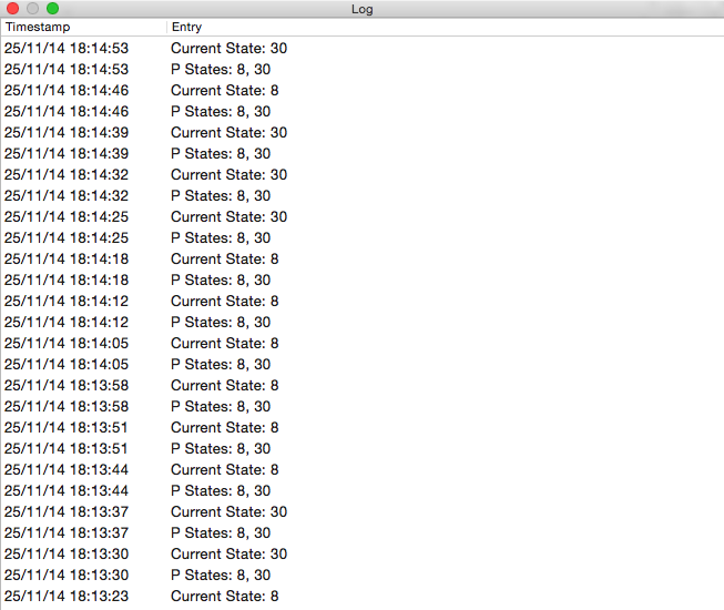

UltraLaser Posted November 25, 2014 Share Posted November 25, 2014 @Allan, You're my last hope Thank you so much for this BIG "How to" but I have problems with speed step. My speed step are locked only in "8 30". Can You look my config and clover directory? Thank You so match! Clover Boot log : 0:100 0:100 MemLog inited, TSC freq: 3005216162 0:100 0:000 0:100 0:000 Now is 25.11.2014, 17:9:5 (GMT+2047) 0:100 0:000 Starting Clover rev 3021 on American Megatrends EFI 0:100 0:000 SelfDevicePath=PciRoot(0x0)\Pci(0x1F,0x2)\Sata(0x0,0xFFFF,0x0)\HD(1,GPT,2439F926-92AC-4BFA-9A90-A8FAFD728FEF,0x28,0x64000) @B1282118 0:100 0:000 SelfDirPath = \EFI\BOOT 0:100 0:000 Total Memory Slots Count = 2 0:100 0:000 Type 17 Index = 0 0:100 0:000 SmbiosTable.Type17->Speed = 1600MHz 0:100 0:000 SmbiosTable.Type17->Size = 4096MB 0:100 0:000 SmbiosTable.Type17->Bank/Device = BANK 0 DIMM_A1 0:100 0:000 Type 17 Index = 1 0:100 0:000 SmbiosTable.Type17->Speed = 1600MHz 0:100 0:000 SmbiosTable.Type17->Size = 4096MB 0:100 0:000 SmbiosTable.Type17->Bank/Device = BANK 2 DIMM_B1 0:100 0:000 Boot status=0 0:100 0:000 Clover revision: 3021 running on All Series 0:100 0:000 ... with board Z97I-PLUS 0:100 0:000 Clover load options size = 4 bytes 0:100 0:000 Found Plist String = , parse XML in LoadOptions 0:100 0:000 Xml in load options is bad 0:106 0:006 Using OEM config.plist at path: EFI\CLOVER\config.plist 0:107 0:000 EFI\CLOVER\config.plist loaded: Success 0:109 0:002 Found theme applestyle 0:112 0:003 Found theme christmas 0:114 0:002 Found theme NEWYEAR 0:116 0:002 Loading early settings 0:116 0:000 timeout set to 5 0:116 0:000 Custom boot CUSTOM_BOOT_DISABLED (0x0) 0:116 0:000 KextsToPatch: 3 requested 0:116 0:000 KextToPatch 0: IOBluetoothFamily (HandOff Fix) Kext bin patch, data len: 6 0:116 0:000 KextToPatch 1: AppleAHCIPort (External icons patch) Kext bin patch, data len: 8 0:116 0:000 KextToPatch 2: IOAHCIBlockStorage (Trim Patch) Kext bin patch, data len: 11 0:116 0:000 Default theme: applestyle 0:116 0:000 Hiding entries with string BOOTX64.EFI 0:116 0:000 Hiding entries with string just_data 0:116 0:000 Hiding entries with string mac_data 0:116 0:000 Hiding entries with string sys_8 0:116 0:000 Hiding entries with string Windows 0:116 0:000 LoadDrivers() start 0:118 0:002 Loading EmuVariableUefi-64.efi 0:119 0:001 load image status=Success 0:119 0:000 EmuVariableUefi Initialize: VariableCommonInitialize = Success, orig services stored, install gEmuVariableControlProtocolGuid = Success 0:119 0:000 Loading FSInject-64.efi 0:120 0:000 load image status=Success 0:120 0:000 Loading HFSPlus-64.efi 0:120 0:000 load image status=Success 0:120 0:000 - driver needs connecting 0:120 0:000 Loading OsxAptioFix2Drv-64.efi 0:122 0:001 load image status=Success 0:122 0:000 Loading OsxFatBinaryDrv-64.efi 0:123 0:001 load image status=Success 0:123 0:000 1 drivers needs connecting ... 0:123 0:000 PlatformDriverOverrideProtocol->GetDriver overriden 0:123 0:000 Searching for invalid DiskIo BY_DRIVER connects: not found, all ok 0:231 0:108 LoadDrivers() end 0:231 0:000 EmuVariable InstallEmulation: orig vars copied, emu.var.services installed, CreateEvent VirtualAddressChange = Success, CreateEvent ExitBootServices = Success, set Status=Success 0:238 0:006 SetScreenResolution: 1920x1080 - already set 0:238 0:000 Console modes reported: 4, available modes: 0:238 0:000 Mode 1: 80x25 (current mode) 0:238 0:000 Mode 2: 80x50 0:238 0:000 Mode 3: 100x31 0:238 0:000 Mode 4: 120x28 0:238 0:000 reinit: self device path=PciRoot(0x0)\Pci(0x1F,0x2)\Sata(0x0,0xFFFF,0x0)\HD(1,GPT,2439F926-92AC-4BFA-9A90-A8FAFD728FEF,0x28,0x64000) 0:238 0:000 CPU Vendor = 756E6547 Model=306C3 0:238 0:000 The CPU not supported turbo 0:238 0:000 BrandString = Intel® Core i3-4330T CPU @ 3.00GHz 0:238 0:000 MSR 0xE2 before patch 1E000400 0:238 0:000 MSR 0xE4 00021814 0:238 0:000 MSR 0xCE 00080838_F3011E00 0:238 0:000 non-usable FLEX_RATIO = 11E00 0:238 0:000 MSR 0x1B0 00000000 0:238 0:000 FSBFrequency=100MHz DMIvalue=100000kHz 0:238 0:000 Corrected FSBFrequency=100MHz 0:238 0:000 Vendor/Model/Stepping: 0x756E6547/0x3C/0x3 0:238 0:000 Family/ExtFamily: 0x6/0x0 0:238 0:000 MaxDiv/MinDiv: 30.0/8 0:238 0:000 Turbo: 30/30/30/30 0:238 0:000 Features: 0xBFEBFBFF 0:238 0:000 Threads: 4 0:238 0:000 Cores: 2 0:238 0:000 FSB: 100 MHz 0:238 0:000 CPU: 3000 MHz 0:238 0:000 TSC: 3000 MHz 0:238 0:000 PIS: 400 MHz 0:238 0:000 PCI (00|00:00.00) : 8086 0C00 class=060000 0:238 0:000 PCI (00|00:01.00) : 8086 0C01 class=060400 0:238 0:000 PCI (00|00:02.00) : 8086 0412 class=030000 0:238 0:000 Found GFX model=Intel HD Graphics 4600 0:238 0:000 PCI (00|00:03.00) : 8086 0C0C class=040300 0:238 0:000 PCI (00|00:14.00) : 8086 8CB1 class=0C0330 0:238 0:000 PCI (00|00:16.00) : 8086 8CBA class=078000 0:238 0:000 PCI (00|00:16.01) : FFFF FFFF class=FFFFFF 0:238 0:000 PCI (00|00:19.00) : 8086 15A1 class=020000 0:238 0:000 PCI (00|00:1A.00) : 8086 8CAD class=0C0320 0:238 0:000 PCI (00|00:1B.00) : 8086 8CA0 class=040300 0:238 0:000 PCI (00|00:1C.00) : 8086 8C90 class=060400 0:238 0:000 PCI (00|00:1C.03) : 8086 8C96 class=060400 0:238 0:000 PCI (00|03:00.00) : 14E4 43B1 class=028000 0:238 0:000 PCI (00|00:1D.00) : 8086 8CA6 class=0C0320 0:238 0:000 PCI (00|00:1F.00) : 8086 8CC4 class=060100 0:238 0:000 PCI (00|00:1F.02) : 8086 8C82 class=010601 0:238 0:000 PCI (00|00:1F.03) : 8086 8CA2 class=0C0500 0:238 0:000 ScanSPD() start 0:238 0:000 SMBus CmdReg: 0x3 0:238 0:000 Scanning SMBus [8086:8CA2], mmio: 0xF7F38004, ioport: 0xF040, hostc: 0x11 0:253 0:014 SPD[0]: Type 11 @0x50 0:261 0:008 Found module with XMP version 1.3XMP Profile1: 10*1/8ns 0:261 0:000 Using XMP Profile1 instead of standard frequency 1600MHz 0:261 0:000 DDR speed 1600MHz 0:261 0:000 Slot: 0 Type 24 4096MB 1600MHz Vendor=Kingston PartNo=KHX1600C9D34GX SerialNo=060D02090109060D 0:282 0:020 SPD[2]: Type 11 @0x52 0:290 0:008 Found module with XMP version 1.3XMP Profile1: 10*1/8ns 0:290 0:000 Using XMP Profile1 instead of standard frequency 1600MHz 0:290 0:000 DDR speed 1600MHz 0:290 0:000 Slot: 2 Type 24 4096MB 1600MHz Vendor=Kingston PartNo=KHX1600C9D34GX SerialNo=07090208040F0807 0:416 0:126 ScanSPD() end 0:416 0:000 Get Acpi Tables List from RSDT: 0:416 0:000 Found table: FACP A M I len=132 0:416 0:000 Found table: APIC A M I len=114 0:416 0:000 Found table: FPDT A M I len=68 0:416 0:000 Found table: SSDT Ther_Rvp len=3197 0:416 0:000 Found table: SSDT Cpu0Ist len=1337 0:416 0:000 Found table: SSDT CpuSsdt len=2932 0:416 0:000 Found table: MCFG A M I len=60 0:416 0:000 Found table: HPET A M I len=56 0:416 0:000 Found table: SSDT SataTabl len=877 0:416 0:000 Found table: SSDT SaSsdt len=22903 0:416 0:000 Found table: BGRT A M I len=56 0:416 0:000 Calibrated TSC frequency =3005216162 =3005MHz 0:416 0:000 Loading main settings 0:416 0:000 USB FixOwnership: true 0:416 0:000 Dropping 2 tables 0:416 0:000 Drop table 0 signature="SSDT" (54445353) table-id="Cpu0Ist" (0074734930757043) 0:416 0:000 set table: 54445353, 74734930757043 to drop: true 0:416 0:000 0:416 0:000 Drop table 1 signature="SSDT" (54445353) table-id="CpuPM" (0000004D50757043) 0:416 0:000 set table: 54445353, 4D50757043 to drop: 0:416 0:000 Config set ChassisType=0xD 0:416 0:000 found 7 volumes with blockIO 0:416 0:000 0. Volume: 0:416 0:000 PciRoot(0x0)\Pci(0x1F,0x2)\Sata(0x0,0xFFFF,0x0) 0:418 0:002 1. Volume: 0:418 0:000 PciRoot(0x0)\Pci(0x1F,0x2)\Sata(0x1,0xFFFF,0x0) 0:421 0:002 Result of bootcode detection: bootable unknown (legacy) 0:421 0:000 2. Volume: 0:421 0:000 PciRoot(0x0)\Pci(0x1F,0x2)\Sata(0x0,0xFFFF,0x0)\HD(1,GPT,2439F926-92AC-4BFA-9A90-A8FAFD728FEF,0x28,0x64000) 0:421 0:000 Result of bootcode detection: bootable unknown (legacy) 0:436 0:015 This is SelfVolume !! 0:436 0:000 3. Volume: 0:436 0:000 PciRoot(0x0)\Pci(0x1F,0x2)\Sata(0x0,0xFFFF,0x0)\HD(2,GPT,40C7675C-AC93-4ECA-AB95-5BDB35E083C2,0x64028,0xDDFAC40) 0:437 0:000 4. Volume: 0:437 0:000 PciRoot(0x0)\Pci(0x1F,0x2)\Sata(0x0,0xFFFF,0x0)\HD(3,GPT,58E54DF0-5975-4748-AFCA-3E298AAD3199,0xDE5EC68,0x135F20) 0:437 0:000 5. Volume: 0:437 0:000 PciRoot(0x0)\Pci(0x1F,0x2)\Sata(0x1,0xFFFF,0x0)\HD(1,MBR,0x7197BA25,0x800,0xAF000) 0:438 0:000 Result of bootcode detection: bootable Windows (vista,win) 0:438 0:000 6. Volume: 0:438 0:000 PciRoot(0x0)\Pci(0x1F,0x2)\Sata(0x1,0xFFFF,0x0)\HD(2,MBR,0x7197BA25,0xAF800,0xDEE4800) 0:438 0:000 Result of bootcode detection: bootable Windows (vista,win) 0:443 0:004 Loading nvram.plist from Vol 'Yosemite' - loaded, size=827 0:445 0:002 PutNvramPlistToRtVars ... 0:445 0:000 Adding Key: EFIBluetoothDelay: Data: Size = 2: Success 0:445 0:000 Skipping EmuVariableUefiPresent 0:445 0:000 Adding Key: LocationServicesEnabled: Data: Size = 1: Success 0:445 0:000 Adding Key: MyVar: Data: Size = 9: Success 0:445 0:000 Adding Key: SystemAudioVolume: Data: Size = 1: Success 0:445 0:000 Adding Key: SystemAudioVolumeDB: Data: Size = 1: Success 0:445 0:000 Adding Key: bluetoothActiveControllerInfo: Data: Size = 16: Success 0:445 0:000 Adding Key: boot-args: String: Size = 15, Val = 'kext-dev-mode=1': Success 0:445 0:000 Adding Key: fmm-computer-name: Data: Size = 14: Success 0:445 0:000 Adding Key: prev-lang:kbd: Data: Size = 4: Success 0:445 0:000 Adding Key: security-mode: String: Size = 4, Val = 'none': Success 0:446 0:001 Using theme 'applestyle' (EFI\CLOVER\themes\applestyle) 0:452 0:005 font PTMono_10W.png loaded from themedir 0:452 0:000 Choosing theme applestyle 0:452 0:000 found boot-args in NVRAM:kext-dev-mode=1, size=15 0:452 0:000 ...found arg:kext-dev-mode=1 0:452 0:000 Custom entries start 0:452 0:000 Custom entries finish 0:452 0:000 Scanning loaders... 0:452 0:000 0: 'Whole Disc Boot' no file system 0:452 0:000 1: 'Whole Disc Boot' no file system 0:452 0:000 2: 'EFI' 0:478 0:026 AddLoaderEntry for Volume Name=EFI 0:478 0:000 hiding entry: \EFI\BOOT\BOOTX64.efi 0:478 0:000 3: 'Yosemite' 0:482 0:004 AddLoaderEntry for Volume Name=Yosemite 0:484 0:002 Check if volume Is Hibernated: 0:484 0:000 Check sleep image 'by signature': 0:496 0:011 read prefs \Library\Preferences\SystemConfiguration\com.apple.PowerManagement.plist status=Success 0:496 0:000 SleepImage name from pref: ImageVolume = 'Yosemite', ImageName = '\private\var\vm\sleepimage' 0:498 0:002 Reading first 512 bytes of sleepimage ... 0:501 0:003 OurBlockIoRead: Lba=3924990, Offset=724932000 (BlockSize=512) 0:501 0:000 sig lion: F1E0BE9D 0:501 0:000 sig snow: 0 0:501 0:000 no valid sleep image offset was found 0:501 0:000 Reading completed -> Success 0:501 0:000 sleepimage offset could not be acquired 0:501 0:000 hibernated: no - sign 0:523 0:022 4: 'Recovery HD' 0:526 0:002 AddLoaderEntry for Volume Name=Recovery HD 0:548 0:021 5: 'Riservato per il sistema' 0:566 0:018 6: '' 0:584 0:018 Custom legacy start 0:584 0:000 Custom legacy end 0:584 0:000 Scanning legacy ... 0:584 0:000 0: 'Whole Disc Boot' (legacy) not legacy 0:584 0:000 1: 'Whole Disc Boot' (legacy) not legacy 0:584 0:000 2: 'EFI' (legacy) not legacy 0:584 0:000 3: 'Yosemite' (legacy) not legacy 0:584 0:000 4: 'Recovery HD' (legacy) not legacy 0:584 0:000 5: 'Riservato per il sistema' (vista,win) add legacy 0:587 0:003 added 'Boot Windows from Riservato per il sistema' OSType=2 Icon=vista,win 0:587 0:000 6: '' (vista,win) add legacy 0:589 0:001 added 'Boot Windows from ' OSType=2 Icon=vista,win 0:589 0:000 Custom tool start 0:589 0:000 Custom tool end 0:590 0:001 found tool \EFI\CLOVER\tools\Shell64U.efi 0:590 0:000 Checking EFI partition Volume 2 for Clover 0:591 0:000 Found Clover 0:592 0:000 EmuVariable UninstallEmulation: CloseEvent = Success, original var services restored 0:595 0:003 EmuVariable InstallEmulation: orig vars copied, emu.var.services installed, CreateEvent VirtualAddressChange = Success, CreateEvent ExitBootServices = Success, set Status=Success 0:601 0:006 GetEfiBootDeviceFromNvram: efi-boot-device-data not found 0:601 0:000 EfiBootVolume not found 0:601 0:000 found entry 0. 'Boot Mac OS X from Yosemite', Volume 'Yosemite', DevicePath 'PciRoot(0x0)\Pci(0x1F,0x2)\Sata(0x0,0xFFFF,0x0)\HD(2,GPT,40C7675C-AC93-4ECA-AB95-5BDB35E083C2,0x64028,0xDDFAC40)\System\Library\CoreServices\boot.efi' 0:601 0:000 EmuVariable UninstallEmulation: CloseEvent = Success, original var services restored 0:601 0:000 DefaultIndex=0 and MainMenu.EntryCount=10 1:088 0:486 Found Mouse device: 1:089 0:001 GUI ready 7:093 6:004 StartLoader() start 7:093 0:000 Finally: Bus=100173kHz CPU=3005MHz 7:093 0:000 Kernel and Kext Patches: 7:093 0:000 Allowed: y 7:093 0:000 Debug: n 7:093 0:000 KernelCpu: n 7:093 0:000 Lapic: n 7:093 0:000 AICPUPM: n 7:093 0:000 AppleRTC: y 7:093 0:000 KernelPm: n 7:093 0:000 FakeCPUID: 0x0 7:093 0:000 ATIController: <null string> 7:093 0:000 ATIDataLength: 0 7:093 0:000 0 Kexts to load 7:093 0:000 3 Kexts to patch 7:093 0:000 KextPatch[0]: 6 bytes, IOBluetoothFamily 7:093 0:000 KextPatch[1]: 8 bytes, AppleAHCIPort 7:093 0:000 KextPatch[2]: 11 bytes, IOAHCIBlockStorage 7:093 0:000 Loading boot.efi 7:106 0:012 load image status=Success 7:173 0:067 GetOSVersion: : 10.10.1 7:173 0:000 EmuVariable InstallEmulation: orig vars copied, emu.var.services installed, CreateEvent VirtualAddressChange = Success, CreateEvent ExitBootServices = Success, set Status=Success 7:180 0:006 insert table 9 for dev 19:0 7:180 0:000 insert table 9 for dev 0:0 7:181 0:001 Detected alternating SMBIOS channel banks 7:181 0:000 Channels: 2 7:181 0:000 Interleave: 0 2 1 3 4 6 5 7 8 10 9 11 12 14 13 15 16 18 17 19 20 22 21 23 7:181 0:000 SMBIOS Type 17 Index = 0 => 0 0: 7:181 0:000 BANK0 DIMM0 1600MHz 4096MB 7:181 0:000 mTotalSystemMemory = 4096 7:181 0:000 SMBIOS Type 17 Index = 1 => 1 2: 7:181 0:000 BANK1 DIMM0 1600MHz 4096MB 7:181 0:000 mTotalSystemMemory = 8192 7:181 0:000 SMBIOS Type 17 Index = 2 => 2 1: 7:181 0:000 BANK0 DIMM1 EMPTY 7:181 0:000 SMBIOS Type 17 Index = 3 => 3 3: 7:181 0:000 BANK1 DIMM1 EMPTY 7:181 0:000 NumberOfMemoryDevices = 4 7:182 0:000 Type20[0]->End = 0x3FFFFF, Type17[0] = 0x1000 7:182 0:000 Type20[1]->End = 0x7FFFFF, Type17[1] = 0x3000 7:182 0:000 Table 131 is present, CPUType=10 7:182 0:000 Change to: 905 7:182 0:000 RSDT 0xBCB2E028 7:182 0:000 FADT from RSDT: 0xBCB2E110 7:182 0:000 XSDT 0xBCB2E080 7:182 0:000 FADT from XSDT: 0xBCB3CC70 7:182 0:000 Xsdt reallocation done 7:182 0:000 old FADT length=10C 7:182 0:000 Found OperationRegion(GNVS, SystemMemory, BCD64A98, ...) 7:182 0:000 Found OperationRegion(PNVA, SystemMemory, BCD65D98, ...) 7:182 0:000 Found OperationRegion(RCRB, SystemMemory, 0, ...) 7:182 0:000 Found OperationRegion(XHCP, SystemMemory, 0, ...) 7:182 0:000 Found OperationRegion(MCA1, SystemMemory, 0, ...) 7:182 0:000 Found OperationRegion(PSCA, SystemMemory, 0, ...) 7:182 0:000 Found OperationRegion(MCA1, SystemMemory, 0, ...) 7:182 0:000 Found OperationRegion(RPAC, SystemMemory, 0, ...) 7:182 0:000 Found OperationRegion(EPAC, SystemMemory, 0, ...) 7:182 0:000 Found OperationRegion(CPSB, SystemMemory, BCB27E98, ...) 7:182 0:000 Found OperationRegion(MBAR, SystemMemory, 0, ...) 7:182 0:000 Found OperationRegion(XHCN, SystemMemory, 0, ...) 7:182 0:000 Found OperationRegion(RAMW, SystemMemory, BCD50018, ...) 7:182 0:000 Found OperationRegion(TMMB, SystemMemory, FED40000, ...) 7:182 0:000 Found OperationRegion(RAMX, SystemMemory, BCD65C18, ...) 7:183 0:001 DSDT found in Clover volume OEM folder: EFI\CLOVER\ACPI\patched\DSDT.aml 7:185 0:002 page is allocated, write DSDT into 7:185 0:000 Apply DsdtFixMask=0x00000000 old way 7:185 0:000 drop _DSM mask=0x0000 7:185 0:000 ========= Auto patch DSDT Starting ======== 7:185 0:000 VideoCard devID=0x4128086 7:185 0:000 DisplayADR1[0] = 0x20000, DisplayADR2[0] = 0xFFFE 7:185 0:000 USBADR[0] = 0x140000 and PCIe = 0xFFFE 7:185 0:000 USBADR[1] = 0x1A0000 and PCIe = 0xFFFE 7:295 0:109 Found Airport BCM at 0x1C0003, 0x0 7:295 0:000 USBADR[2] = 0x1D0000 and PCIe = 0xFFFE 7:295 0:000 first CPU found at 89F7 offset 89FA 7:295 0:000 score candidate at 89F3 7:295 0:000 score inserted in acpi_cpu_score _PR_ 7:295 0:000 Found ACPI CPU: CPU0 And CPU1 And CPU2 And CPU3 And CPU4 And CPU5 And CPU6 And CPU7 within the score: _PR_ 7:295 0:000 Found PCIROOTUID = 0 7:295 0:000 ========= Auto patch DSDT Finished ======== 7:295 0:000 Drop tables from Xsdt, SIGN=SSDT TableID=Cpu0Ist Length=1337 7:295 0:000 Xsdt has tables count=11 7:295 0:000 Table: SSDT Cpu0Ist 1337 dropped 7:295 0:000 corrected XSDT length=116 7:295 0:000 Patch table: SSDT Ther_Rvp 7:295 0:000 SSDT len = 0xC7D 7:295 0:000 Patch table: SSDT CpuSsdt 7:295 0:000 SSDT len = 0xB74 7:295 0:000 Patch table: SSDT SataTabl 7:295 0:000 SSDT len = 0x36D 7:295 0:000 Patch table: SSDT SaSsdt 7:295 0:000 SSDT len = 0x5977 7:295 0:000 Drop tables from Xsdt, SIGN=XXXX TableID= Length=0 7:295 0:000 Xsdt has tables count=10 7:295 0:000 corrected XSDT length=116 7:295 0:000 Inserting SSDT.aml from EFI\CLOVER\ACPI\patched ... Success 7:296 0:001 CPUBase=0 and ApicCPUBase=1 ApicCPUNum=4 7:296 0:000 EdidDiscovered size=128 7:296 0:000 00 | 00 FF FF FF FF FF FF 00 04 69 E1 24 01 01 01 01 7:296 0:000 16 | 10 17 01 03 80 35 1E 78 EA 9D E5 A6 54 54 9F 26 7:296 0:000 32 | 0D 50 54 B7 EF 00 71 4F 81 80 81 40 81 C0 81 00 7:296 0:000 48 | 95 00 B3 00 01 01 02 3A 80 18 71 38 2D 40 58 2C 7:296 0:000 64 | 45 00 13 2B 21 00 00 1E 00 00 00 FD 00 32 96 1E 7:296 0:000 80 | A0 21 00 0A 20 20 20 20 20 20 00 00 00 FC 00 56 7:296 0:000 96 | 47 32 34 38 0A 20 20 20 20 20 20 20 00 00 00 FF 7:296 0:000 112 | 00 44 34 4C 4D 51 53 30 35 37 35 35 37 0A 01 FB 7:296 0:000 Intel Intel HD Graphics 4600 [8086:0412] :: PciRoot(0x0)\Pci(0x2,0x0) 7:296 0:000 Intel GFX revision =0x6 7:296 0:000 USB Controller [8086:8CB1] :: PciRoot(0x0)\Pci(0x14,0x0) 7:296 0:000 LAN Controller [8086:15A1] :: PciRoot(0x0)\Pci(0x19,0x0) 7:297 0:000 USB Controller [8086:8CAD] :: PciRoot(0x0)\Pci(0x1A,0x0) 7:297 0:000 USB Controller [8086:8CA6] :: PciRoot(0x0)\Pci(0x1D,0x0) 7:297 0:000 stringlength = 2722 7:297 0:000 CurrentMode: Width=1920 Height=1080 7:297 0:000 FSInjection: using kexts path: 'EFI\CLOVER\kexts\10.10' 7:298 0:001 ** Warning: Your MLB is not suitable for iMessage(must be 17 chars long) ! 7:298 0:000 MSR 0x1B0 set to 00000000 7:298 0:000 Preparing kexts injection for arch=x86_64 from EFI\CLOVER\kexts\10.10 7:304 0:005 Extra kext: EFI\CLOVER\kexts\10.10\AppleIGB.kext 7:312 0:008 Extra kext: EFI\CLOVER\kexts\10.10\bcm4352.kext 7:314 0:002 Extra kext: EFI\CLOVER\kexts\10.10\BTFirmwareUploader.kext 7:354 0:039 Extra PlugIn kext: EFI\CLOVER\kexts\10.10\BTFirmwareUploader.kext\Contents\PlugIns\BluetoothDevInfo.kext 7:358 0:003 Extra kext: EFI\CLOVER\kexts\10.10\FakeSMC.kext 7:363 0:005 Extra kext: EFI\CLOVER\kexts\10.10\AppleIntelE1000e.kext 7:373 0:009 Extra kext: EFI\CLOVER\kexts\10.10\AppleHDA.kext 7:393 0:019 Extra PlugIn kext: EFI\CLOVER\kexts\10.10\AppleHDA.kext\Contents\PlugIns\AppleHDAController.kext 7:398 0:004 Extra PlugIn kext: EFI\CLOVER\kexts\10.10\AppleHDA.kext\Contents\PlugIns\AppleHDAHardwareConfigDriver.kext 7:402 0:004 Extra PlugIn kext: EFI\CLOVER\kexts\10.10\AppleHDA.kext\Contents\PlugIns\AppleMikeyDriver.kext 7:407 0:004 Extra PlugIn kext: EFI\CLOVER\kexts\10.10\AppleHDA.kext\Contents\PlugIns\DspFuncLib.kext 7:422 0:014 Extra PlugIn kext: EFI\CLOVER\kexts\10.10\AppleHDA.kext\Contents\PlugIns\IOHDAFamily.kext 7:428 0:006 Extra kext: EFI\CLOVER\kexts\10.10\GPUSensors.kext 7:434 0:005 Extra kext: EFI\CLOVER\kexts\10.10\CPUSensors.kext 7:437 0:003 Extra kext: EFI\CLOVER\kexts\10.10\LPCSensors.kext 7:445 0:008 Extra kext: EFI\CLOVER\kexts\10.10\ACPISensors.kext 7:458 0:012 Removed efi-boot-device-data variable: Not Found 7:458 0:000 Custom boot screen not used because entry has unset use graphics 7:458 0:000 Closing log CLOVER.zip config.plist.zip Link to comment https://www.insanelymac.com/forum/topic/295587-power-management-for-sandyivy-bridgehaswell-cpus/page/10/#findComment-2089252 Share on other sites More sharing options...

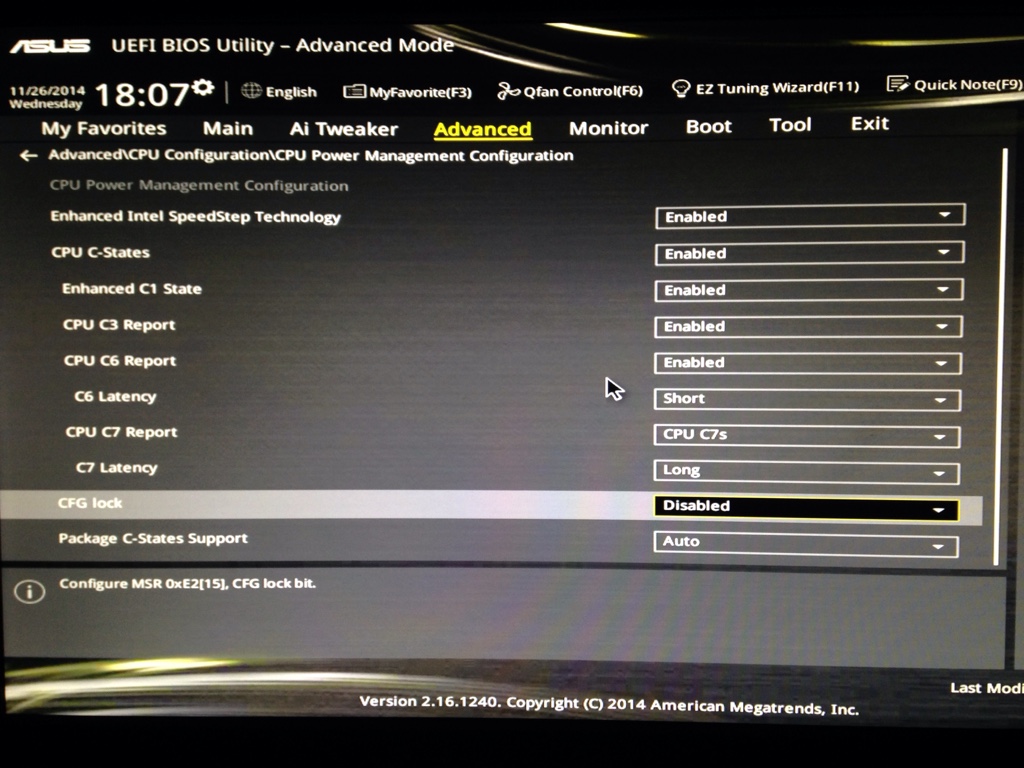

chriz74 Posted November 26, 2014 Share Posted November 26, 2014 Yes, if u look in Clover.zip i have made DSDT.aml and SSDT.aml unlocking bios for what? Asus bios have locked MSR so native powermanagment won't work unless you hack it. First I used a patched kext but that is not really the solution, the solution was unlocking the bios, however maybe your motherboard is stock unlocked, google it. Link to comment https://www.insanelymac.com/forum/topic/295587-power-management-for-sandyivy-bridgehaswell-cpus/page/10/#findComment-2089539 Share on other sites More sharing options...

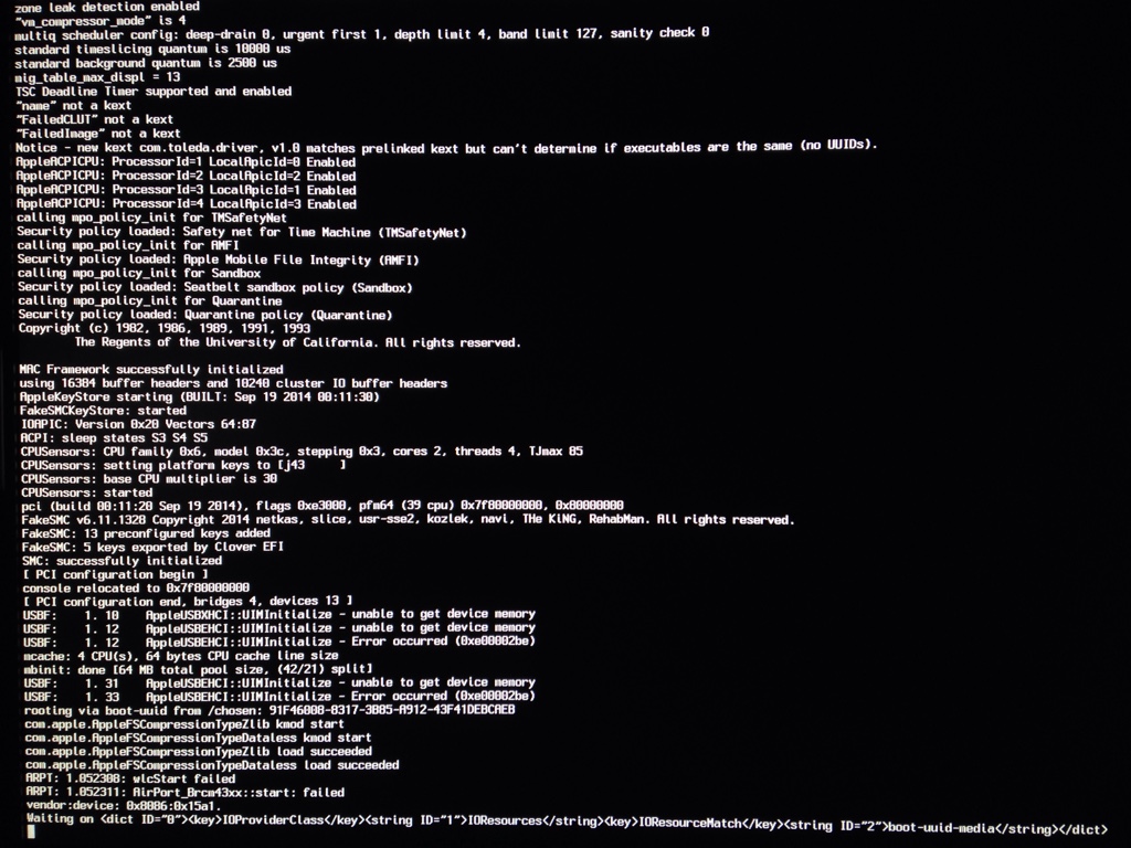

UltraLaser Posted November 26, 2014 Share Posted November 26, 2014 No lucky with Your config.plist : Link to comment https://www.insanelymac.com/forum/topic/295587-power-management-for-sandyivy-bridgehaswell-cpus/page/10/#findComment-2089626 Share on other sites More sharing options...
Allan Posted November 26, 2014 Share Posted November 26, 2014 Ok. Go in CLOVER/kexts/10.10 and delete: GPUSensors, LPCSensors, CPUSensors, ACPISensors and FakeSMC. And use this FakeSMC version: FakeSMC.kext.zip Link to comment https://www.insanelymac.com/forum/topic/295587-power-management-for-sandyivy-bridgehaswell-cpus/page/10/#findComment-2089641 Share on other sites More sharing options...

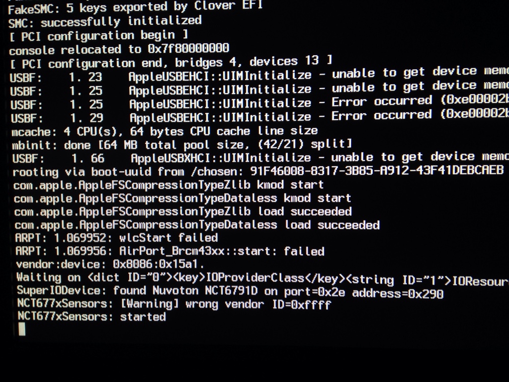

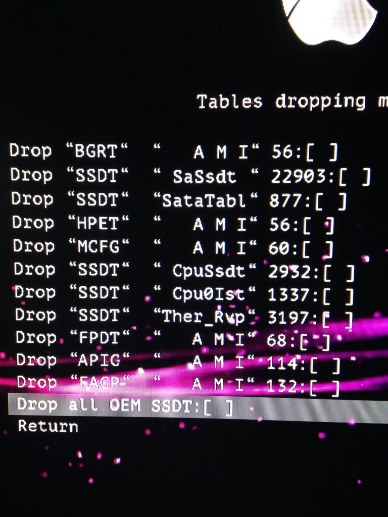

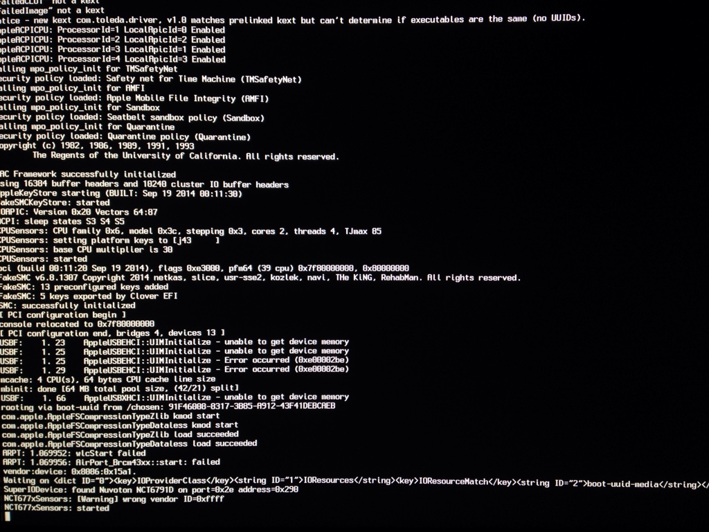

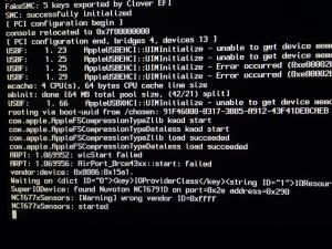

UltraLaser Posted November 26, 2014 Share Posted November 26, 2014 Now is blocked here Ok, i find this: If i leave the '+' from DROP ALL OEM SSDT i can boot into yosemite but still 8 and 30 in pstates Link to comment https://www.insanelymac.com/forum/topic/295587-power-management-for-sandyivy-bridgehaswell-cpus/page/10/#findComment-2089648 Share on other sites More sharing options...
Allan Posted November 26, 2014 Share Posted November 26, 2014 iMac give only 2 or 3 p-states. You apply the patch in kernel? Link to comment https://www.insanelymac.com/forum/topic/295587-power-management-for-sandyivy-bridgehaswell-cpus/page/10/#findComment-2089664 Share on other sites More sharing options...
UltraLaser Posted November 26, 2014 Share Posted November 26, 2014 iMac give only 2 or 3 p-states. You apply the patch in kernel? Yes, kernel patched and MD5 Sums verified. iMac only 2 or 3 pstates? is this my mistake? Link to comment https://www.insanelymac.com/forum/topic/295587-power-management-for-sandyivy-bridgehaswell-cpus/page/10/#findComment-2089667 Share on other sites More sharing options...
