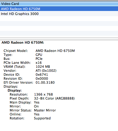

I just test this method get AMD GPU detected, but there is some problem like mouse lag seems need properly gfxcontrol policy, here is the log:
3/13/14 10:42:51.000 PM kernel[0]: /SourceCache/AppleGraphicsControl/AppleGraphicsControl-3.5.15/src/ApplePolicyControl/src/GfxPolicyControl.cpp:830 Assertion failed: pfbdev_ret
3/13/14 10:42:51.000 PM kernel[0]: [AGPM Controller] unknownPlatform
Those messages are caused because the ProductName is defined as MacBookPro8,1, but the macbook pro 8,1 doesn't have discrete graphics, so you need to change it to 8,2 or 8,3.  The first message disappear and the second turns to :
[AGPM Controller] build GPUDict by Vendor1002Device6741

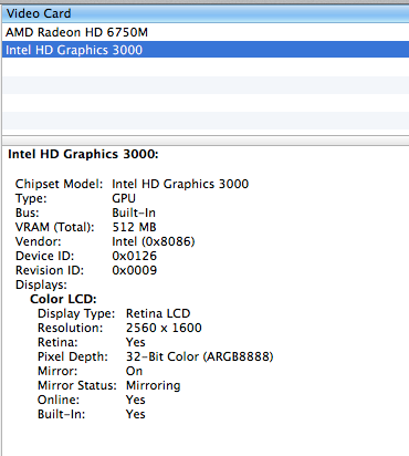

I've tried to make the discrete graphics work, but I only get the card to be recognized by the osx, without display. Maybe I'm doing something wrong with the FixEDID app and the DisplayMerge kext. How did you do to get the display working?
i do this after make it work on the first place and no more errors. u can see from picture i work only using hdmi outputting which is not real lvds connector, so even i correct agpm, i sitll get mouse lag.
One mote thing, i use ati rom decode tool to get connector information from video card bios, the result is no connector info output. therefore, i think it's not possible to make hybrid GPU work properly by far.
For displaymerge.kext, u can use edidfix.app, and use darwindump first to dump edid.hex info, the open edidfix, press patch edid, choose your own file and select your display type.then u will get it.

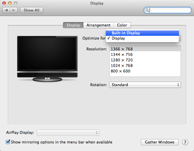

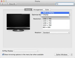

In regards yo screen artefacts on your laptop - please remind us what kind of screen do you have ? Ie device ID for vendor and product .. we are still missing one DisplayOverride for LGD 9DMK2  - [30e4:2e9] (produced early 2010)
so this may be the reason you are seeing screen glitches. Need to come up with a proper profile, so you could be a lab rat of sorts ;)

i have done all the considers, the result is mouse still lags. 2&3 shouldn't cause this issue, so it might be the problem of EDID. Anyway, even AMD gets work, but performance is bad as well cause outputting is through HDMI not real LVDS.

after update to 10.9.3 beta 2 version, no more mouse lag, OpenGL is higher than 10.9.3 beta1.
