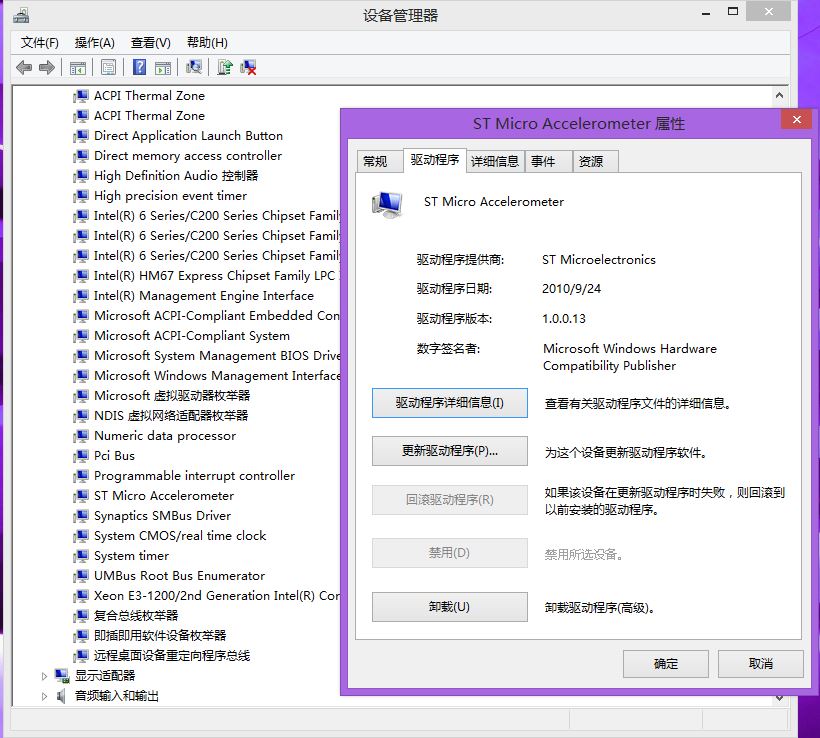

TimeWalker75a Posted March 8, 2014 Author Share Posted March 8, 2014 I've sent you a PM with detail. DELL Driver says N4110 supports accelerometer, but there's no accelerometer driver in driver downloads for I14R and there's no ACPI device for driver to attach to. So DELL has disabled this hardware functionality from the factory... Link to comment https://www.insanelymac.com/forum/topic/293246-osx-on-dell-vostro-3450-inspiron-n4110-xps-l702x-uefi-clover/page/18/#findComment-2001905 Share on other sites More sharing options...

Zprood Posted March 8, 2014 Share Posted March 8, 2014 Thanks, just come back mate, test newer c3 bios and install the driver from download link, turns out true. it has that device. here is the screen short. Link to comment https://www.insanelymac.com/forum/topic/293246-osx-on-dell-vostro-3450-inspiron-n4110-xps-l702x-uefi-clover/page/18/#findComment-2002003 Share on other sites More sharing options...
TimeWalker75a Posted March 8, 2014 Author Share Posted March 8, 2014 Cool, I'll send you C4 with accelerometer to test in ~20 mins. Link to comment https://www.insanelymac.com/forum/topic/293246-osx-on-dell-vostro-3450-inspiron-n4110-xps-l702x-uefi-clover/page/18/#findComment-2002004 Share on other sites More sharing options...
