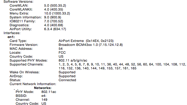

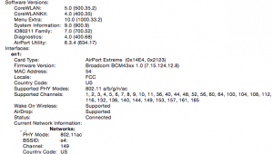

webcivilian Posted October 18, 2014 Share Posted October 18, 2014 Yosemite Final BCM4352 5Ghz for US: (original patch credit to: Skvo) 5 GHz Fix for BCM94352HMB with US country: Name: AirPortBrcm4360Find: 58 54 00 2B 18 2C 21 00 20Replace: 55 53 08 0A 36 1C 47 00 0A 1 Link to comment https://www.insanelymac.com/forum/topic/292542-airport-pcie-half-mini/page/7/#findComment-2071021 Share on other sites More sharing options...

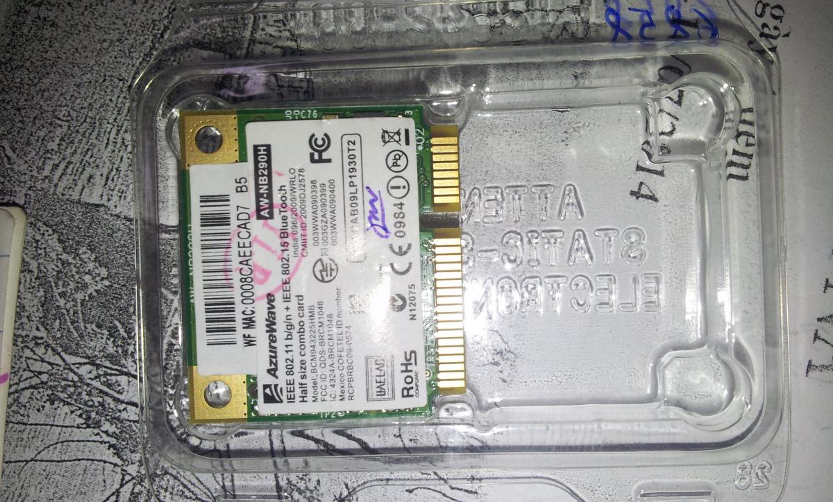

vuhothang Posted November 2, 2014 Share Posted November 2, 2014 My mini HTPC with main board ESC H81M3-I/HDMI link , it have mini pci express, i was buy Azurewave BCM943225HMB AW-NB290H wifi + bluetooth 3.0. I was edit info.plist in /S/L/E/IO80211Family.kext/Contents/Plugins/AirPortBrcm4360.kext <string>pci14e4,4357</string>. Now Yosemite can use Airport to connect wifi. But bluetooth doesn't show in info system, reboot to windows 8.1 or windows 7 my system can detect Broadcom 8011n adaptor but doesn't show bluetooth device. Can someone confirm this card have bluetooth. I doesn't see BT MAC on cable of this card. I was complain with seller, he said i much turn on bluetooth by laptop and he said itx main board doesn't support bluetooth. I don't known how to turn on bluetooth, i don't have any laptop. much i patch sudo perl -pi -e 's|\x58\x54\x00\x2B\x18\x2C\x21\x00\x20|\x58\x54\x08\x0A\x36\x1C\x47\x00\x0A|g' /Users/vuhothang/Desktop/IO80211Family.kext/Contents/PlugIns/AirPortBrcm4360.kext/Contents/MacOS/AirPortBrcm4360 i was copy IO80211Family.kext on my desktop Thanks! Link to comment https://www.insanelymac.com/forum/topic/292542-airport-pcie-half-mini/page/7/#findComment-2079817 Share on other sites More sharing options...
Ramalama Posted November 2, 2014 Share Posted November 2, 2014 Install BtFirmwareUploader.kext http://forum.osxlatitude.com/index.php?/topic/2925-bluetooth-firmware-uploader/ 2 Link to comment https://www.insanelymac.com/forum/topic/292542-airport-pcie-half-mini/page/7/#findComment-2080339 Share on other sites More sharing options...
vuhothang Posted November 3, 2014 Share Posted November 3, 2014 Thanks Ramalama! I was test this card with my brother's laptop, in this laptop have BCM943225HMP (not include bluetooth), when i replace with my card, in windows auto detect bluetooth device, it can connect with bluetooth mouse, phone.. Bluetooth have hardware ids: 13D3:9295 Rev 053 When i reinstall to my system, on windows 7 or 8.1 only Broadcom 8011n, doesn't have bluetooth device. I was read about BtFirmwareUploader.kext someone said no need run this uploader just edit info.plist in /IOBluetoothFamily.kext/Contents/Plugins/BroadcomBluetoothHostControllerUSBTransport.kext but many device with dec value. I was convert 13d3:3295 to 5057:12949 konsti, on 27 Oct 2014 - 6:31 PM, said: Hello everyone, thank you EMlyDinEsh for the work here and solving our wireless problems I am not sure if I am supposed to write here; as many of you mentioned, Mavericks BT accessory detection is not the same anymore and sometimes not working properly. I purchased this combo card AzureWave NB290H (using BCM43225HMB chip) but never tried it on Mountain Lion... went straight to Mavericks. I see inside the kext's plist that my card is not mentioned; my vendor ID is 0x13D3 (5075 decimal) and device ID is 0x3295 (12949 decimal). Although the BT device seems detected OK by the vanilla system, I cannot "see" or "pair" any BT accessories at all, either mouse or keyboard (Apple/Logitech). I address this to you with the hope you can guide me if you have any ideas, as to: a--if it makes sense to add this device/vendor to BTFirmwareUploader kext; b--if using your BTFirmwareUploader on vanilla installation/kexts, will produce any results. It's reported that this AzureWave NB290H (BCM43225HMB chip) card works out-of-the-box but not for me, with regard to Bluetooh... I've been battling with this BT device for days now. Please note that with vanilla Apple kexts, the BT device is detected but upon each reboot, it takes time to be activated, i.e. the menubar on the right shows a broken B icon and 2-3 mins later, max, it appears. Turn BT off option is disabled. Dunno if others face the same issue. By adding the device/vendor ID in the Info.plist of the BroadcomBluetoothHostControllerUSBTransport plugin in IOBluetoothFamily.kext, I have active BT device upon each reboot immediately and I can now "turn off". However, by no means I can link to any BT accessory, mouse or keyboard and there is nothing I can inject in my DSDT, hence my turn to EMlyDinEsh's kext for assistance. Many, many thanks. Your device does not need any patches so don't use my kext and just inject your device ids to Broadcom Bluetooth kext which should make it work. Also try to delete bluetooth plist and reboot then try to pair. Link to comment https://www.insanelymac.com/forum/topic/292542-airport-pcie-half-mini/page/7/#findComment-2080822 Share on other sites More sharing options...
Si Vis Pacem Posted November 4, 2014 Share Posted November 4, 2014 Thank you Skvo! sudo perl -pi -e 's|\x58\x54\x00\x2B\x18\x2C\x21\x00\x20|\x58\x54\x08\x0A\x36\x1C\x47\x00\x0A|g' /System/Library/Extensions/IO80211Family.kext/Contents/PlugIns/AirPortBrcm4360.kext/Contents/MacOS/AirPortBrcm4360 sudo touch /System/Library/Extensions/ AC working in DP7 10.10.1 Beta working Link to comment https://www.insanelymac.com/forum/topic/292542-airport-pcie-half-mini/page/7/#findComment-2080993 Share on other sites More sharing options...

rakimbadu Posted November 12, 2014 Share Posted November 12, 2014 Truly amazyng! actually it works! Thx a lot! Only one problem for me with handoff, it works only in one verse: i can see on my mac apps opened on the iphone but if i open for example safari on my mac nothing appened on the iphone. Any advice?However good good work thaks!!! EDIT nevermind, it randomly works, maybe it's only caused by my bad wifi Link to comment https://www.insanelymac.com/forum/topic/292542-airport-pcie-half-mini/page/7/#findComment-2084357 Share on other sites More sharing options...
