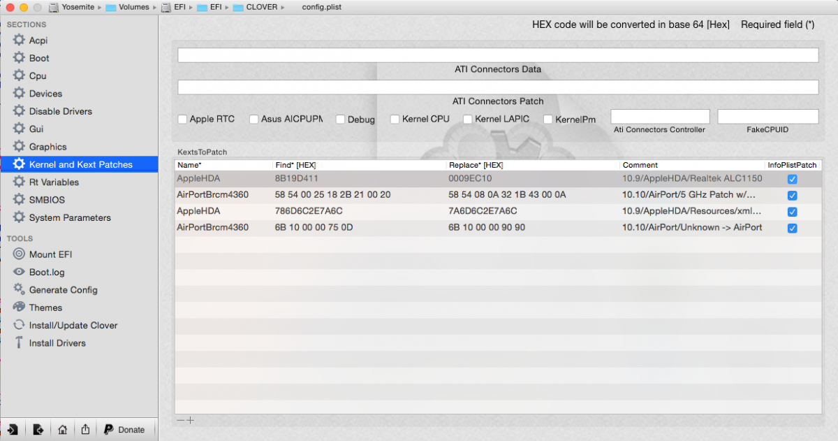

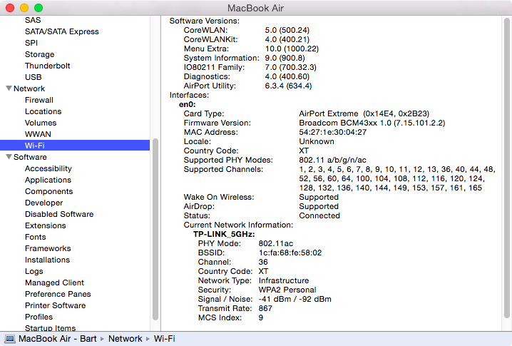

Skvo Posted July 11, 2014 Share Posted July 11, 2014 For OS X 10.10 DP3. Cosmetic Fix "Unknown -> AirPort " (optional) Name: AirPortBrcm4360Find: 6B 10 00 00 75 0DReplace: 6B 10 00 00 90 90 5 GHz Fix for BCM94352HMB with XT country: Name: AirPortBrcm4360Find: 58 54 00 25 18 2B 21 00 20Replace: 58 54 08 0A 32 1B 43 00 0A 8 Link to comment https://www.insanelymac.com/forum/topic/292542-airport-pcie-half-mini/page/4/#findComment-2039281 Share on other sites More sharing options...

lisai9093 Posted July 11, 2014 Share Posted July 11, 2014 For OS X 10.10 DP3. Cosmetic Fix "Unknown -> AirPort " (optional) Name: AirPortBrcm4360 Find: 6B 10 00 00 75 0D Replace: 6B 10 00 00 90 90 5 GHz Fix for BCM94352HMB with XT country: Name: AirPortBrcm4360 Find: 58 54 00 25 18 2B 21 00 20 Replace: 58 54 08 0A 32 1B 43 00 0A Снимок экрана 2014-07-11 в 06.24.54.png Works great. Thx! Link to comment https://www.insanelymac.com/forum/topic/292542-airport-pcie-half-mini/page/4/#findComment-2039346 Share on other sites More sharing options...
AREOS Posted July 11, 2014 Share Posted July 11, 2014 For OS X 10.10 DP3. Cosmetic Fix "Unknown -> AirPort " (optional) Name: AirPortBrcm4360 Find: 6B 10 00 00 75 0D Replace: 6B 10 00 00 90 90 5 GHz Fix for BCM94352HMB with XT country: Name: AirPortBrcm4360 Find: 58 54 00 25 18 2B 21 00 20 Replace: 58 54 08 0A 32 1B 43 00 0A Снимок экрана 2014-07-11 в 06.24.54.png Thanks Skvo, this works for me too. Do you have Hand off and Continuity working??? Good Luck Link to comment https://www.insanelymac.com/forum/topic/292542-airport-pcie-half-mini/page/4/#findComment-2039636 Share on other sites More sharing options...

treyboy484 Posted July 19, 2014 Share Posted July 19, 2014 For OS X 10.10 DP3. Cosmetic Fix "Unknown -> AirPort " (optional) Name: AirPortBrcm4360 Find: 6B 10 00 00 75 0D Replace: 6B 10 00 00 90 90 5 GHz Fix for BCM94352HMB with XT country: Name: AirPortBrcm4360 Find: 58 54 00 25 18 2B 21 00 20 Replace: 58 54 08 0A 32 1B 43 00 0A I'm not sure how to patch the AirPortBrcm4360 file. Can anyone explain to me how to do this? I tried using Clover's KextsToPatch feature, but it doesn't seem to be working. Link to comment https://www.insanelymac.com/forum/topic/292542-airport-pcie-half-mini/page/4/#findComment-2042010 Share on other sites More sharing options...
Maniac10 Posted July 19, 2014 Share Posted July 19, 2014 I'm not sure how to patch the AirPortBrcm4360 file. Can anyone explain to me how to do this? I tried using Clover's KextsToPatch feature, but it doesn't seem to be working. None of those patches are for plists so deactivate the InfoPlistPatch option. Link to comment https://www.insanelymac.com/forum/topic/292542-airport-pcie-half-mini/page/4/#findComment-2042057 Share on other sites More sharing options...
treyboy484 Posted July 19, 2014 Share Posted July 19, 2014 Okay thanks! Will that make the patches work then? EDIT: Works now. Thanks Maniac10! Link to comment https://www.insanelymac.com/forum/topic/292542-airport-pcie-half-mini/page/4/#findComment-2042059 Share on other sites More sharing options...

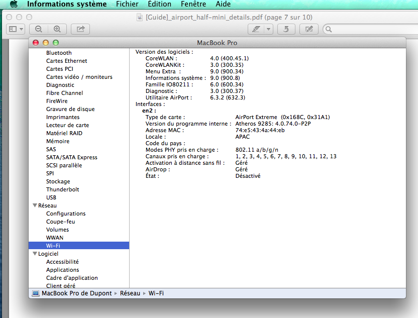

Martoni Posted July 31, 2014 Share Posted July 31, 2014 Hello, 1st thx for your work toledo, because of you now my wifi card is recognize.But the weird stuff is that it s never able to detect any network.I see all the networks with it when I boot under ubuntu.So I wonder I some people already had this problem.So my card is an Atheros 9285.I follow the guide and edit the : S/L/E/IO80211Family.kext/Contents/Plugins/AirPortAtheros40.kext/ Contents/Info.plist and I Add the string : <string>pci168c,2b</string> So after that it s recognize, appear in the top bar and in network options.in my system the card is well recognize, just didn't see any networksThx if you can help Link to comment https://www.insanelymac.com/forum/topic/292542-airport-pcie-half-mini/page/4/#findComment-2047000 Share on other sites More sharing options...
toleda Posted August 1, 2014 Author Share Posted August 1, 2014 So after that it s recognize, appear in the top bar and in network options. in my system the card is well recognize, just didn't see any networks See post #1, Problem Reporting, reply with requested files. What it the model number for your 9285? Link to comment https://www.insanelymac.com/forum/topic/292542-airport-pcie-half-mini/page/4/#findComment-2047424 Share on other sites More sharing options...
