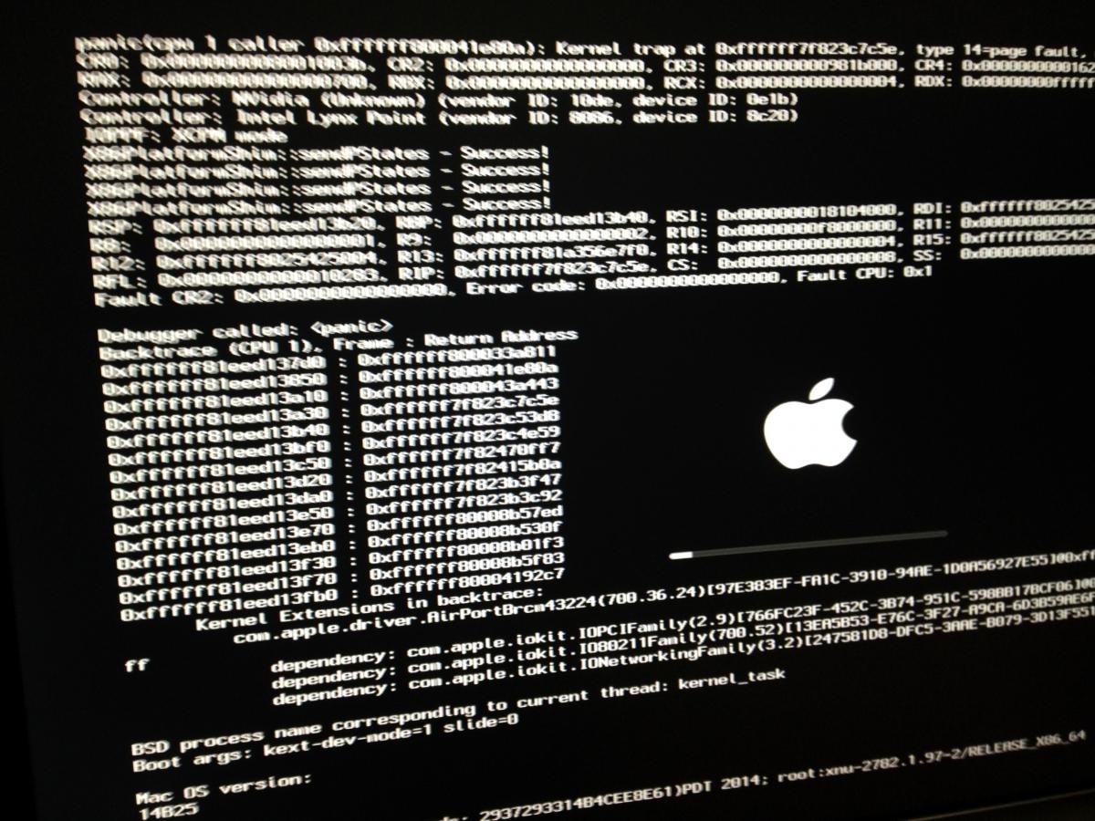

@Leo@ Posted December 10, 2014 Share Posted December 10, 2014 Hello Just insert the card bcm94352 me from this KP Link to comment https://www.insanelymac.com/forum/topic/292542-airport-pcie-half-mini/page/8/#findComment-2093983 Share on other sites More sharing options...
toleda Posted December 11, 2014 Author Share Posted December 11, 2014 Just insert the card bcm94352 me from this KP Wrong kext. What injection are you using from Post #1? Attach Post #1, Problem Reporting files. Link to comment https://www.insanelymac.com/forum/topic/292542-airport-pcie-half-mini/page/8/#findComment-2094042 Share on other sites More sharing options...
@Leo@ Posted December 11, 2014 Share Posted December 11, 2014 Wrong kext. What injection are you using from Post #1? Attach Post #1, Problem Reporting files. Hello ToledaI tried to install the kext: BrcmPatchRAM.kext and BTFirmwareUploader.kext as described in BCM94352 BT (10:10 and newer, 10.9 and newer) I could do a simple guide on how to make. Thanks Link to comment https://www.insanelymac.com/forum/topic/292542-airport-pcie-half-mini/page/8/#findComment-2094100 Share on other sites More sharing options...
toleda Posted December 11, 2014 Author Share Posted December 11, 2014 I tried to install the kext: BrcmPatchRAM.kext and BTFirmwareUploader.kext Two methods, select one or the other, not both. Link to comment https://www.insanelymac.com/forum/topic/292542-airport-pcie-half-mini/page/8/#findComment-2094172 Share on other sites More sharing options...
@Leo@ Posted December 11, 2014 Share Posted December 11, 2014 Two methods, select one or the other, not both.Then install only one of the two kext but for the patch you just need this? but I have to do the patch without the card otherwise? With the card does not start, go to KP Link to comment https://www.insanelymac.com/forum/topic/292542-airport-pcie-half-mini/page/8/#findComment-2094179 Share on other sites More sharing options...
