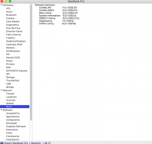

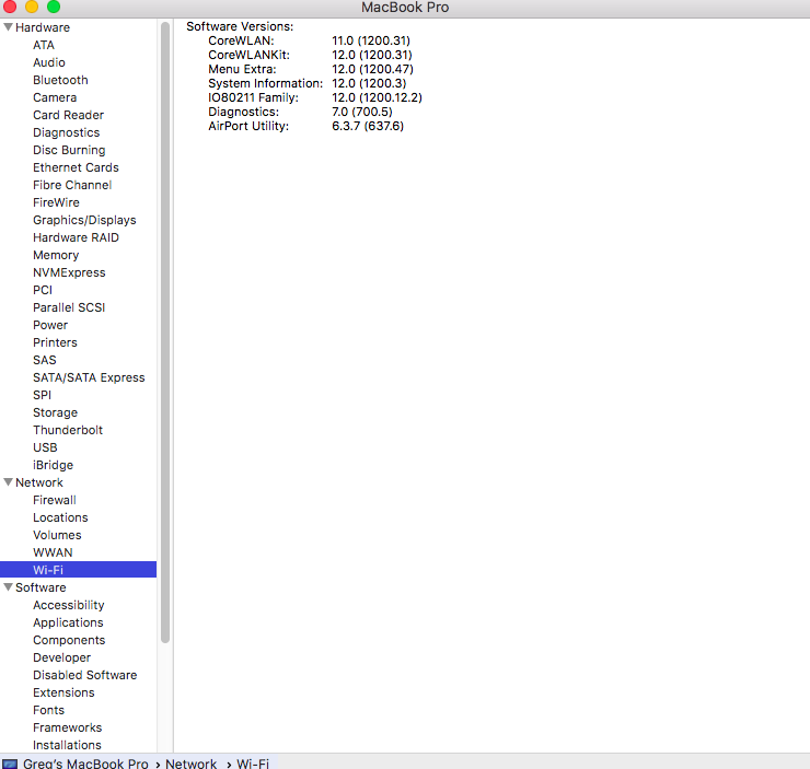

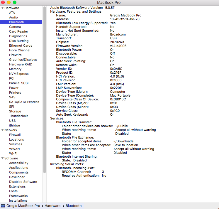

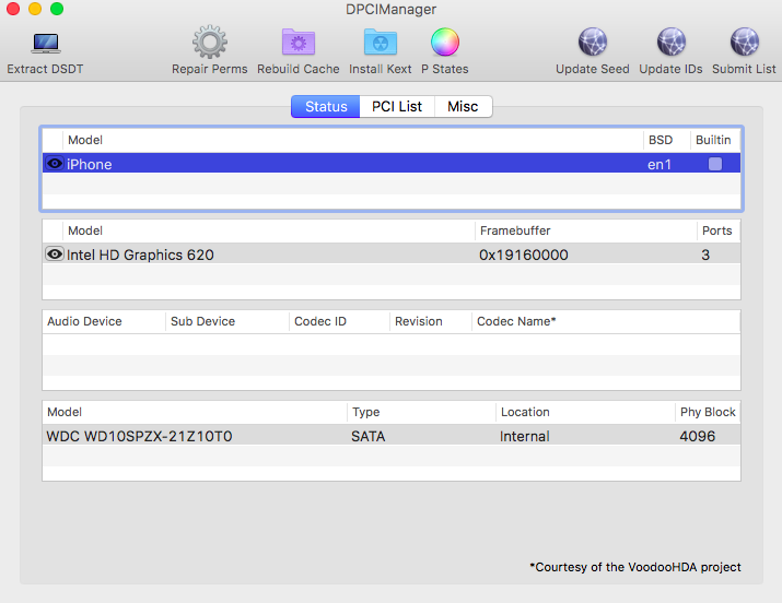

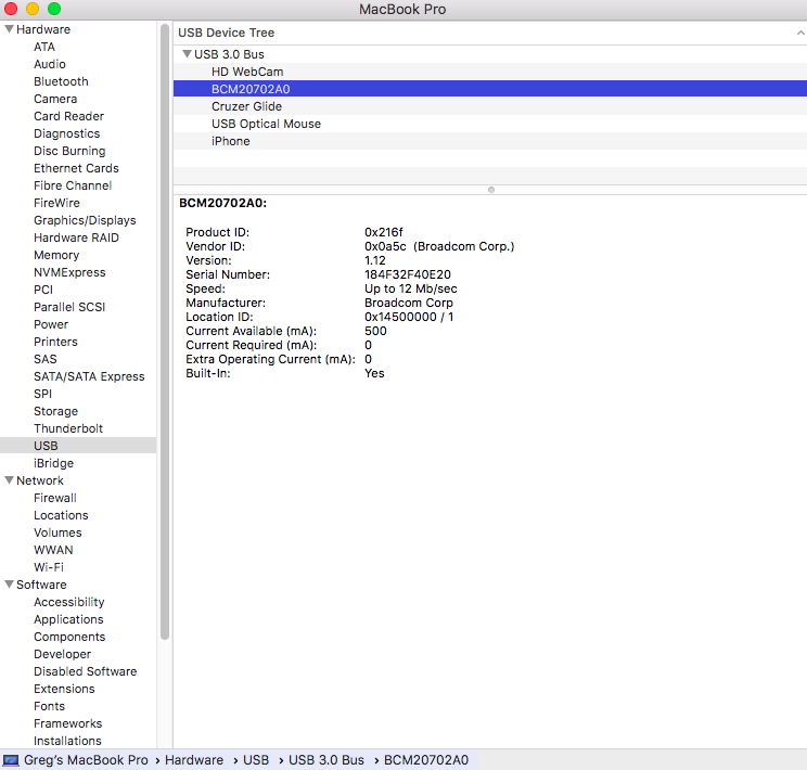

wikedone Posted December 3, 2017 Share Posted December 3, 2017 ok im stuck im gonna pull my hair out, I have Brcmfirmwaredata,kext, brcmfirmwarerepo.kext,brcmpatchram2.kext Fakepciid_broadcom_wifi.kext all in the efi\clover\kexts\other, i have this in kexttopatch Kext: AirPortBrcm4360 Find: 81F952AA00007529 Replace: 81F952AA00006690 I have this in forcekextstoload \System\Library\Extensions\IO80211Family.kext\Contents\PlugIns\AirPortBrcm4360.kext Devices in clove shows 0x43BA14E4 in the wifi box What else am i not doing i have no wifi but i have bluetooth pan in the network window and nothing else can anyone help me i been messing with this all day I uploaded all the file the needed files.zip it has the clover config and dcpi and ioreg needed files.zip Link to comment https://www.insanelymac.com/forum/topic/292542-airport-pcie-half-mini/page/31/#findComment-2543239 Share on other sites More sharing options...
wikedone Posted December 3, 2017 Share Posted December 3, 2017 this is the card i bought https://www.amazon.com/gp/product/B01N4EKSVC/ref=oh_aui_detailpage_o00_s00?ie=UTF8&psc=1 i was pointed toward this thread and this one http://www.insanelymac.com/forum/topic/312759-fix-macos-sierra-dp1-bcm94532z-wifi/ thanks Link to comment https://www.insanelymac.com/forum/topic/292542-airport-pcie-half-mini/page/31/#findComment-2543630 Share on other sites More sharing options...
foskvs Posted December 3, 2017 Share Posted December 3, 2017 this is the card i bought https://www.amazon.com/gp/product/B01N4EKSVC/ref=oh_aui_detailpage_o00_s00?ie=UTF8&psc=1 i was pointed toward this thread and this one http://www.insanelymac.com/forum/topic/312759-fix-macos-sierra-dp1-bcm94532z-wifi/ thanks You just need FakePCIID.kext and FakePCIID_Broadcom_WiFi.kext in EFI. Link to comment https://www.insanelymac.com/forum/topic/292542-airport-pcie-half-mini/page/31/#findComment-2543641 Share on other sites More sharing options...
wikedone Posted December 3, 2017 Share Posted December 3, 2017 I have both of those kexts in efi\clover\kexts\other So I don’t need the password patches in clover? Because right now as it stands it’s only working with Bluetooth Link to comment https://www.insanelymac.com/forum/topic/292542-airport-pcie-half-mini/page/31/#findComment-2543683 Share on other sites More sharing options...
wikedone Posted December 3, 2017 Share Posted December 3, 2017 Ok every thing is deleted except the Fcvo one the device I.D has been deleted from devices in clover and nothing has changed still WiFi anywhere Link to comment https://www.insanelymac.com/forum/topic/292542-airport-pcie-half-mini/page/31/#findComment-2543714 Share on other sites More sharing options...
