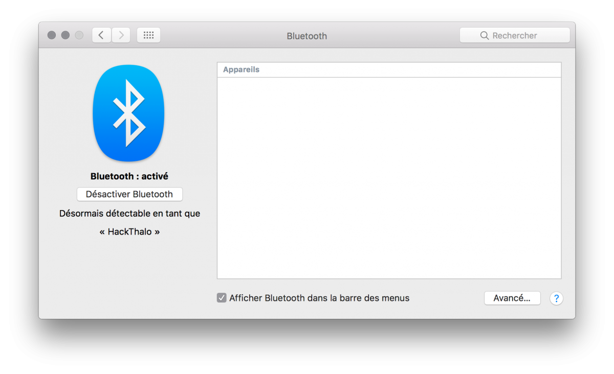

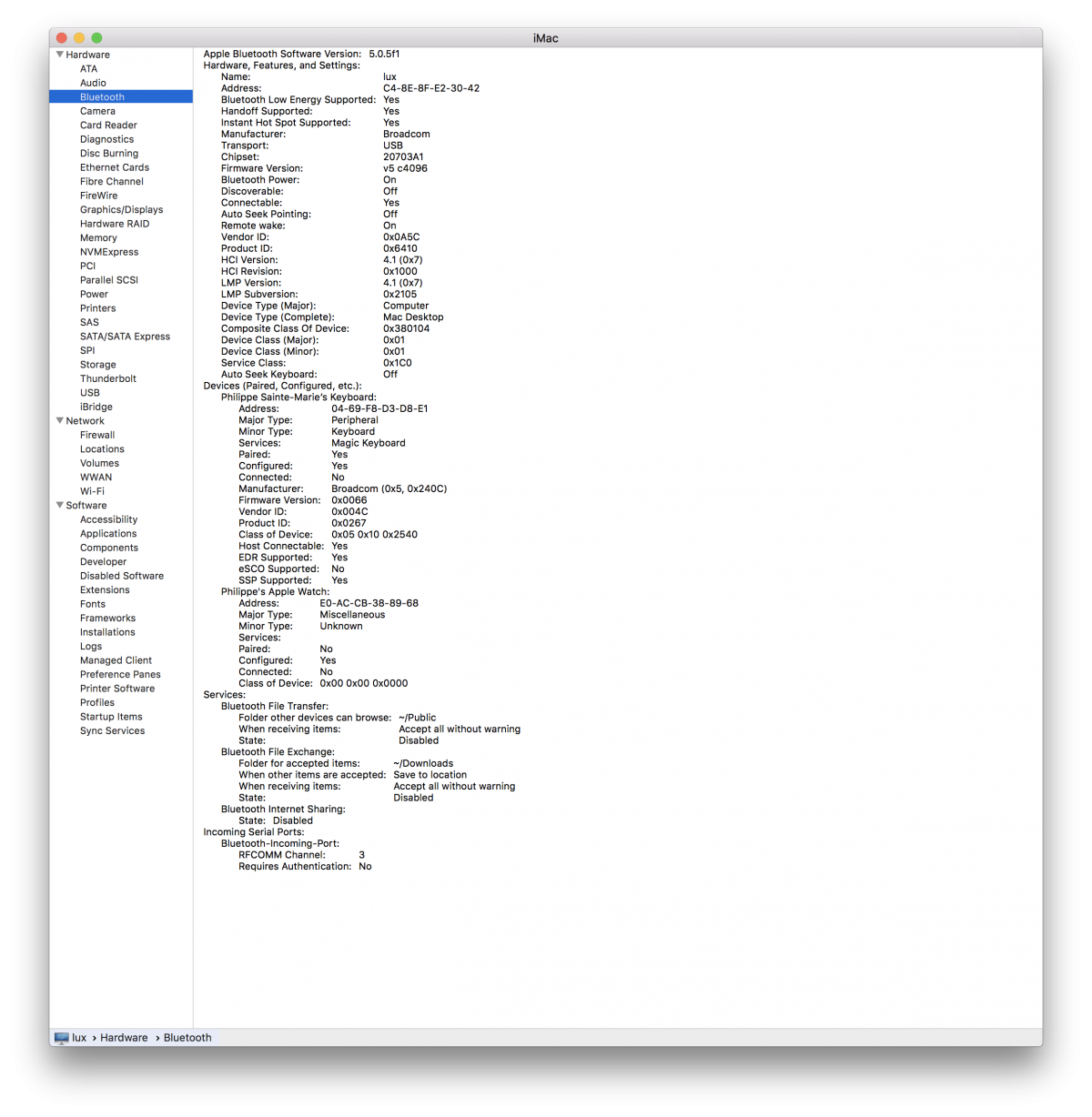

Hi, I recently bought a DW1830, to change my actual DW1560, wifi work oob, bt appear if i put these 2 kext: BrcmFirmwareRepo.kext and BrcmPatchRAM2.kext
BT is on, i see it on system profiler in the menu bar and in system prefs BUT:
it is not seen by other devices
it is not scanning.
has anyone seen something like this? what could i have missed?

My mistake, BT shows as BCM2045, should be BCM2070
2045 is not BT4
so that means DW1830 has 2 versions, 1 with BT4 and other with an older generation of BT?
or does that mean, the system doesn't recognize the bt chipset as it should be?

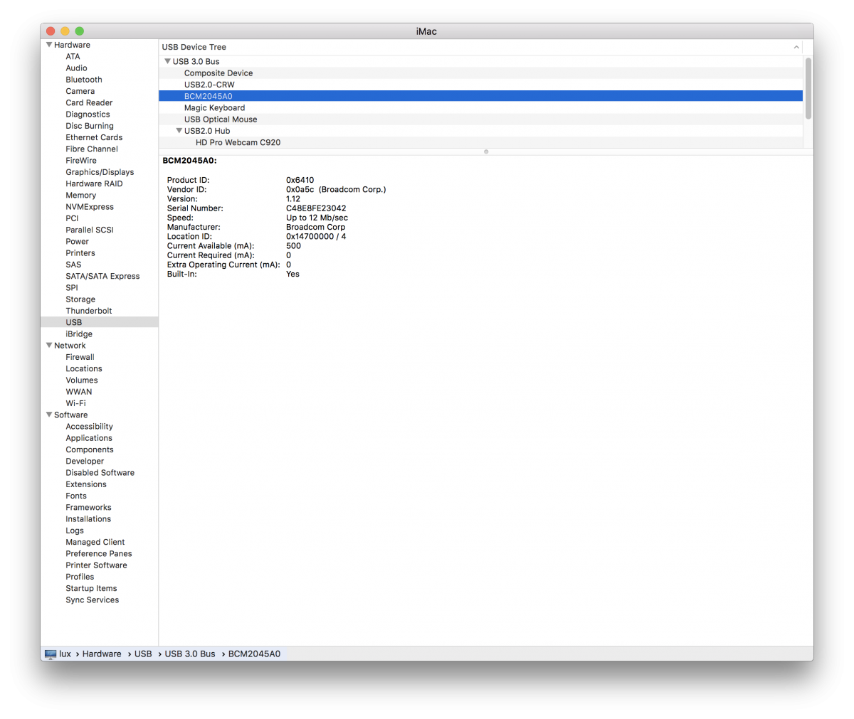

Hi Hervé! That's what i don't understand, the device id seems good, the DW1830 was bought on ebay as an AC WIFI + 4.1LE BT. for me it seems the good one. and yes i've see that wikidev report also BCM2045A0.
and the issue is: in system profiler, under USB, i have the BT device listed as BCM2045A0
but under BT i have the 20703A1 for chipset.
so. how can i get this one to work? first try the latest FakePCIID kext + the two bcrmpatch?
Hi Hervé.
So without the kexts, i see BT device under USB in sysprofiler as BCM2045A0 but no BLUETOOTH available for the system (nothing under bluetooth section of sysprofiler)
here attached are the files you asked for i think
tried your 2 firmware patching method with same issue. with kext bt available but not scanning/pairing
with no kext BT still not visible in sysprofiler except in USB devices as ◊

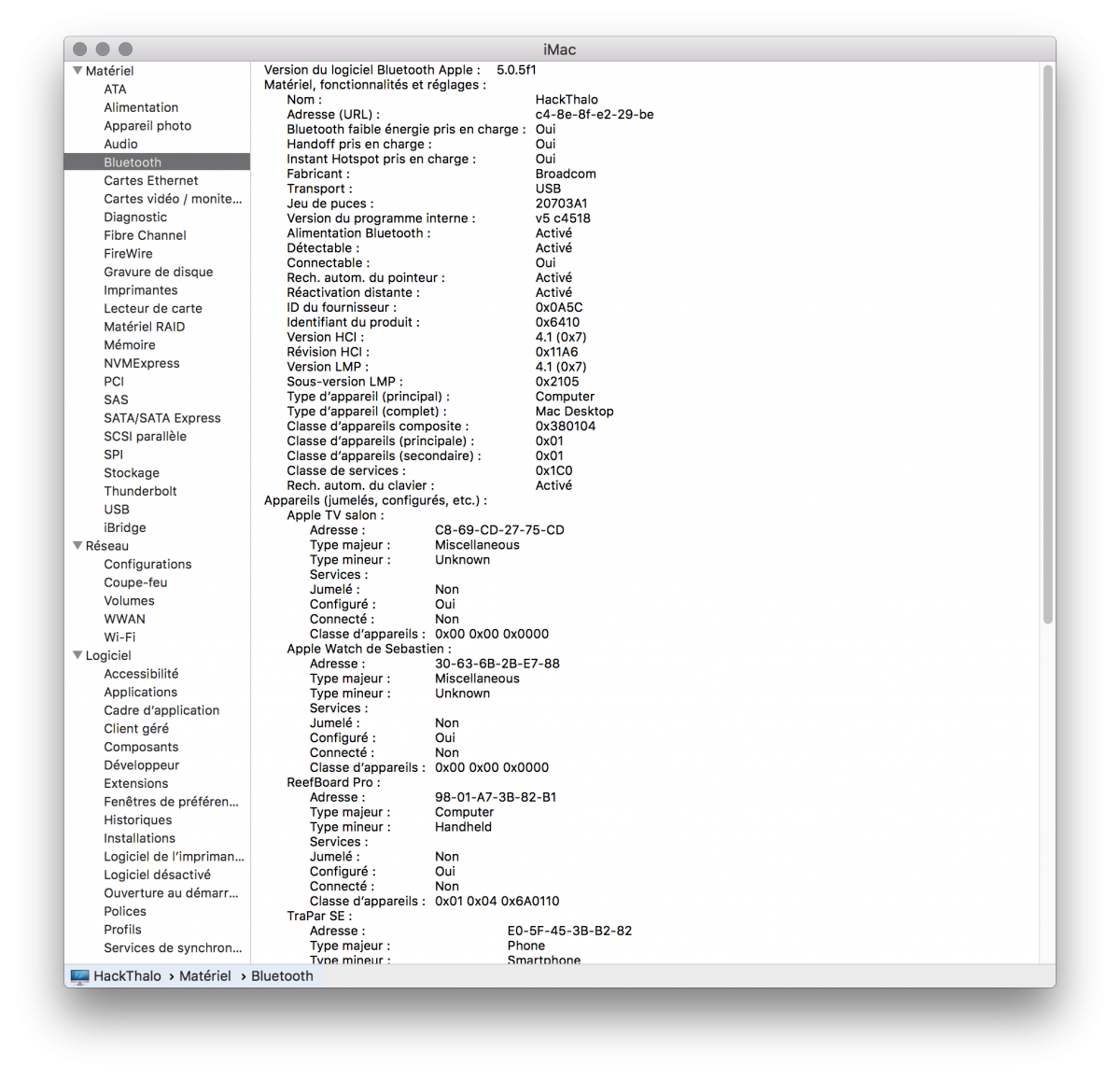

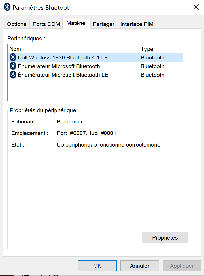

some news. i tested in another similar unit (ZOTAC EN 1060) the same card. on this one i have windows.
i could check the reading of bt card in the properties and it is the good bt device.

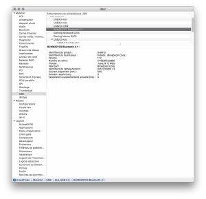

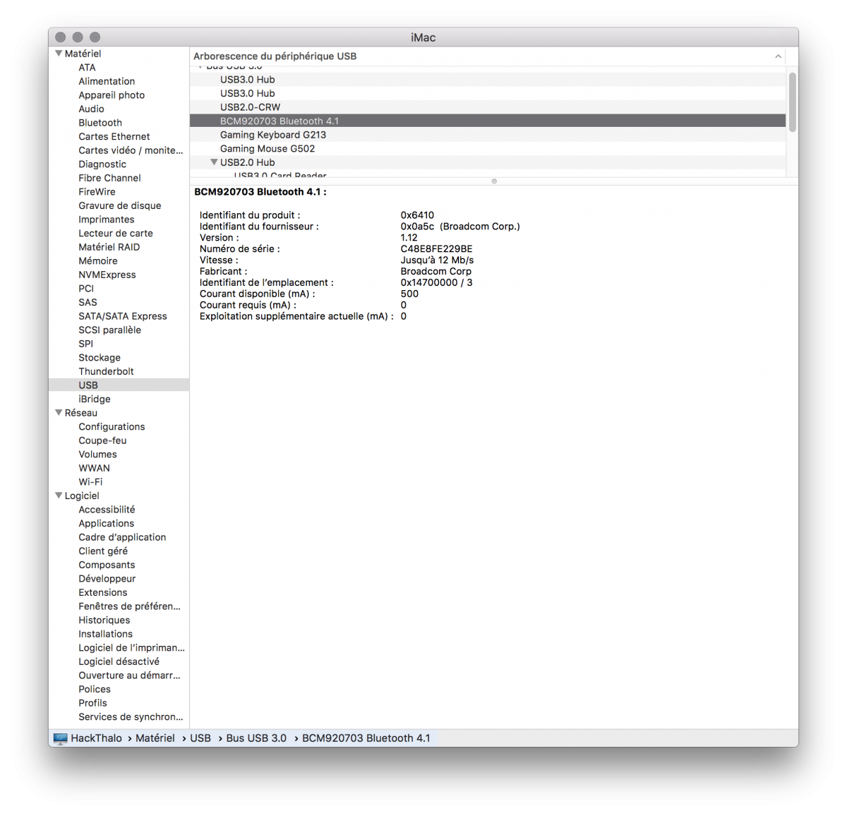

i then searched work from https://github.com/syscl/XPS9350-macOSand got the clover patch and the 2 brcm kext without full success.
now bt is recognized a 20703 in both bluetooth and usb sections of sysprofiler.
still not scanning though.
i’m going to try mess with the antenna as this card has 3 connecors vs 2 antennas in my Central unit.
Success, the antena order was different than what i read somewhere, bt is J1 not j2
