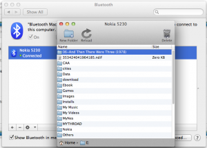

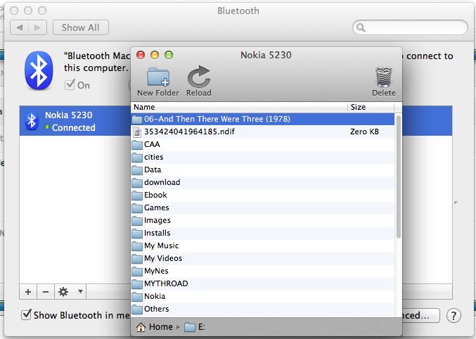

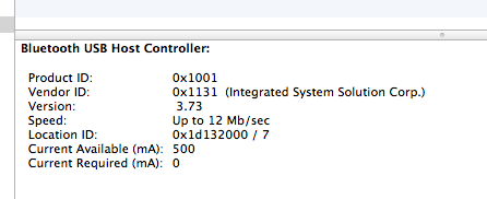

Slice Posted September 15, 2013 Share Posted September 15, 2013 My bluetooth works in 10.8.5. (but I have IOUSBFamily from 10.8.4 modified for USB3.0) 1 Link to comment https://www.insanelymac.com/forum/topic/291822-1085-out/page/3/#findComment-1945765 Share on other sites More sharing options...
p.H Posted September 15, 2013 Share Posted September 15, 2013 My bluetooth works in 10.8.5. (but I have IOUSBFamily from 10.8.4 modified for USB3.0) Screen Shot 2013-09-15 at 9.49.53.png Screen Shot 2013-09-15 at 9.48.12.png Hi, slice. Are you using the bluetooth dongle or the built-in BT in your Dell Notebook. Link to comment https://www.insanelymac.com/forum/topic/291822-1085-out/page/3/#findComment-1945782 Share on other sites More sharing options...

Slice Posted September 15, 2013 Share Posted September 15, 2013 Hi, slice. Are you using the bluetooth dongle or the built-in BT in your Dell Notebook. These screenshots are from desktop #1 with USB dongle inserted. My Dell Inspiron 1525 has another built-in bluetooth that works oob. But I have only 10.6.8 there. Link to comment https://www.insanelymac.com/forum/topic/291822-1085-out/page/3/#findComment-1945859 Share on other sites More sharing options...
