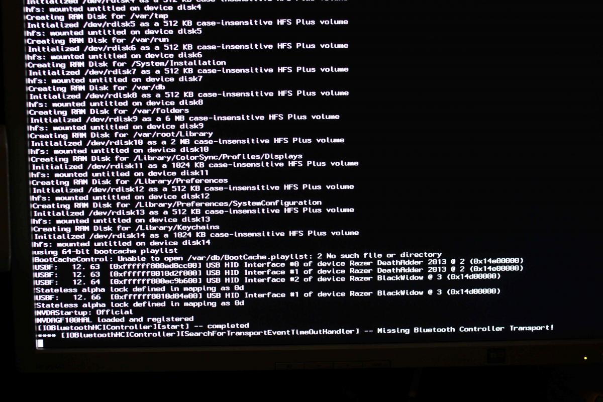

majusss Posted July 3, 2013 Share Posted July 3, 2013 I stuck with my motherboard at a very strange point... The patched BIOS is installed and I took the Mavericks installer from this tutorial. And know I tried several Boot flags such as: GraphicsEnabler, UID, npci. But the Boot just crashs or stuck at this point, also tried different USB ports. Iam booting from the GTX 470 with DVI. I would be so glad for some help with this problem. Thank you guys! Link to comment https://www.insanelymac.com/forum/topic/290326-asus-z87-gryphon-i5-4670k-nvidia-470-os-x-109/ Share on other sites More sharing options...
buoo Posted July 3, 2013 Share Posted July 3, 2013 Ok! Try with -v -x If it doesn't work try, unplug the GTX 470 and try with the integrated Intel HD. Link to comment https://www.insanelymac.com/forum/topic/290326-asus-z87-gryphon-i5-4670k-nvidia-470-os-x-109/#findComment-1929876 Share on other sites More sharing options...
majusss Posted July 3, 2013 Author Share Posted July 3, 2013 I also tried -v and -x in every combination. Ok i will try this in a few minutes. Thank you! Update: So the GFX is out but absolutely nothing changed... still stuck at the same point -.- so depressing Link to comment https://www.insanelymac.com/forum/topic/290326-asus-z87-gryphon-i5-4670k-nvidia-470-os-x-109/#findComment-1929880 Share on other sites More sharing options...
carbo178 Posted July 3, 2013 Share Posted July 3, 2013 Try -v -x GraphicsEnabler=Yes (or No) Link to comment https://www.insanelymac.com/forum/topic/290326-asus-z87-gryphon-i5-4670k-nvidia-470-os-x-109/#findComment-1930006 Share on other sites More sharing options...
majusss Posted July 4, 2013 Author Share Posted July 4, 2013 Tried this in every combination... Link to comment https://www.insanelymac.com/forum/topic/290326-asus-z87-gryphon-i5-4670k-nvidia-470-os-x-109/#findComment-1930072 Share on other sites More sharing options...
necrophagous Posted July 4, 2013 Share Posted July 4, 2013 try with graphics enabler = no , and verbose boot should work Link to comment https://www.insanelymac.com/forum/topic/290326-asus-z87-gryphon-i5-4670k-nvidia-470-os-x-109/#findComment-1930074 Share on other sites More sharing options...
jherbert Posted July 4, 2013 Share Posted July 4, 2013 I have both the asus z87 Expert and the Deluxe/Dual and to get past that for me, I have to disable the igpu multi monitor in the bios otherwise it hangs at that point. Link to comment https://www.insanelymac.com/forum/topic/290326-asus-z87-gryphon-i5-4670k-nvidia-470-os-x-109/#findComment-1930077 Share on other sites More sharing options...
Devout Posted July 4, 2013 Share Posted July 4, 2013 Hello you're missing dart=0 ! - Devout Try: -v -f GraphicsEnabler=No dart=0 PCIRootUID=0 Link to comment https://www.insanelymac.com/forum/topic/290326-asus-z87-gryphon-i5-4670k-nvidia-470-os-x-109/#findComment-1930144 Share on other sites More sharing options...
majusss Posted July 4, 2013 Author Share Posted July 4, 2013 Hello you're missing dart=0 ! - Devout Try: -v -f GraphicsEnabler=No dart=0 PCIRootUID=0 Hey thanks for that but it didn't booted -.- still the same error I have both the asus z87 Expert and the Deluxe/Dual and to get past that for me, I have to disable the igpu multi monitor in the bios otherwise it hangs at that point. I can't disable this function in the EFI Link to comment https://www.insanelymac.com/forum/topic/290326-asus-z87-gryphon-i5-4670k-nvidia-470-os-x-109/#findComment-1930188 Share on other sites More sharing options...
jherbert Posted July 4, 2013 Share Posted July 4, 2013 In the bios are you in the advanced interface for the bios? Across the top in the advanced bios interface is a category called advanced and then system agent confiuration and then graphics. That is where you can disable it. You set the primary to pcie and the disable the igpu multimonitor. I just downloaded the manual for your motherboard and it should be there. Link to comment https://www.insanelymac.com/forum/topic/290326-asus-z87-gryphon-i5-4670k-nvidia-470-os-x-109/#findComment-1930206 Share on other sites More sharing options...
majusss Posted July 6, 2013 Author Share Posted July 6, 2013 In the bios are you in the advanced interface for the bios? Across the top in the advanced bios interface is a category called advanced and then system agent confiuration and then graphics. That is where you can disable it. You set the primary to pcie and the disable the igpu multimonitor. I just downloaded the manual for your motherboard and it should be there. I just searched for this option but it isn't there... Link to comment https://www.insanelymac.com/forum/topic/290326-asus-z87-gryphon-i5-4670k-nvidia-470-os-x-109/#findComment-1930518 Share on other sites More sharing options...
jherbert Posted July 6, 2013 Share Posted July 6, 2013 In the manual for the motherboard on pages 3-31 amd 3-32 it shows the option. This is in the advanced interface that you enter from the E-Z interface that is discussed on page 3-2 in the manual. The option is supposed to be there. Link to comment https://www.insanelymac.com/forum/topic/290326-asus-z87-gryphon-i5-4670k-nvidia-470-os-x-109/#findComment-1930611 Share on other sites More sharing options...
majusss Posted July 7, 2013 Author Share Posted July 7, 2013 In the manual for the motherboard on pages 3-31 amd 3-32 it shows the option. This is in the advanced interface that you enter from the E-Z interface that is discussed on page 3-2 in the manual. The option is supposed to be there. This is really strange because I see the option in the manual but it isn't there in the BIOS o.O Link to comment https://www.insanelymac.com/forum/topic/290326-asus-z87-gryphon-i5-4670k-nvidia-470-os-x-109/#findComment-1930690 Share on other sites More sharing options...
k3nny Posted July 7, 2013 Share Posted July 7, 2013 It should look like this. Turning it off disables your internal Intel HD 4600 and you will have the dedicated Nvidia only, which is usually enough. You CPU does not support VT-d by the way, dart=0 won't have any effect here. 1 Link to comment https://www.insanelymac.com/forum/topic/290326-asus-z87-gryphon-i5-4670k-nvidia-470-os-x-109/#findComment-1930701 Share on other sites More sharing options...
majusss Posted July 7, 2013 Author Share Posted July 7, 2013 It should look like this. Turning it off disables your internal Intel HD 4600 and you will have the dedicated Nvidia only, which is usually enough. You CPU does not support VT-d by the way, dart=0 won't have any effect here. Omg in german the option have a totally different name... it isn't like "iGPU Multi-Monitor" its just "iGPU - enabled/disabled" and yes it is disabled all the time. Link to comment https://www.insanelymac.com/forum/topic/290326-asus-z87-gryphon-i5-4670k-nvidia-470-os-x-109/#findComment-1930703 Share on other sites More sharing options...
jherbert Posted July 7, 2013 Share Posted July 7, 2013 Also set the primary display to pcie and have GraphicsEnabler=no. I am watching your topic as it took a while before I finally found the settings and install for the the Asus boards up and running but now consistent in running mavericks and installing. Did not need a patched bios and settings in bios were the graphics settings mentioned. Will continue to follow. Thanks to k3enny for posting the bios page. Much clearer than my description and since the German is different. Link to comment https://www.insanelymac.com/forum/topic/290326-asus-z87-gryphon-i5-4670k-nvidia-470-os-x-109/#findComment-1930748 Share on other sites More sharing options...

Rampage Dev Posted July 19, 2013 Share Posted July 19, 2013 Remove the Nvidia drivers from SLE on the USB install stick and it will boot right it. What you are seeing is Mac hanging on the Card. Post install you can reinstall the drivers. This is a very common issue for your GPU. 1 Link to comment https://www.insanelymac.com/forum/topic/290326-asus-z87-gryphon-i5-4670k-nvidia-470-os-x-109/#findComment-1933183 Share on other sites More sharing options...
