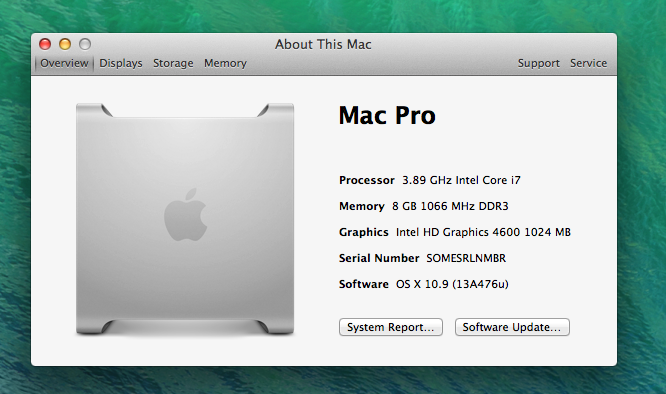

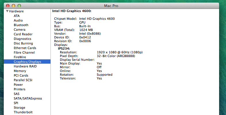

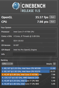

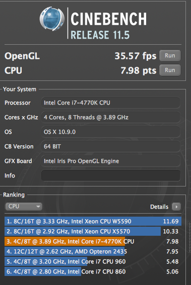

Pike R. Alpha Posted June 25, 2013 Share Posted June 25, 2013 DP2 works You have to delete the AppleIntelHD5000* kexts to get it to work. No! All you have to do is to inject AAPL,ig-product-id (I am using 0x0a16000 here) and then BOOM. Full resolution. QE/CI working. See my blog (link below) for the first Cinebench 11.5 test results (OpenGL score: 37.51 fps). See also: https://pikeralpha.wordpress.com/2013/06/25/os-x-10-9-mavericks-dp2-build-13a497d Link to comment https://www.insanelymac.com/forum/topic/289729-success-gigabyte-z87-d3hp-first-haswell-hackintosh/page/5/#findComment-1927690 Share on other sites More sharing options...
ameris_cyning Posted June 25, 2013 Author Share Posted June 25, 2013 No! All you have to do is to inject AAPL,ig-product-id (I am using 0x0a16000 here) and then BOOM. Full resolution. QE/CI working. See my blog (link below) for the first Cinebench 11.5 test results (OpenGL score: 37.51 fps). See also: https://pikeralpha.wordpress.com/2013/06/25/os-x-10-9-mavericks-dp2-build-13a497d Sorry I don't do integrated graphics Link to comment https://www.insanelymac.com/forum/topic/289729-success-gigabyte-z87-d3hp-first-haswell-hackintosh/page/5/#findComment-1927694 Share on other sites More sharing options...
smasumi Posted June 25, 2013 Share Posted June 25, 2013 What onboard LAN do you have? Gus93, I have the Intel i217V. No! All you have to do is to inject AAPL,ig-product-id (I am using 0x0a16000 here) and then BOOM. Full resolution. QE/CI working. See my blog (link below) for the first Cinebench 11.5 test results (OpenGL score: 37.51 fps). See also: https://pikeralpha.wordpress.com/2013/06/25/os-x-10-9-mavericks-dp2-build-13a497d Pike, could you point me in a direction on how to inject the device ID? I'm not very familiar with how to do that. Thanks guys. Link to comment https://www.insanelymac.com/forum/topic/289729-success-gigabyte-z87-d3hp-first-haswell-hackintosh/page/5/#findComment-1927810 Share on other sites More sharing options...
Gus93 Posted June 25, 2013 Share Posted June 25, 2013 Gus93, I have the Intel i217V. Pike, could you point me in a direction on how to inject the device ID? I'm not very familiar with how to do that. Thanks guys. That's unfortunate! My board has that and a Realtek 8111 (Dual LAN - FTW/absolutely unnecessary), but I was only able to get the realtek one going Link to comment https://www.insanelymac.com/forum/topic/289729-success-gigabyte-z87-d3hp-first-haswell-hackintosh/page/5/#findComment-1927848 Share on other sites More sharing options...
gaspimp Posted June 26, 2013 Share Posted June 26, 2013 I am very pleased with DP2. My annoying issue of network interfaces only coming up 50% of the time has gone away. Just to be clear, I have had no luck with onboard Intel i217 NIC. I'm using a PCIe 1x card with a Marvell 88E8053 chipset. Link to comment https://www.insanelymac.com/forum/topic/289729-success-gigabyte-z87-d3hp-first-haswell-hackintosh/page/5/#findComment-1927940 Share on other sites More sharing options...
smasumi Posted June 26, 2013 Share Posted June 26, 2013 I've had some luck with my onboard graphics. I changed the BIOS default onboard memory from 64MB to 512MB. Then I injected AAPL,ig-platform-id set to 0x0c260000 per Pike's blog and put that in my bootloader plist. I rebooted and I was greeted with my desktop at full resolution. My menu bar is translucent and it recognizes the model of my monitor. I haven't had any luck with using multiple displays with the onboard graphics. I have a VGA port, DVI port and HDMI. I use HDMI for my primary display. I tried hooking up another display via DVI, but the screen said "Out of Range" and when I booted with DVI and plugged in HDMI, the HDMI screen said "out of range." Both screens are recognized in the display panel and are running at their native resolutions, but I can't get them to both work at the same time. My next attempt was to hook up HDMI and VGA or DVI and VGA. In both scenarios the screen with HDMI and DVI would show a display, but the screen with VGA would show the white loading screen. The VGA screen was not recognized at all in the display preference panel. I tried to boot with "GraphicsEnabler=no" and I got a picture on the VGA screen, but it was just blocks and pieces of the main display, and again, was not recognized in the display panel. I ran a Cinebench test to compare to Pike's results. Screenshot is attached. On a side note, sleep still works and is directly related to the GPU. Without the ATI HD5770 card and without changing the platform ID, when the computer went to "sleep," it would just show a white screen without actually going to sleep. With the graphics card in, it would sleep properly, fans off, and would awaken via bluetooth or front panel. After I injected the code and took out the graphics card, sleep once again worked. I still have yet to find a solution for ethernet or wifi. I have the Intel i217V LAN chipset. Link to comment https://www.insanelymac.com/forum/topic/289729-success-gigabyte-z87-d3hp-first-haswell-hackintosh/page/5/#findComment-1927973 Share on other sites More sharing options...
