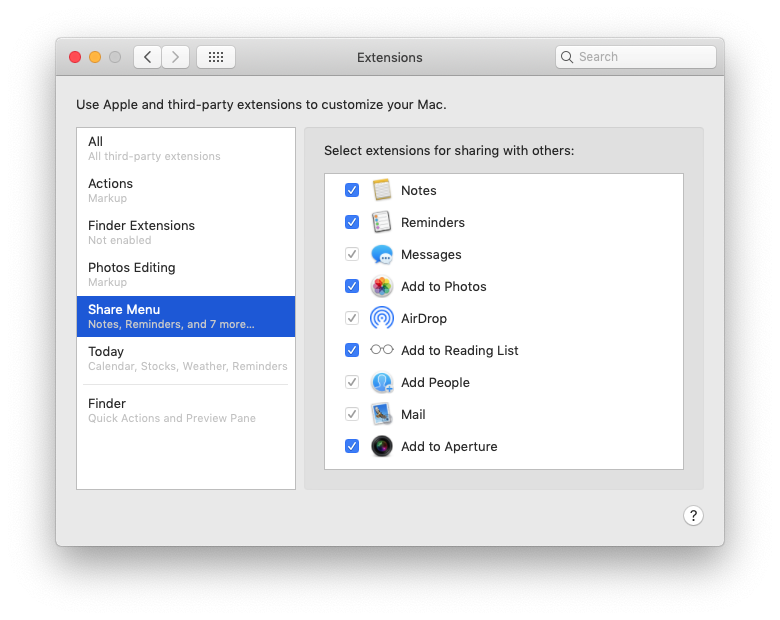

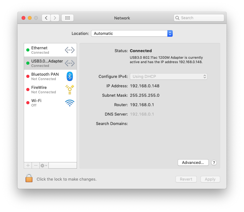

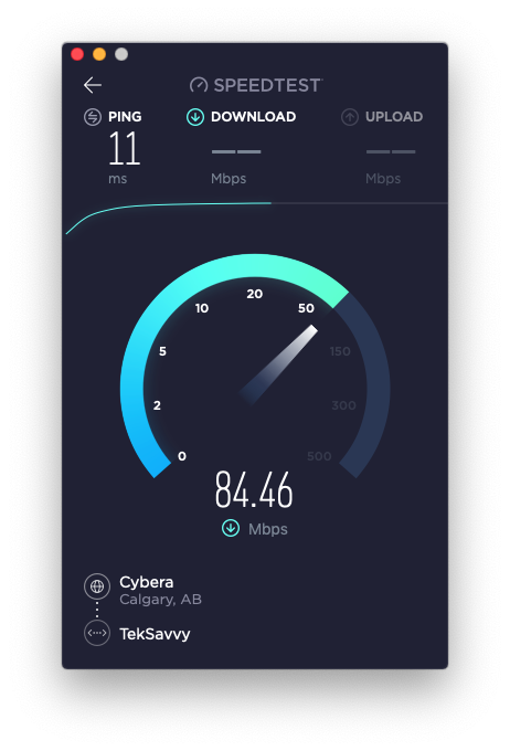

valiant Posted January 11, 2020 Share Posted January 11, 2020 (edited) Working Wifi, but... Rather than try to get the PCI wifi card working, I just bought a USB wifi dongle from Amazon. It was about the same price as the extension ribbon linked to above. https://www.amazon.ca/gp/product/B07RQCTKQY/ This seems to be a pretty generic product, there appear to be dozens of them on Amazon that look pretty similar. I chose this one because it's rated at 1200 rather than 600, does n and ac, 2.4 & 5 GHz bands, says it's MacOS 10.14 compatible, and was available with next day delivery. It ships with a mini-CD with drivers for Mac, Windows and Linux, but the Mac driver did not work under Mojave. However, I recalled that one of the descriptions for one of the other generic units mentioned Archer T3U, so I searched on that and found TP-Link has a beta driver for Catalina. That worked. https://www.tp-link.com/us/support/download/archer-t3u/#Driver The only thing is that it creates a new wifi item rather than using the stock Apple one. It puts in a menubar item separate from the normal wifi. It creates a new network item also. Throughput is limited by my cable modem, I get the same speed through the wifi as I do through ethernet. It's a USB 3 device and the marketing blurb says to use USB 3 for maximum speed, but USB 3 ports are a precious commodity on the QUO mobo, so after I got it up and running I switched it to one of the USB 2 ports. There was no drop in throughput. You may see a difference if you have a faster package, but on my 75 MBps plan I don't. <strike>I'm going to call this particular problem solved.</strike> Damn. I just checked and AirDrop is not working. Neither are Continuity or Handoff. Does anyone know how to fix that? Or are those services tied to Apple's wifi prefpane? Thanks! Edited January 11, 2020 by valiant I was wrong Link to comment https://www.insanelymac.com/forum/topic/285920-os-x-compatible-motherboard-quo/page/169/#findComment-2703821 Share on other sites More sharing options...
