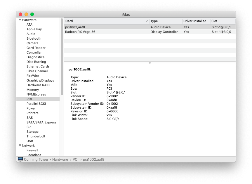

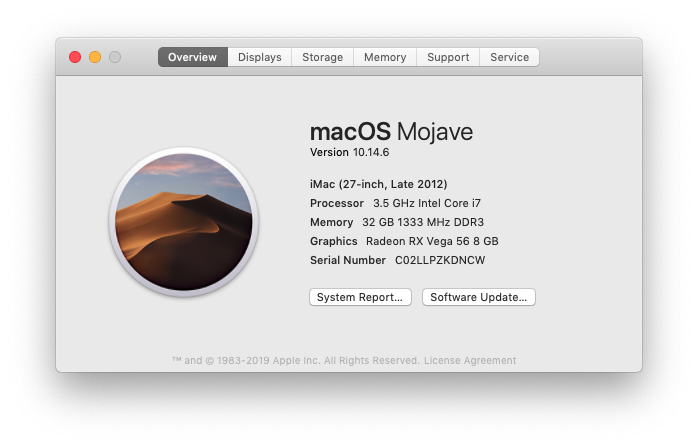

valiant Posted January 5, 2020 Share Posted January 5, 2020 OK, well, colour me an idiot. I finally installed the Vega 56, and that is where the problem lay. I found an old HDMI cable (I had been using DVI-D on my monitor, and the Vega doesn't have that) fired everything up and here we are. So thank you all for your patience, and I am here to confirm that NO, the onboard HD4000 graphics of the QUO motherboard do NOT work under Mojave. I don't know why it worked that one time, but that was it: once things were installed, it no longer accessed the graphics. The Vega works just fine, and is -much- faster. -- So, new problem. Wifi. I had a working TP-Link WDN4800 PCI-e 1x Wireless N card in slot 3, the PCIEX1_2 slot. Because the GTX770 was only two slots wide but the Vega 56 is three slots wide, I had to move it to slot 4, the PCIEX8 slot. It is not being seen. I understood that the PCI spec supported putting smaller cards in larger slots, so the PCIE1 card should work in a PCIE8 slot. Am I mistaken or could it be a driver problem? Ethernet and Bluetooth works just fine, but I'd like to have the wifi working too if possible. What should I try? Thanks. Link to comment https://www.insanelymac.com/forum/topic/285920-os-x-compatible-motherboard-quo/page/168/#findComment-2702948 Share on other sites More sharing options...

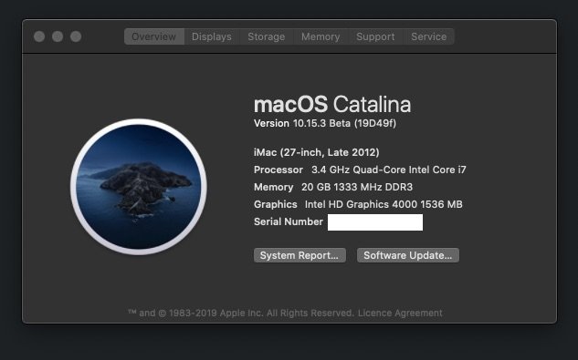

KMS Posted January 6, 2020 Share Posted January 6, 2020 4 hours ago, elviejo said: Could you explain how you did to make it work? Nothing special: Catalina installed on HD from real MacBookPro with Intel 4000 Fake/Lilu/Whatever on Extensions. Link to comment https://www.insanelymac.com/forum/topic/285920-os-x-compatible-motherboard-quo/page/168/#findComment-2703121 Share on other sites More sharing options...
elviejo Posted January 6, 2020 Share Posted January 6, 2020 7 hours ago, KMS said: Nothing special: Catalina installed on HD from real MacBookPro with Intel 4000 Fake/Lilu/Whatever on Extensions. Nothing special? not everybody have a real mac with Intel HD 4000. Link to comment https://www.insanelymac.com/forum/topic/285920-os-x-compatible-motherboard-quo/page/168/#findComment-2703209 Share on other sites More sharing options...
