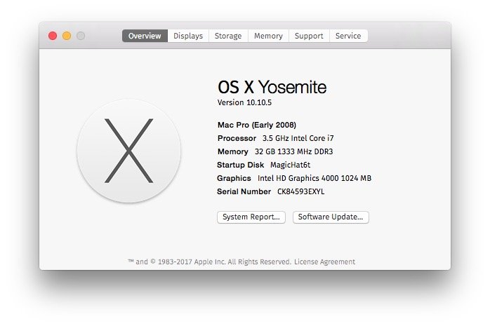

valiant Posted December 16, 2019 Share Posted December 16, 2019 Hmm... My QUO thinks it's a MacPro. Could that have something to do with it? And if so, where do I change that? Link to comment https://www.insanelymac.com/forum/topic/285920-os-x-compatible-motherboard-quo/page/167/#findComment-2700780 Share on other sites More sharing options...
valiant Posted December 16, 2019 Share Posted December 16, 2019 OK. I'm trying to figure out how to change my Mac model. It looks like the "proper" setting for an i7-3770 is to be an iMac13,2. So I'm googling how to change your hack model number. Right now I'm going down a rabbit hole of Chameleon Wizard, Clover Configurator, generating new serial numbers, checking them at Apple's check coverage, rinse, repeat, rinse. It occurred to me that maybe this isn't the right way to do it. Am I doing this wrong? Is there a way to do it within Ozmosis or something? I have 5 days left to get this working and decide whether or not to keep the Radeon Vega 56. Right now 5 days doesn't feel like enough time... Link to comment https://www.insanelymac.com/forum/topic/285920-os-x-compatible-motherboard-quo/page/167/#findComment-2700788 Share on other sites More sharing options...
ntsmkfob Posted December 16, 2019 Share Posted December 16, 2019 You need a Defaults.plist in the EFI/Oz folder of your boot device. Back in this topic there is a recent example of a plist with an iMac (13,2) configuration. Others here successfully use a MacMini setup. All you should need to do is insert a SystemSerial number and BaseBoardSerial number - probably ones you used previously. You should also put kernextpatcher.plist (below) in the EFI partition. Hold down F12 during boot to get to the boot menu. When there press Cmd+Option+P+R simultaneously to get the BIOS to read the new Defaults.plist. You'll need to go into the UEFI shell to find the file system to boot. If all OK you can update the BIOS to XMAX-E and try again. KernextPatcher.plist Link to comment https://www.insanelymac.com/forum/topic/285920-os-x-compatible-motherboard-quo/page/167/#findComment-2700838 Share on other sites More sharing options...
valiant Posted December 17, 2019 Share Posted December 17, 2019 On 12/12/2019 at 6:12 AM, IronManJFF said: You need a Defaults.plist in the EFI/Oz folder of your boot device. Thanks! I think I found the defaults.plist you referenced. One of the weird things is that in the wiki it says that when I update the ROM to MASS or MASX it will automatically create an Oz directory. I assume that's in /EFI/ so the path is (boot-drive)/EFI/OZ. That did not seem to happen in my case, so I created an OZ directory in /EFI/ manually. Is that a flag that something went wrong, or is it OK to do it that way? My EFI directory also had /BOOT and /CLOVER folders in it. I removed them. I also have an Extra directory which I renamed. I copied my s/n and UUID from my System Profile into /EFI/OZ/defaults.plist and rebooted. My hack still thinks it's a MacPro3,1. Where else could it be pulling that setting from? My machine doesn't want to download any OS installers beyond El Capitan because it doesn't think it can install them. Thanks. Link to comment https://www.insanelymac.com/forum/topic/285920-os-x-compatible-motherboard-quo/page/167/#findComment-2700882 Share on other sites More sharing options...

elviejo Posted December 18, 2019 Share Posted December 18, 2019 On 12/17/2019 at 6:28 AM, ntsmkfob said: Your system "thinks" is a Mac Pro 3,1 because you are using a rom with the default plist in it, what you need to do is to put the ssd in sata 0 ( disconnect all other drives you have ) then you have two options, insert an OzmosisDefaults.plist within an iMac 13,2 or Mac mini 6,2 or 8,1 in the rom provided a few posts back or put the defaults plist on the directory Ozmosis create in the EFI partition ( you will probably will need to boot from an early system to do that or do it from the shell) if you do the first when you flash the new rom it will actualize the system, you will need to go to settings and load optimized defaults and then choose PEG in the video card default, IPEG could be disabled or let as auto; remember you can't boot with the onboard card on Mojave or Catalina, you need a card supported, remember that nvidia have no drivers for mojave or catalina. Sorry, quoted ntsmkfob instead of valiant Link to comment https://www.insanelymac.com/forum/topic/285920-os-x-compatible-motherboard-quo/page/167/#findComment-2701065 Share on other sites More sharing options...

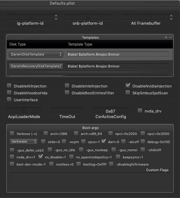

IronManJFF Posted December 23, 2019 Share Posted December 23, 2019 Can u post your Defaults.plist ? So you want Mojave, RX580, MacOS only ? Hi. Where did you find that plist editor? Is it Windows only? I'm on a Mac.... Don’t use it , does not work properly Link to comment https://www.insanelymac.com/forum/topic/285920-os-x-compatible-motherboard-quo/page/167/#findComment-2701501 Share on other sites More sharing options...
IronManJFF Posted December 23, 2019 Share Posted December 23, 2019 (edited) Quote Along the way I bought a new SSD and formatted it to blank/journaled/GUID. I put it on SATA 0. Apparently one of the ROM updates is supposed to create a EFI/Oz directory on the SATA 0 disk. That never happened. I don't know if that only works if you already have a working boot OS on the drive, which I don't. But no EFI folder, no Oz folder. Just the standard hidden files a disk has. The EFI folder will be created in the ESP partition not the regular one ... this is not Clover. Reformat the drive Flash XMAX-E Firmware then boot to UEFI shell... fs0: ls and you should see the EFI folder cd EFI ls And you should see the Oz folder This is where you should put Defaults.plist. After doing this, hit Command-Option-P-R Another thing you might not be aware of is that even tough Ozmosis can boot from APFS partitioned drive, it does not know how to detect them so you have to tell it ... I made a post some time ago about that ... Edited December 23, 2019 by IronManJFF Link to comment https://www.insanelymac.com/forum/topic/285920-os-x-compatible-motherboard-quo/page/167/#findComment-2701505 Share on other sites More sharing options...
