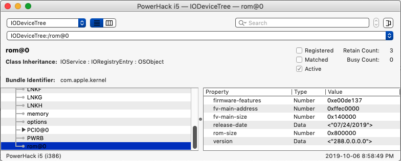

genzai Posted October 5, 2019 Share Posted October 5, 2019 Hey guys and espcially @IronManJFF, Finally decided to update my Quo to Mojave. I got the install to work fine after some fiddling. I installed the BIOS linked to here: https://www.insanelymac.com/applications/core/interface/file/attachment.php?id=324811 Which i believe is the latest one with Mojave edits. Anyway, the main issue i am facing now is that before moving to Mojave i installed an RX580. In order to get past the apple logo without a loading bar (it hangs there otherwise) i had to disable the iGPU in BIOS. even after Mojave is fully installed and everything else is working, if i re-enable the iGPU in bios it hangs at this apple logo- like before it really even starts to load. I know some of you are using RX580 + iGPU right? whats the trick? FWIW i plan to use iGPU in headless mode (i think i have this set correctly in defaults.plist) but nothing i have tried besides disabling iGPU completely allows me to boot Mojave so far. Doesn't seem to matter if its primary or not. Thanks! g\ Link to comment https://www.insanelymac.com/forum/topic/285920-os-x-compatible-motherboard-quo/page/166/#findComment-2692314 Share on other sites More sharing options...
IronManJFF Posted October 7, 2019 Share Posted October 7, 2019 (edited) iGPU in headless + GTX970 worked in High Sierra, never was able to boot that combo in Mojave Switched to RX580 back to default settings (Auto) for Internal Graphics and Init Display First and updated to latest Mojave. Working on Catalina Beta (Clean Install) in my spare time.. stuck at white screen after install. Edited October 7, 2019 by IronManJFF Link to comment https://www.insanelymac.com/forum/topic/285920-os-x-compatible-motherboard-quo/page/166/#findComment-2692450 Share on other sites More sharing options...

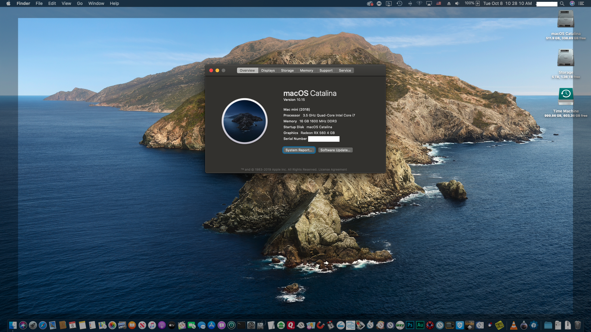

elviejo Posted October 8, 2019 Share Posted October 8, 2019 Upgraded without a hitch. Link to comment https://www.insanelymac.com/forum/topic/285920-os-x-compatible-motherboard-quo/page/166/#findComment-2692690 Share on other sites More sharing options...
elviejo Posted October 8, 2019 Share Posted October 8, 2019 Going to stay with Mojave until apps get upgraded to 64 bits. Link to comment https://www.insanelymac.com/forum/topic/285920-os-x-compatible-motherboard-quo/page/166/#findComment-2692696 Share on other sites More sharing options...

elviejo Posted October 14, 2019 Share Posted October 14, 2019 (edited) Playing with Catalina and it looks really good power management works a lot better tan Mojave, a warning, you need a dedicated graphic card, the internal don't even boot and you have to choose the PEG card as default in bios not automatic. Attached is the rom I use with the exception of Ozmosis default ( I use macmini8,1 ), you must replace it with a defaults appropriated to the new OS. Enjoy Ozmosis-Catalina.rom.zip Edited October 14, 2019 by elviejo Link to comment https://www.insanelymac.com/forum/topic/285920-os-x-compatible-motherboard-quo/page/166/#findComment-2693617 Share on other sites More sharing options...
IronManJFF Posted October 15, 2019 Share Posted October 15, 2019 Same here .. except using the same firmware as before .. placed FakeSMC, Lilu and WhateverGreen in /LE Link to comment https://www.insanelymac.com/forum/topic/285920-os-x-compatible-motherboard-quo/page/166/#findComment-2693767 Share on other sites More sharing options...
