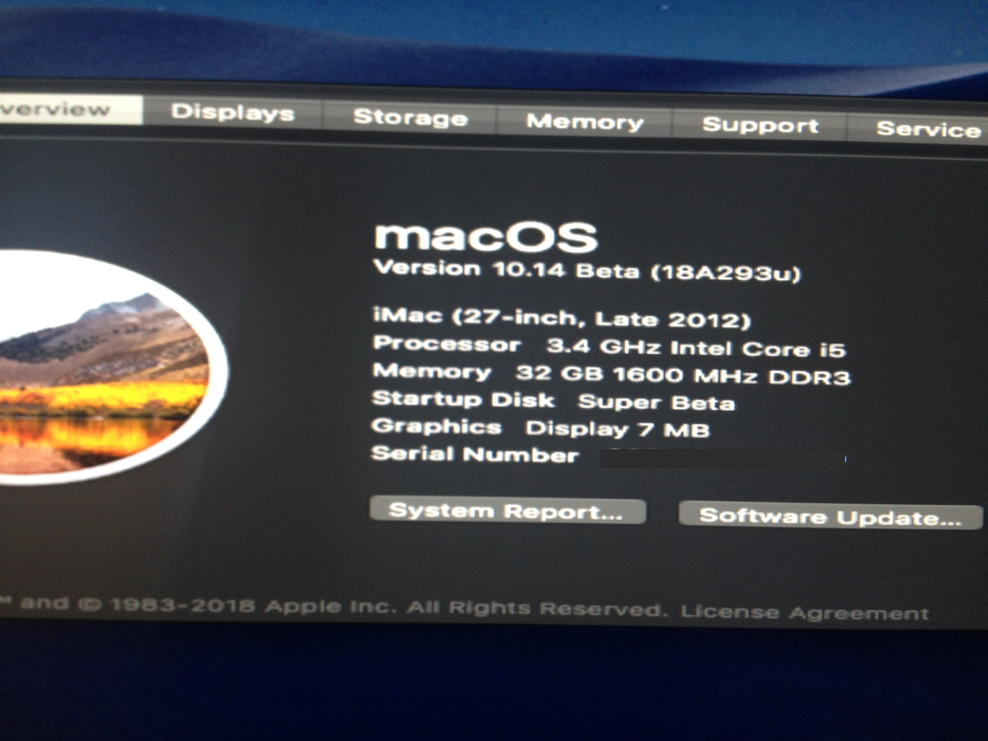

On 6/15/2018 at 12:55 AM, IronManJFF said:
Having a look at Mojave DP
-- No Firmware Update for iMac13
-- No SMC update for iMac13
Downloading again because of checksum error on InstallESD.dmg
Created USB Installer ...
  -- Cannot get into Installer, getting messages about Architecture not recognized, Unsupported CPU, Unsupported PCH, kexts stalled AppleACPICPU
That is all for today...
I had same thing with Ozmosis on my board, but i waited few minutes even with same errors above and the install screen appeared. Kext injection doesn't work on Mojave yet.
  • Thanks 1

In the meantime I was able to make some progress.... had to boot in single-user mode to load FakeSMC.kext and change boot-args to disable Nvidia which caused Kernel Panic.
There are limitations right now (like not Nvidia Web drivers)
But the good news so far is Mojave on QUO -> It can be done (Disclaimer : We are still on Dev Beta so ...)
Week-end is over :no:
Edited by IronManJFF
