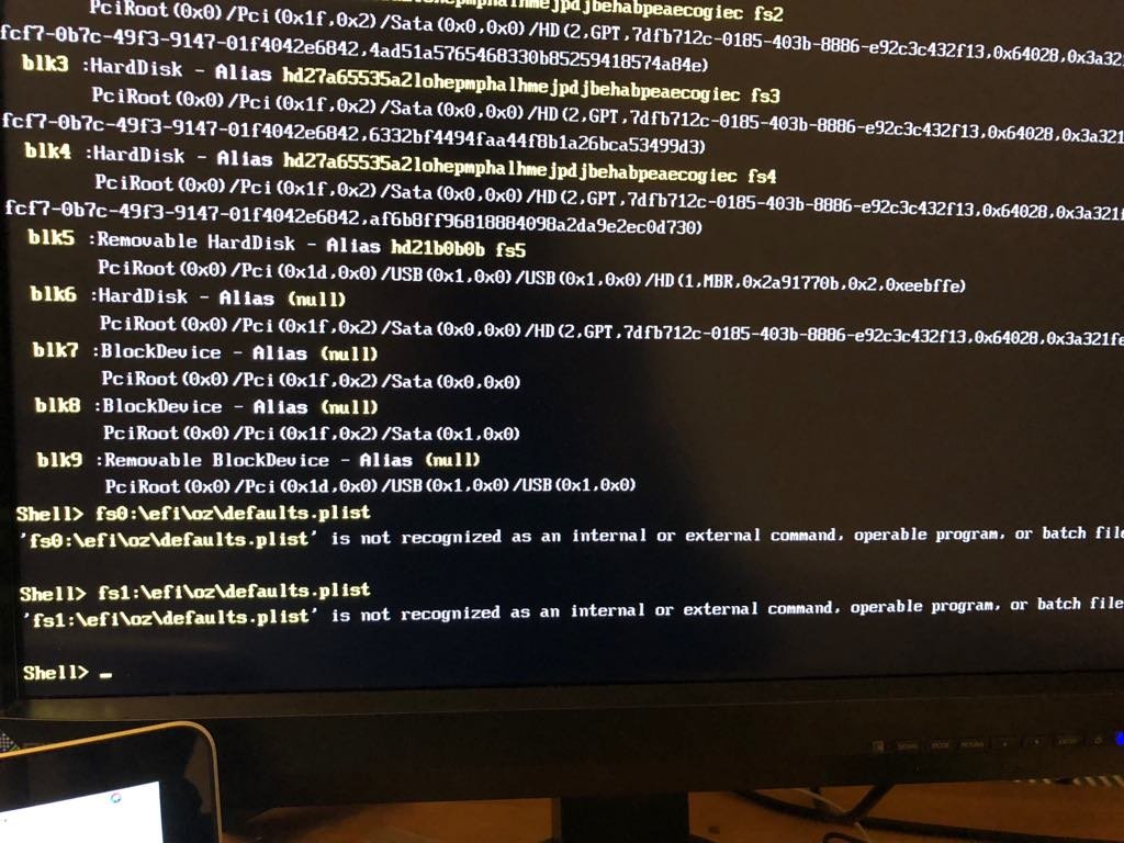

The firmware (whatever version) will not list a APFS partition as boot unless you add it with bcfg.
Can you verify that you have Defaults.plist in fs0:\Efi\Oz\Defaults.plist
Plz provide a directory listing (ls) of all partition... if Clover sees it then it can be found by Ozmosis.

i checked
fs1:\Efi\Oz\Defaults.plist

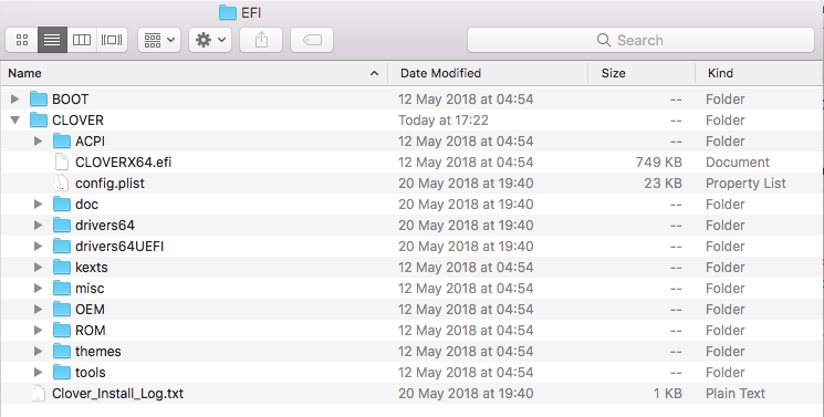

44950845_326214461499440_1336097667893166080_n.thumb.jpg.3414ab88fc32a68e69dffb4d52df5650.jpg
ive checked folders with my ssd on my other laptop and i cant find default.plist
You entered it as a command, it is not a command but a path ..and it should be on FS0:

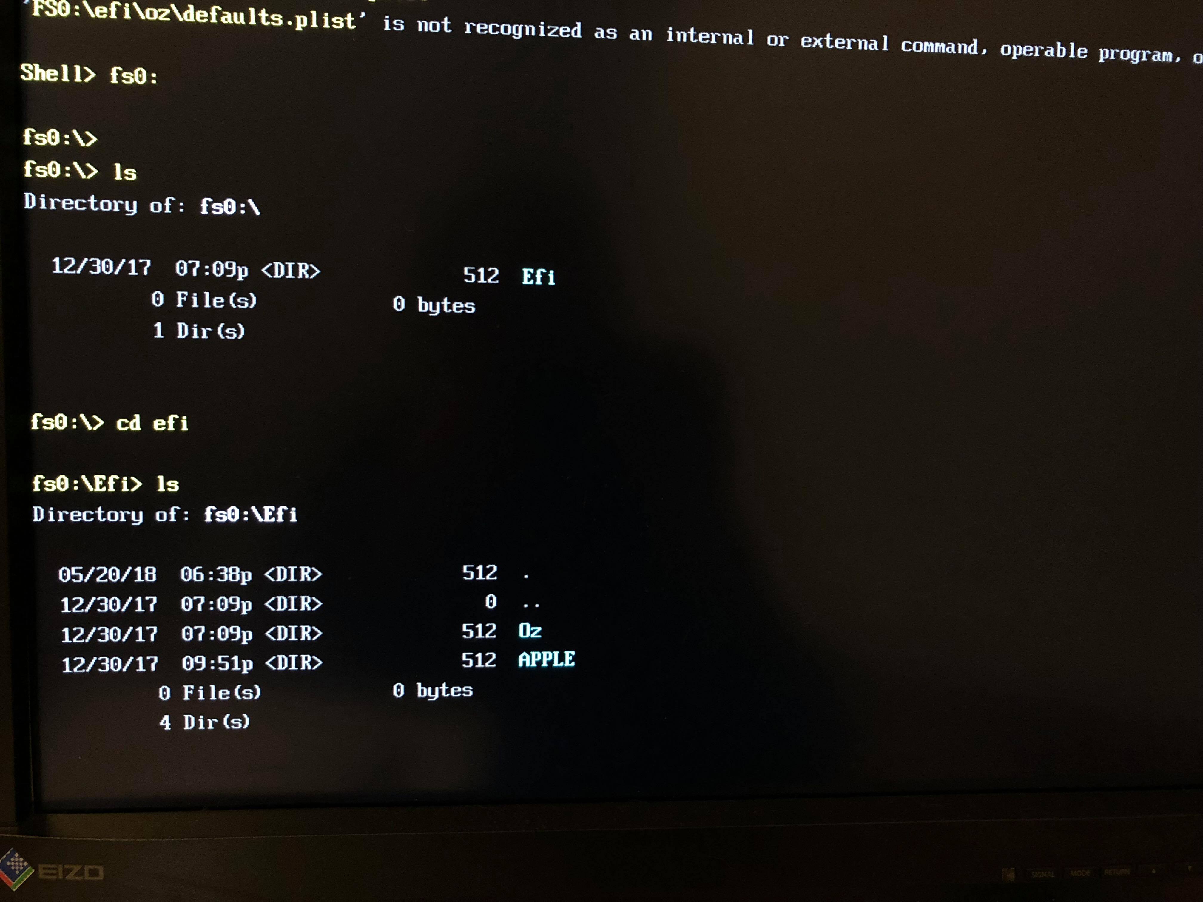

51 minutes ago, bezna said:
WTF ?? Clover should not even be there... Defaults.plist should be there in the Oz folder
Do this from EFI shell and provide output
fs0:
ls
cd Efi
ls
cd Oz
ls

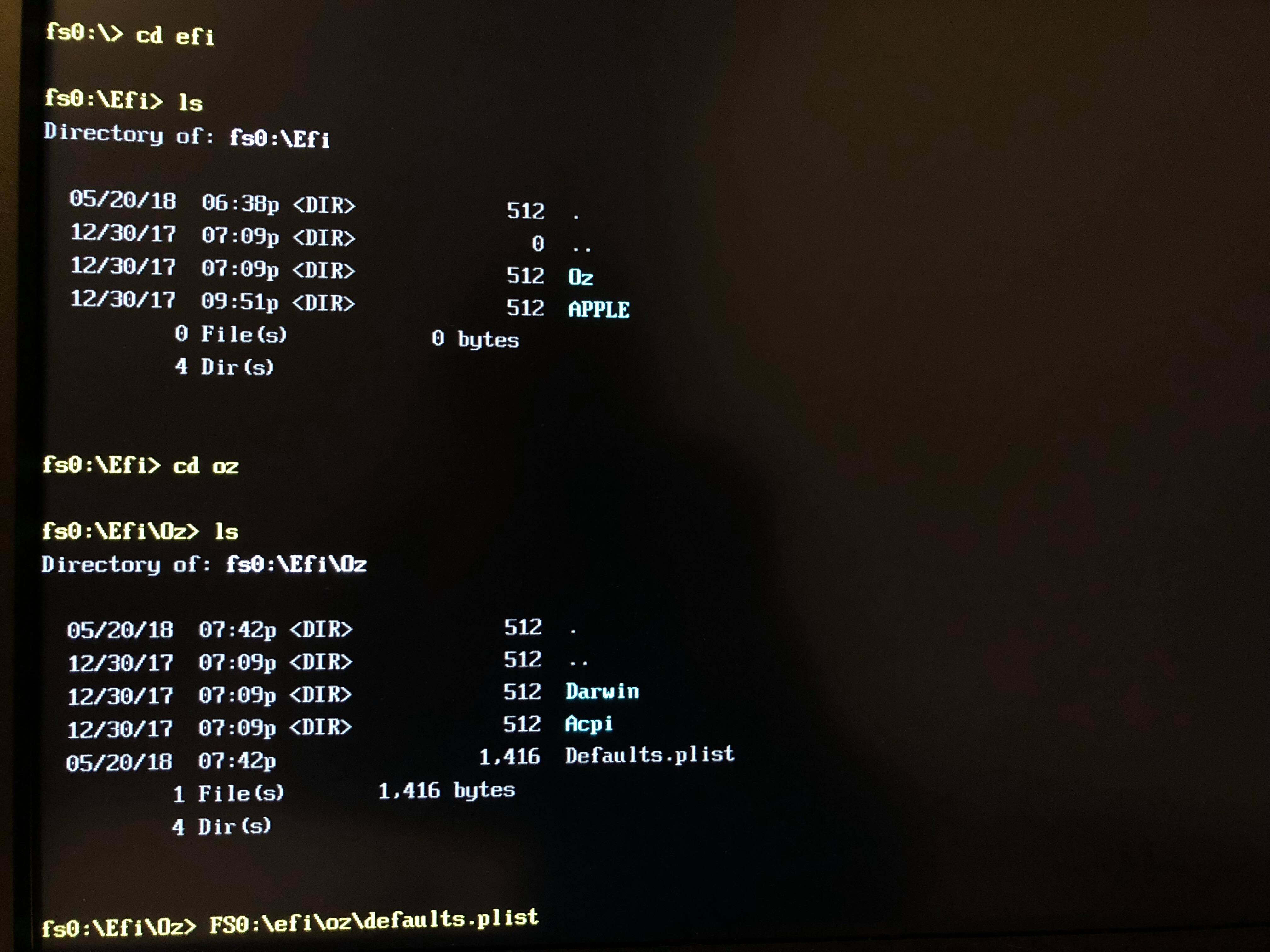

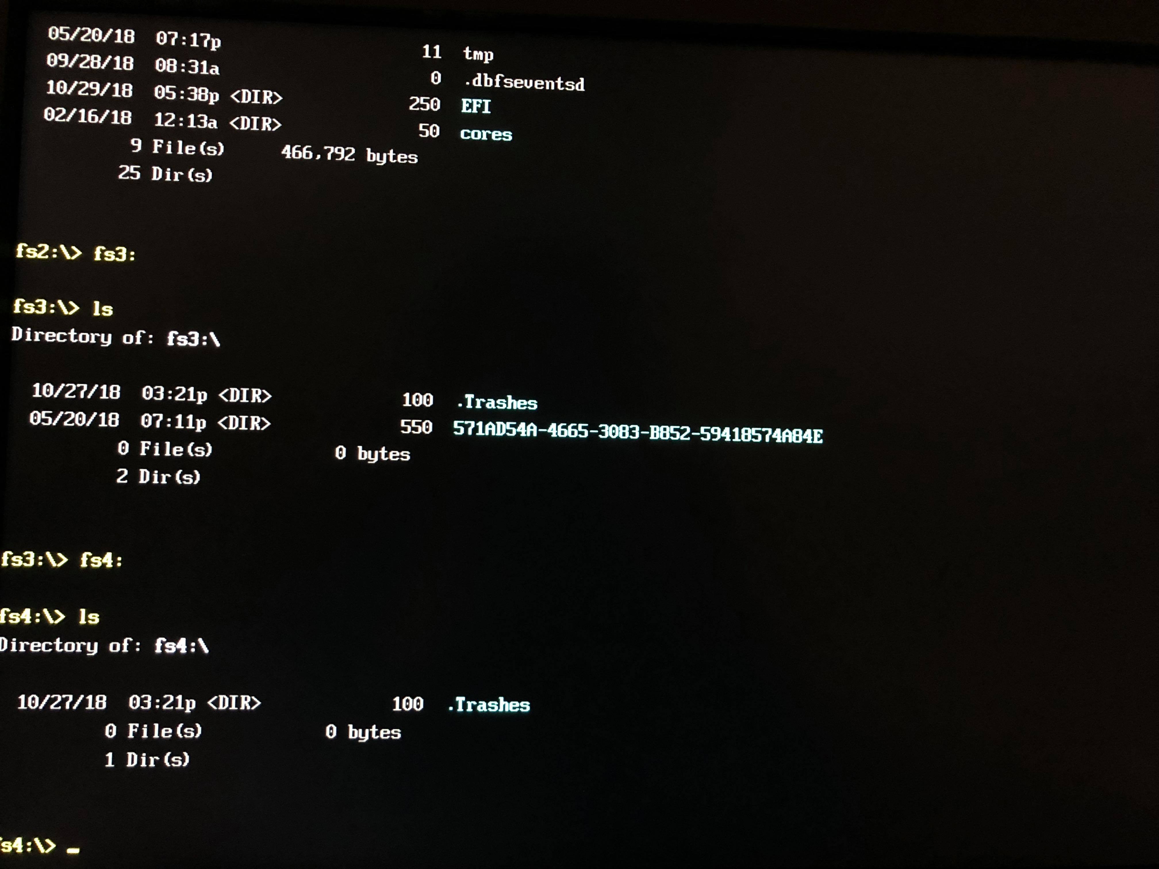

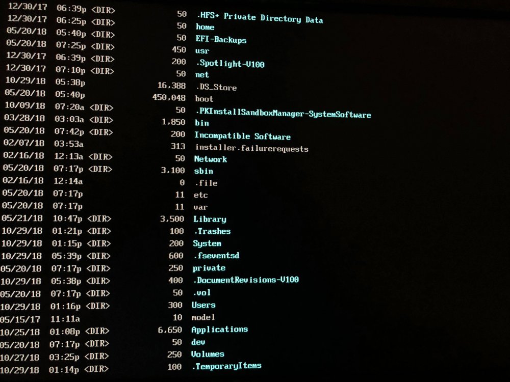

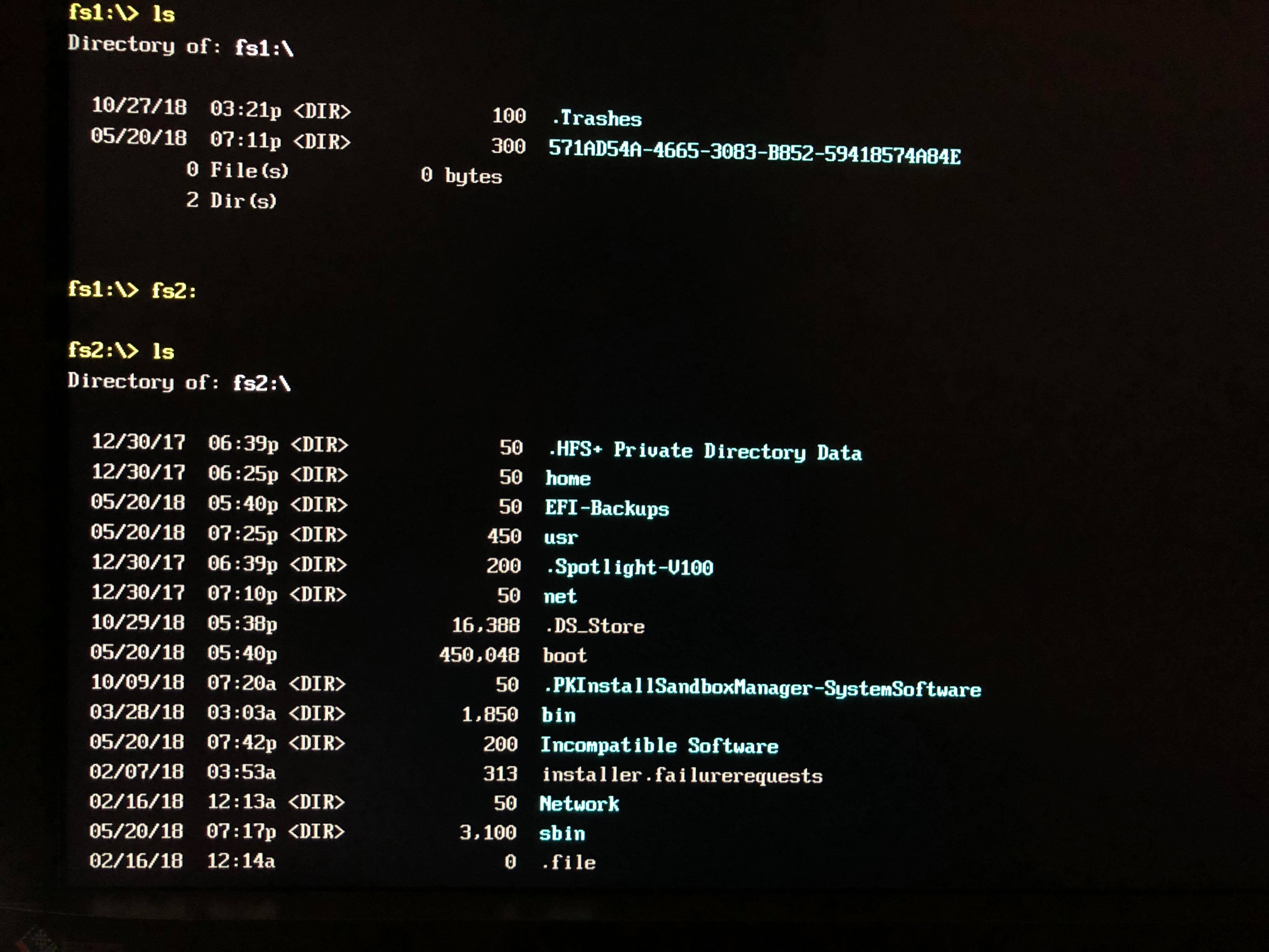

@IronManJFF
here u go
1.thumb.jpg.e529588a20709a8b9bc99376f8f66e38.jpg2.thumb.jpg.d589f3dbf3e650479b3c7f7efa363e04.jpg3.thumb.jpg.b16cd02defa0ae9942faa26f479bc05f.jpg4.thumb.jpg.6cf6cf614b32fa566f0acbf1e5c04d99.jpg

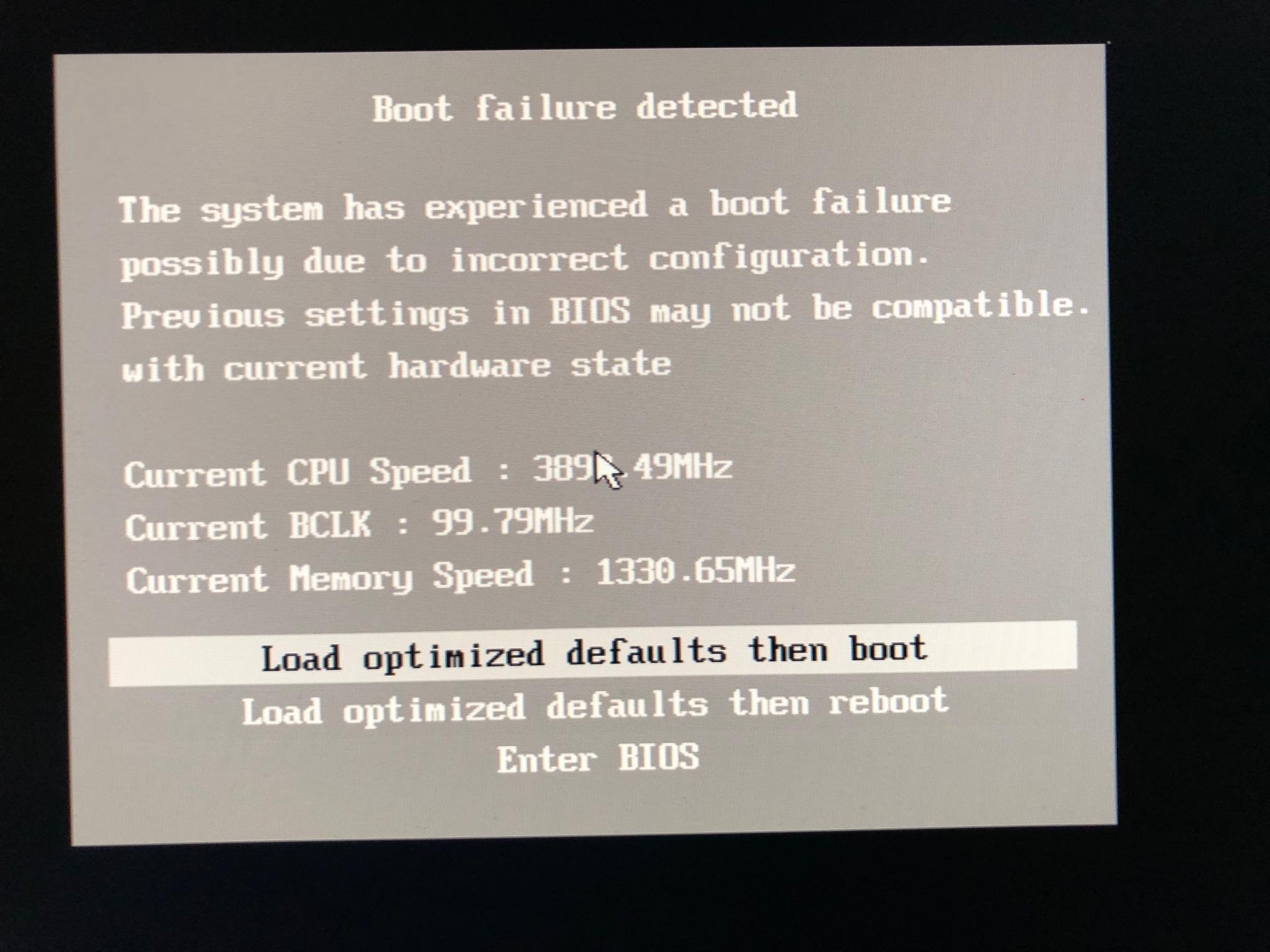

and sometimes i got this but i think it happend when i reset/turn off computer while its loading.
my cpu clock is 3.5ghz stock and for some reason its in turbo mode

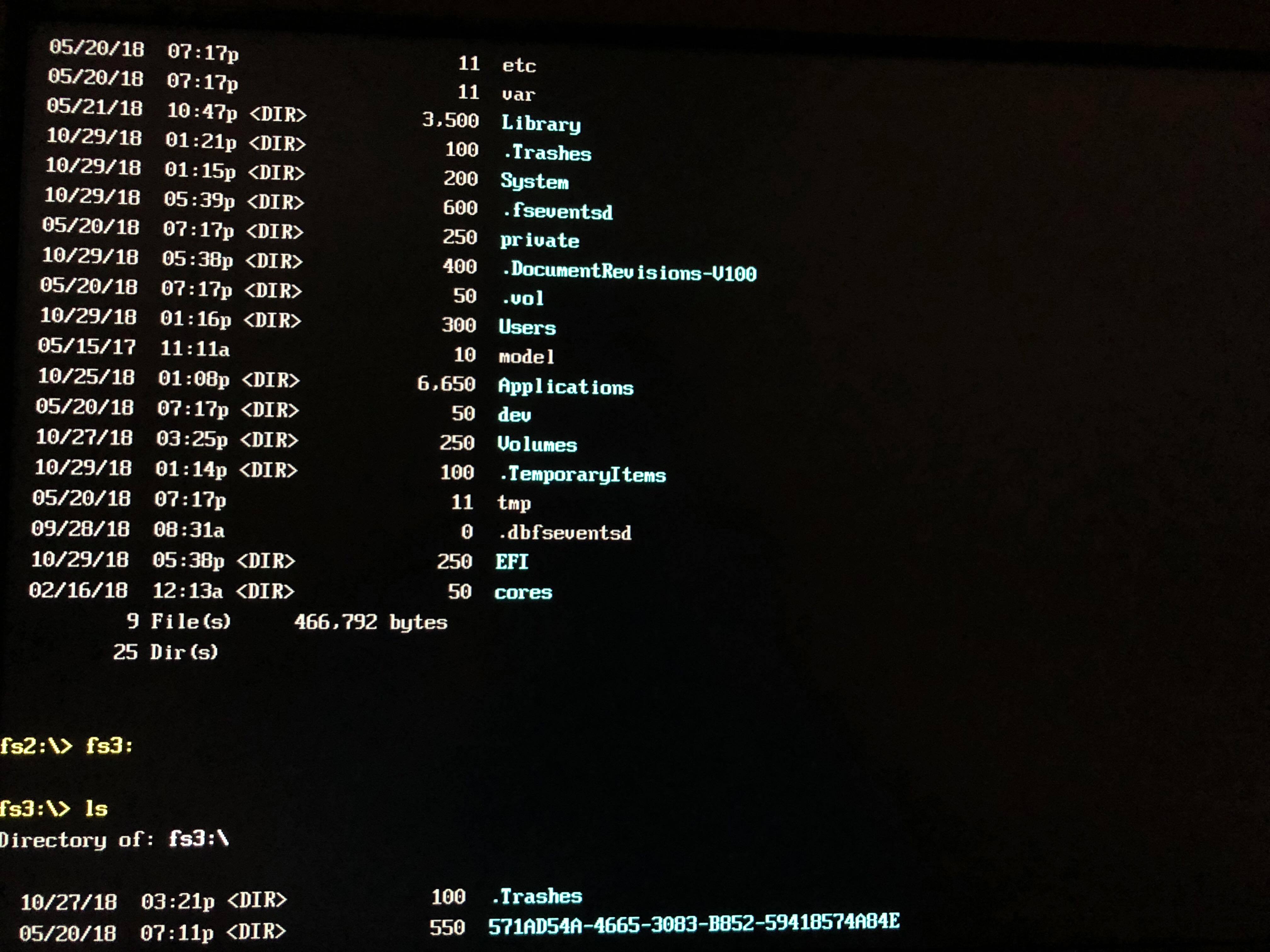

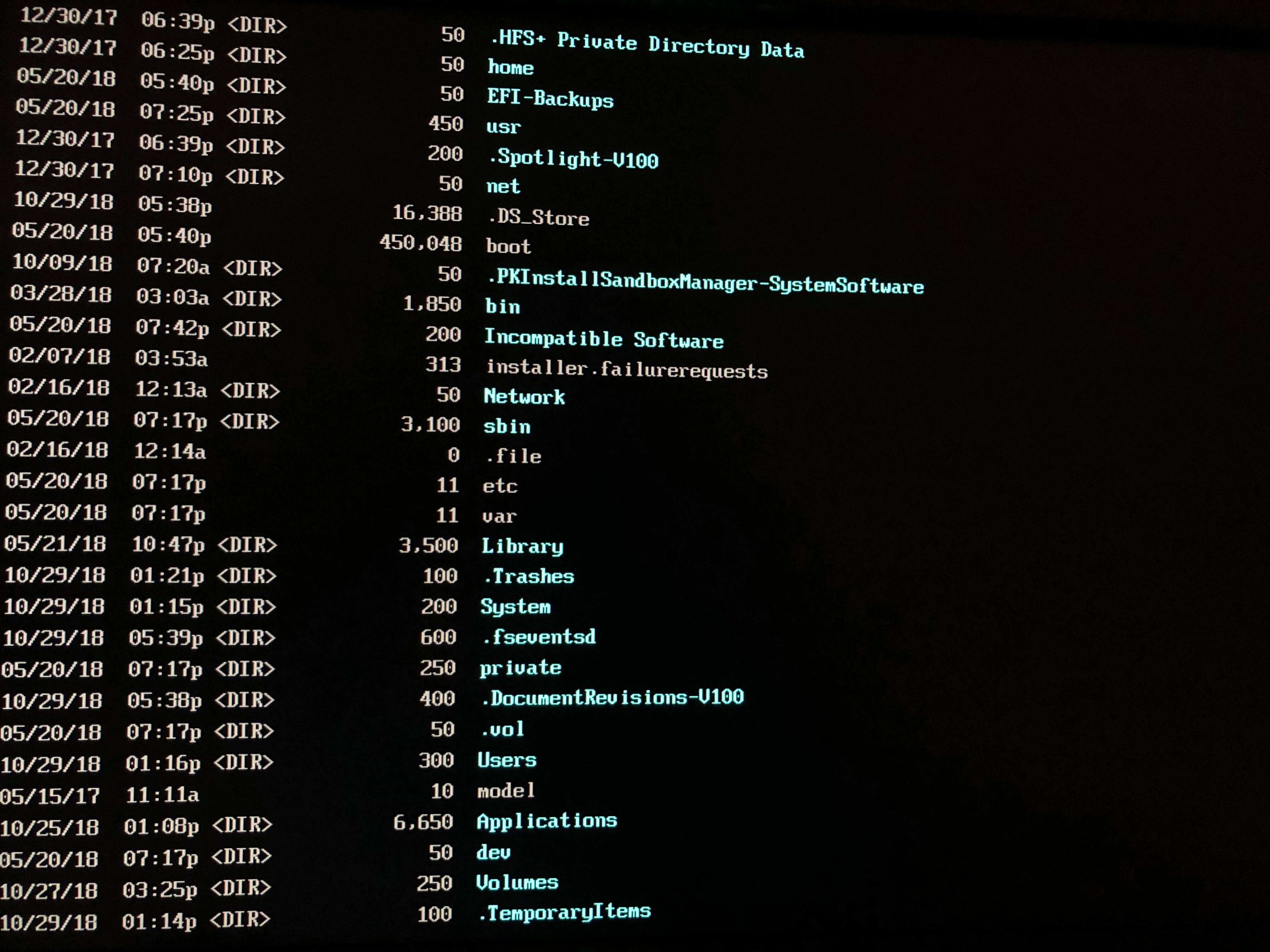

17 minutes ago, IronManJFF said:
In OS X, select your startup drive in system preferences.
Now that you know that your OS is on fs2: do the bcfg part from my previous post
how ? ;/
u mean this ?
Adding the new boot entry
Now issue theses commands (replacing italic by values we found earlier)
fsn:
bcfg boot addp highest number +1 System\Library\CoreServices\boot.efi "Name that you want to appear in F12 Menu"
You should get a message saying that the boot entry was added
Restart the system by issuing this command
reset
and go to F12 menu ..it should be there. Select it and it should boot you into High Sierra
The boot entry will persist until you do a nvram reset or flash a new ROM.
Edited by bezna
