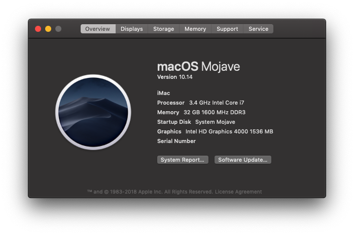

Mojave installed just fine on my board. After the installation I cloned a clean install over from the APFS partition to a Mac OS Extended (Journaled) disk then ran the migration assistant.
Now I wait patiently for Nvidia to catch up with those web drivers.

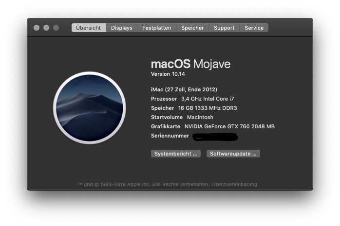

just tried today with Mojave on this board.
Installer runs fine but after reboot and final installation I get the error:
macOS could not be installed.
There is an error checking the firmware ...
might not be accurate error message as its German on my Mac.
Any idea?

Yup, did all that, it just failed to install Mojave over Sierra.
Funny part though: I upgraded to high sierra first THEN to Mojave and voila, it works.
Only thing that's not working is my WIFI-Card TL-WDN4800 N900 but thats no surprise it seems. Gonna find me the proper kext or just get a compatible one..
the bcfg procedure was necessary though to get it running after install, thanks a lot for the info found here!
P.S.: IO80211Family.kext worked for me, WiFi back up :-)

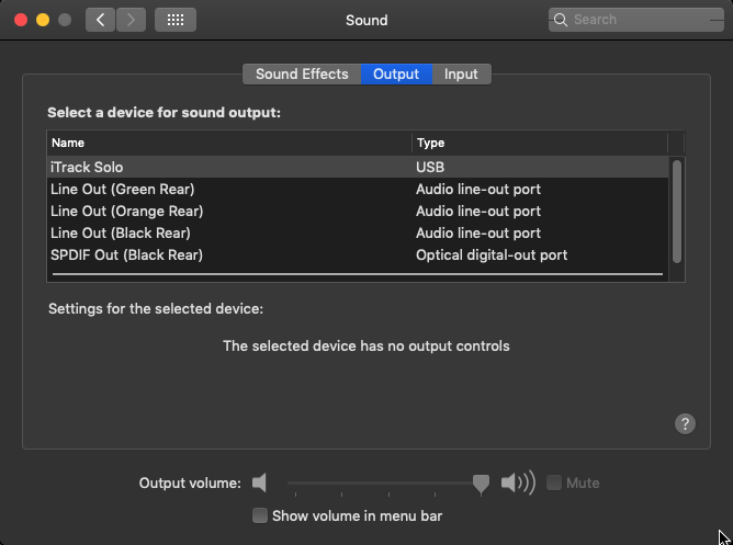

Many thanks to @IronManJFF, ,@Cecekpawon and @TypeThree for putting the BIOS together. Took the plunge to update my live system today, having installed an MSI ITX Aero RX560 graphics card. Everything working except sound (again). I'll stick with it, so if anyone has any ideas about getting sound working, I'd be grateful.
  • Thanks 1
1 hour ago, IronManJFF said:
Sound from the motherboard or from the RX560 ?
Motherboard. I use the optical s/pdif out into a DAC into a Sonos ZP90 into a modded Lepai 2020A amp. If I use the Line out (Green) directly to the amp I get a load of hiss that varies in volume as I move the BT mouse around.
Hi IronManJFF, thanks for checking. VoodooHDA is getting injected in the bdmesg output (below), which matches the HS output, and the Sound panel is essentially the same as yours. If I select the SPDIF output and then start iTunes, it immediately switches to a Line Out port. I'll order a USB to DAC device from Amazon and do what you're doing with the iTrack Solo, but cheaper!
I am seeing the same behavior in Mojave and High Sierra 10.13.6 and I think it it because the SPDIF port is defined at 44.8kHz and iTunes wants a 44.1Khz port .. so it reverts to the previously selected port .. in my case it goes to my iTrack Solo
