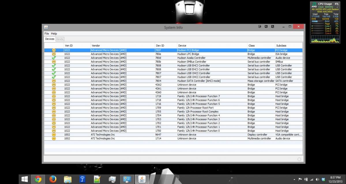

spakk Posted December 24, 2013 Share Posted December 24, 2013 (edited) I could not sleep and I have followed your dialogue first install SystemInfo on your main operating system, then launch the SystemInfo app tool, then you make the evaluation as a picture and upload the photo in here, then we can be sure which chipset is built into their hardware. based on the specifications from the manufacturer I can anything recognize. SystemInfo app toolhttp://www.osx86.net/files/file/2243-system-info/ Edited December 24, 2013 by spakk 2 Link to comment https://www.insanelymac.com/forum/topic/285760-help-topic-for-help-in-os-x-yosemite-1010-and-below/page/75/#findComment-1978433 Share on other sites More sharing options...
MrApocalypse Posted December 24, 2013 Share Posted December 24, 2013 Hmm I doubt its a NForce chipset but try this kext. If that doesn't work I will do a bit of research as thats the first time I've seen that happen. AppleNForceATA.kext.zip Nope, still didn't work. I could not sleep and I have followed your dialogue first install it on your main operating system, SystemInfo app tool, then launch the app, then you make the evaluation as a picture and upload the photo in here, then we can be sure which chipset is built into their hardware. based on the specifications from the manufacturer I can anything recognize. SystemInfo app tool http://www.osx86.net/files/file/2243-system-info/ Ok, attached the screenshot, and here is a link with the full specs of this laptop: http://h10025.www1.hp.com/ewfrf/wc/document?cc=us&lc=en&docname=c03349988 Also, don't lose sleep over this one. I have Mavericks on my rig, this is just icing on the cake. It would be nice if this could run Mavericks, but if not, it's cool. Thanks again for helping me guys. Link to comment https://www.insanelymac.com/forum/topic/285760-help-topic-for-help-in-os-x-yosemite-1010-and-below/page/75/#findComment-1978434 Share on other sites More sharing options...

spakk Posted December 24, 2013 Share Posted December 24, 2013 we need to customize your controller DEV ID and Vendor ID in the field IOPCIPrimaryMatch key> so that the controller is detected Link to comment https://www.insanelymac.com/forum/topic/285760-help-topic-for-help-in-os-x-yosemite-1010-and-below/page/75/#findComment-1978534 Share on other sites More sharing options...
