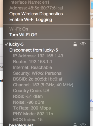

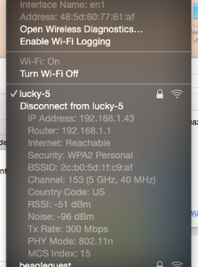

to be fair, it may be that Windows is over reporting the speed, to make the marketers happy, whereas mac reports the actual speed. A 2.4 GHz chip with 2 antennta has a theoretical maximum speed of 150 Mbps: http://en.wikipedia.org/wiki/Wireless_N#Data_rates. The chip spec claims that it is a 1x2 MIMO configuration with 300 Mbps max speed, so ???
Its true that wireless n is maxed at 150 per channel but a 2.4ghz card is only one band. Dual band uses 2.4 and 5 simultaneously hence the dual band. If you are using 1x2 or 1x3 you can get 300 or 450 all the way to 900 but now its unnecessary as ac can top that. So no, windows is not over reporting.
whether it can hit that speed is a good question.
it says connected at 300 Mbps on OS X (on 5 G) with my atheros card.
i have not benchmarked it!
i vaguely recall it reporting 450 on windows. but i could be wrong.

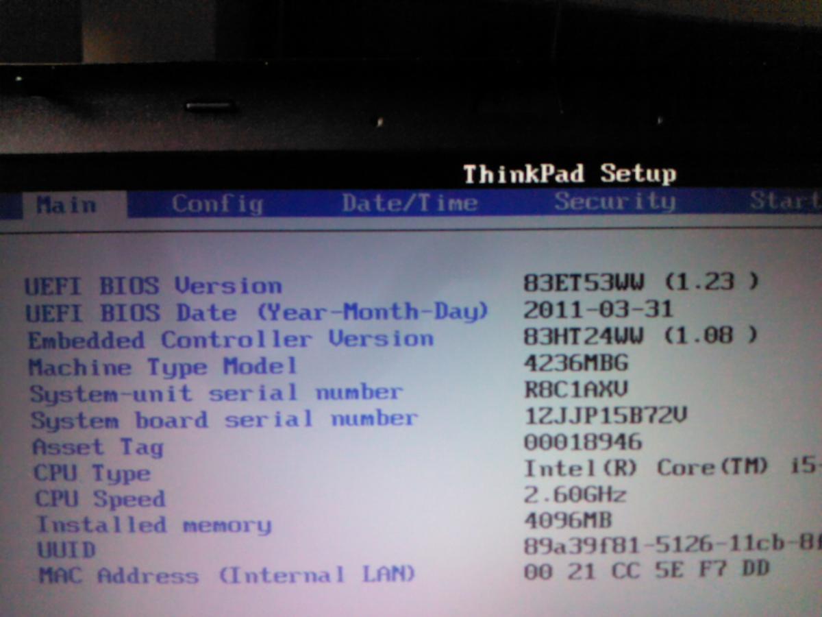

Hello.
I bought a T420 with i5 Cpu and only Intel HD3000 GPU
I need a Bios with Whitelist Removed to install a AR5B93 Wlan Card.
My Bios is UEFi Version 83ET53WW ( 1.23 )
Maschine Type 4236MBG
Its has a German Qwertz Keyboard.
My Question is:
I found some T420 Bioses with 1.46 and Wlan Whitelist removed.
Can i Flash any T420 Bios Files without Problems or exist different T420 with different Bios
I attached the Bios as Picture.
Thank you

@samsunlu55
well yes. many of us have done this without issue.
flash to real bios v1.46 and then flash with modded bios v1.46. (i did on my 2 boxes) see post #2036738 on this.

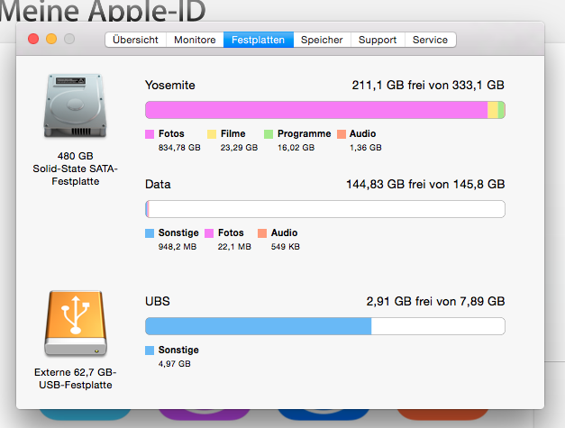

  2. @Cowboy Mike - i am getting the same (not accurate picture for my boot drive  (SSD) that shows inaccurate category amounts
