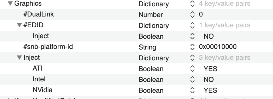

i diffed the config file recently posted and the one in my repo and i see the differences are all in the graphics section showing
- disable nvidia
- no EDID inject
- inject ATI and Inject Nvidia? why?
- why the extra boot arg -igfxnohdmi - (which is about sound patching)?
generally for 1600x900
- one needs to inject an alternate EDID - otherwise white screen, glitches and freezup are common problems.
- DualLink=1 required 1600x900 not 1366x768
$ diff -bw /opt/Extra/Systems/T420/Lenovo-T420-Clover/EFI/CLOVER/config.plist /Users/tluck/Downloads/config.plist
149c149
< <string>slide=0 -no_compat_check -lilubetaall -alcbeta -wegdbg amfi_get_out_of_my_way=0x1</string>
> <string>slide=0 -no_compat_check -lilubetaall -alcbeta -wegdbg amfi_get_out_of_my_way=0x1 nv_disable=1 -igfxnohdmi</string>
269,271c269,271
< <key>DualLink</key>
< <integer>1</integer>
< <key>EDID</key>
> <key>#DualLink</key>
> <integer>0</integer>
> <key>#EDID</key>
273,281d272
< <key>Comment</key>
< <string>LCD 1600x900</string>
< <key>Custom</key>
< <data>
< AP///////wAw5GYDAAAAAAAVAQSQHxF4AvxFlVhVkiggUFQAAAAB
< AQEBAQEBAQEBAQEBAQEBWC9A+GGEPDCgYDUANa4QAAAakB9A+GGE
< PDCgYDUANa4QAAAaAAAA/gAzTlBSNoAxNDBXRDIKAAAAAAAAQTGe
< ARAAAAIBCiAgAKc=
< </data>
283c274
< <true/>
> <false/>
286a278,279
> <key>ATI</key>
> <true/>
287a281,282
> <false/>
> <key>NVidia</key>
289a285,286
> <key>#snb-platform-id</key>
> <string>0x00010000</string>
Edited by tluck
