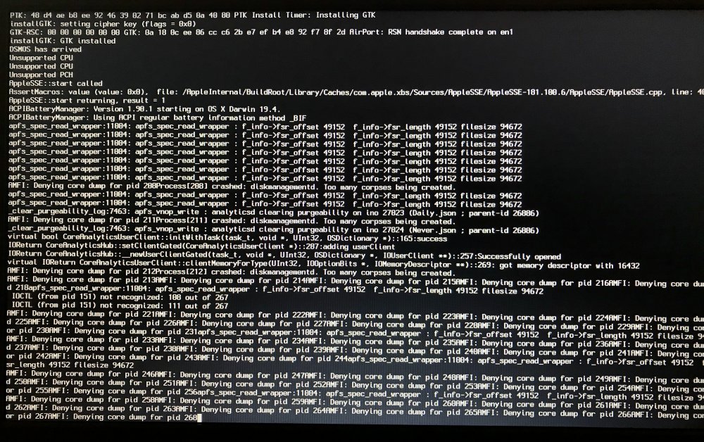

On 4/3/2020 at 4:54 AM, tluck said:
and if you are saying enabling the PID thing is important change SIP from whatever to this 0x3E7
turns on the bold items with these 10 bits
Default Disable SIP: 0x3E7 = 11 1110 0111
/* Rootless configuration flags */
#define CSR_ALLOW_UNTRUSTED_KEXTS       (1 << 0)
#define CSR_ALLOW_UNRESTRICTED_FS       (1 << 1)
#define CSR_ALLOW_TASK_FOR_PID          (1 << 2)
#define CSR_ALLOW_KERNEL_DEBUGGER       (1 << 3)
#define CSR_ALLOW_APPLE_INTERNAL        (1 << 4)
#define CSR_ALLOW_UNRESTRICTED_DTRACE   (1 << 5)
#define CSR_ALLOW_UNRESTRICTED_NVRAM    (1 << 6)
#define CSR_ALLOW_DEVICE_CONFIGURATION  (1 << 7)
#define CSR_ALLOW_ANY_RECOVERY_OS       (1 << 8)
#define CSR_ALLOW_UNAPPROVED_KEXTS      (1 << 9)
check: old was 0x3C3 = 11 1100 0011
$ nvram -p|sort
csr-active-config %e7%03%00%00
Hi @tluck , I've successfully upgraded to 10.15.5 and now, every time I boot I have the issue with the "denying core dump for PID" and it would get stuck at boot. Now, if I go to the settings of CLOVER, and change the parameter "System Parameters"-> "System Integrity Protection" -> "Allow Task for PID" it allows me to boot.
How can I make this change permanent?

1 hour ago, Sicole1811 said:
@tluck I'm just getting this on standard hdd and ssd. Don't know what to do with it
what is the issue exactly? denying core dump?
You had this comment some time ago, but I don't really understand what you are proposing to change here.
Could you please give me a hand?
Thanks!
put this in your config.plist
	<key>RtVariables</key>
	<dict>
		<key>BooterConfig</key>
		<string>0x28</string>
		<key>CsrActiveConfig</key>
		<string>0x3E7</string>
	</dict>
  • Thanks 1
	<dict>
	</dict>
Thanks a lot, it worked! Only the CsrActiveConfig string was different.
Here's a screenshot from this issue, while booting. It just hangs there successively "denying core dumps"
IMG_0089(Edited).thumb.jpg.722f426f6994079c1fa188b022b73dee.jpg.0f4a7ec483f698dda74bb37797f45326.jpg
Edited by freddie

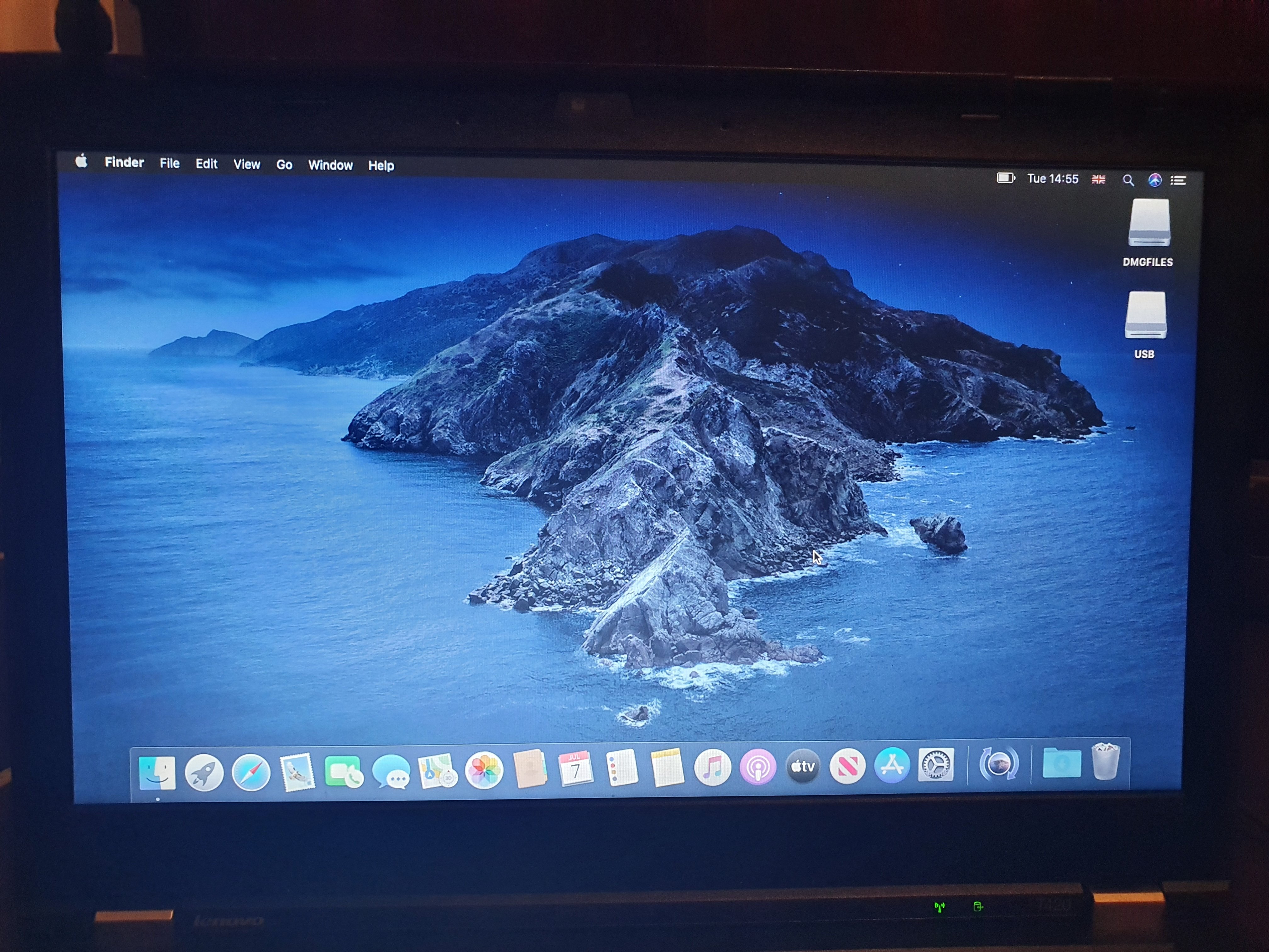

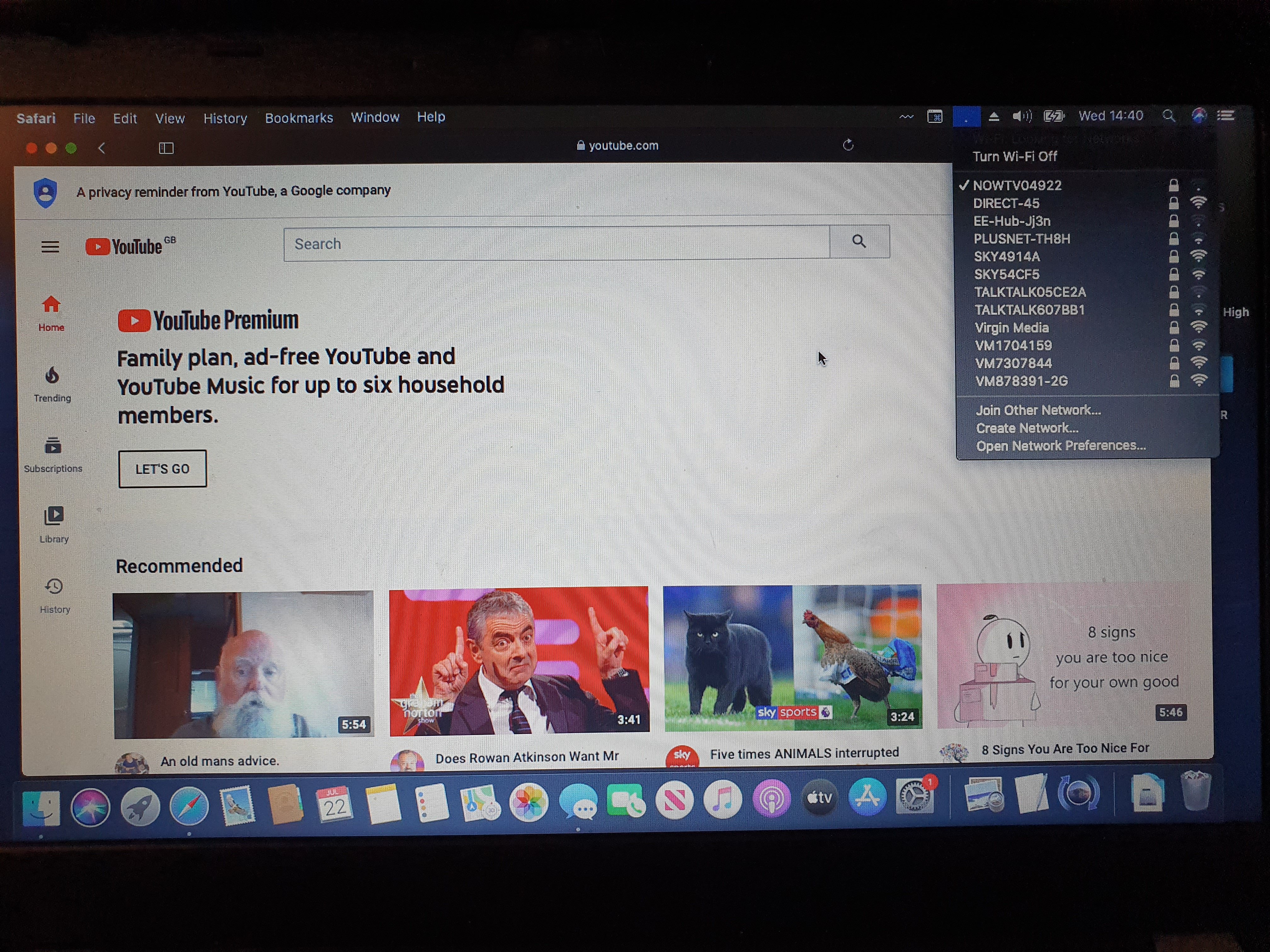

Anyhow. I decided to do the software update to Catalina 10.15.6, it worked which I was very surprised about but I did a post install which dosdude1 catalina patcher to be sure.
Even WiFi works which I've never achieved on previous catalina versions. 10.15.5 for me was sluggish on animations etc but this one seems so stable. Only issue I have is the WiFi signal bar doesn't work properly but Internet is working fine.
