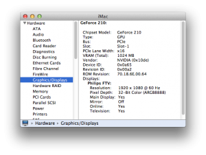

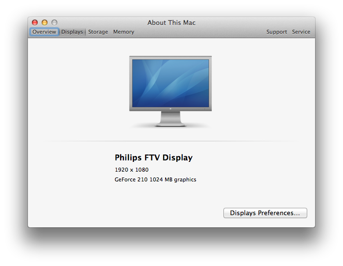

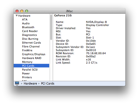

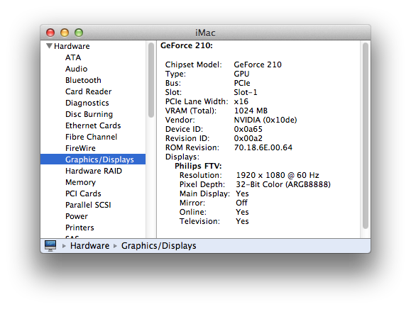

I did some experiences using nVidia kexts rollback both to 10.6.8's stock kexts and 10.7.5's.
With 10.6.8 nVidia stock kexts (i installed all of them, regardless if they are specifically for my G210 or not), i could boot without -x, but i got no QE/Ci, only native resolution (in my my case, 1080p). The System Information and System Report both reported my card correctly as a G210 1024MB, and told me the drivers were up and running, yet i had no graphics acceleration, much like as i boot in safe mode. Here's some pics:
With 10.7.5's stock kexts, my system boots straight to a white screen with the mouse pointer cursor frozen at the top left corner of the screen, plus a pin wheel spinning at the center of the screen (not to be confused with that rainbow colored Beach Ball of Death, this one is the same that appears on a white/blue screen when you start or shut down the system). Obviously no pics here.

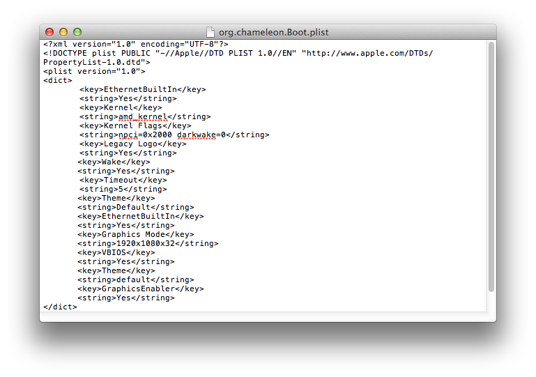

In both cases, i was using the latest amd_kernel from Andy Vandjick with this org.chameleon.Boot.plist:
One perhaps useful information: every time, with every kernel or kext set i used, that i tried to boot without GraphicsEnabler or with it set as "No", i boot straight to a black screen. That happened regardless i used safe boot (-x) or not (maybe the kernel or something else is not reacting properly to the boot flags at all, who knows?).
