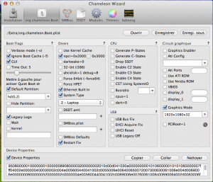

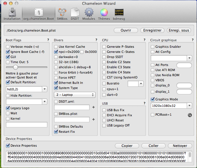

So I try with this EFI string and my internal screen is still black, the VGA screen turn light grey, and HDMI doesn't have any signal. So not better but it made something.
Just in case I'm doing some mistake, I put a screenshot of how I do the injection.
Thanks for your help.

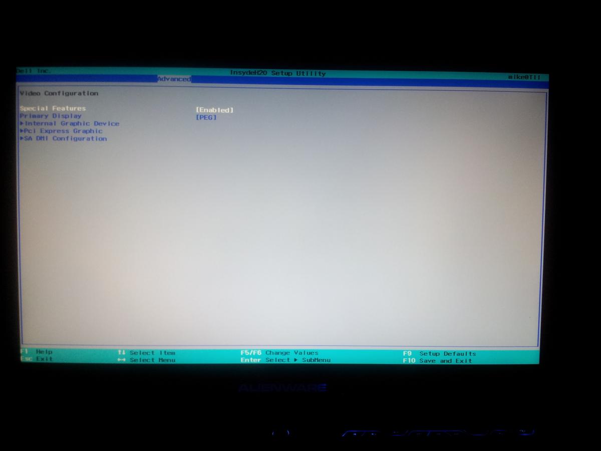

You got a lot options there, other laptops I had tried doesn't have all this options, ask what configurations does the people inside the forums I posted had, maybe is just that a Bios setting to correct.

There is a way for me to unlock my bios ? Where you made that ?
Hi.
Some Google research with "unlocked BIOS alienware m17x r4" will make the job. Most of the time, constructor make full BIOS for developping purpose and then lock it with only common option to avoid damage by end user. Some people remove this lock from official BIOS and you have to flash it using dos boot key. But be aware that this kind of BIOS is dangerous if you don't know what you are doing. Moreover, flasing eeprom is always risky as you make brick your computer.
