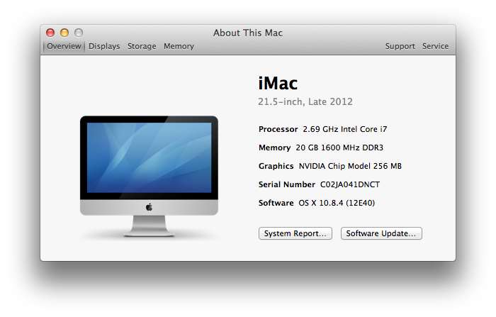

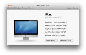

joshhh Posted June 5, 2013 Share Posted June 5, 2013 OKUntil last week I've got following possibilities of kepler stuck:- GPU difference with desktop versions- BIOS difference- VBIOS difference- DRIVERSWhat I've figured out on last weekDesktop card + OSX = WorkingMobile MXM card + OSX = Working - on Alienware and Clevo laptops Mobile keplers forks fine and in system BIOS there is no sing of GPU vbios. So card on mobile GPU is independent as desktop solutionMobile integrated card + OSX = Not WorkingSo we've got some differences in vbios and drivers. Our vbioses integrated as module of main laptop BIOS rom but in MacBooks it also integrated into main rom... and in macbooks it's working!ALSO in attachment vbioses from mobile MXM GTX680 (GK104) and GTX660M (GK107) from Dell/Alienware and Clevo laptopsMXM-vbios-keplers.zip @joshhh, @timpMaybe we can patch the binary of the NVDAResman.kext to make it work with our mobile kepler, if it works OOB with Desktop Kepler, maybe patching some bytes we can make it to work but we need collaborators, organization, distribution of the work and mainly Compromising MINDS.Interested people send mail here: iddpioneer_ymail.com - replace _ with @ 1 Link to comment https://www.insanelymac.com/forum/topic/284767-anyone-mobile-kepler-6xxm-working/page/4/#findComment-1919917 Share on other sites More sharing options...
