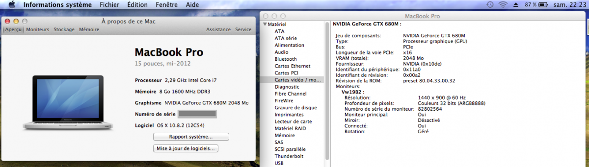

Pahcixam Posted August 22, 2013 Share Posted August 22, 2013 Hi ! I currently have an Alienware M17X R4 with an nVidia GTX680M. I also have the famous black screen on startup but it seems that OS X is still working in background. When I start with a VGA screen plug in, I can see my desktop with full hardware acceleration. With HDMI it hang on a grey screen. Both are not working if i plug them after startup. The interresting part was that I get the same comportement with Linux and the nVidia driver (not nouveau) until the release of the 325.15 version. My screen is connected to dfp-4 internaly and wasn't found at all by the nVidia driver but nouveau. I think your are right. The nvidia in the currently version available on OS X can't get the right infos from the screen. I will be happy to make some test if you have some time to help other people. For example, do you need Xorg log from my current Linux distro ? Thanks Link to comment https://www.insanelymac.com/forum/topic/284767-anyone-mobile-kepler-6xxm-working/page/5/#findComment-1940445 Share on other sites More sharing options...

Pahcixam Posted August 22, 2013 Share Posted August 22, 2013 Since you get full qe ci accel, it seems you problem is related to connector or display cfg, can you take an ioregistry save so I can give you an EFI String to test. Also your screen is 120hz? Is connected to the DP internally? I'm not at home until tomorow but yes I have a 120Hz screen. I'll try to make IOReg then. On Linux, on Xorg logs, it was cleary said that driver can't find any screen plugged in. Most of the people said that was because of the integrated card. But in my case, the Intel card is not compatible with 120 Hz screens. So the screen is directly plugged to the graphics card. Xorg now report DFP-4 as link to the screen with the new driver. Link to comment https://www.insanelymac.com/forum/topic/284767-anyone-mobile-kepler-6xxm-working/page/5/#findComment-1940639 Share on other sites More sharing options...

Pahcixam Posted August 24, 2013 Share Posted August 24, 2013 Hi ! I attached two files. The first one is a complete dump with IOReg and the second a screenshot showing details about my graphics card seen by OS X and my external monitor which is actually working. Thanks a lot. export.zip Link to comment https://www.insanelymac.com/forum/topic/284767-anyone-mobile-kepler-6xxm-working/page/5/#findComment-1941042 Share on other sites More sharing options...
AREOS Posted August 25, 2013 Share Posted August 25, 2013 Hi ! I attached two files. The first one is a complete dump with IOReg and the second a screenshot showing details about my graphics card seen by OS X and my external monitor which is actually working. Thanks a lot. I have seen you are using 10.8.2 official drivers, before trying some other method, first update to 10.8.4 and test with official drivers and if it does´t work try Nvidia Web drivers, this are known to be more detect port friendly. Also fix your Power management issues. Good luck Link to comment https://www.insanelymac.com/forum/topic/284767-anyone-mobile-kepler-6xxm-working/page/5/#findComment-1941104 Share on other sites More sharing options...

Pahcixam Posted August 26, 2013 Share Posted August 26, 2013 Hi ! Yes, in my case, I think my 120 Hz screen save me because of the incompatibility with Intel card. I update to 10.8.4 and install nVidia Web driver changing my smbios to MacPro. I can see that kext from web driver are loaded even if display pane doesn't show it. But my internal monitor is still black. Here is a new ioreg export. I hope we will make this work. Thanks for your help. export_10_8_4.zip Link to comment https://www.insanelymac.com/forum/topic/284767-anyone-mobile-kepler-6xxm-working/page/5/#findComment-1941392 Share on other sites More sharing options...
AREOS Posted August 26, 2013 Share Posted August 26, 2013 Ok then this is an EFI string to test, please try it out and report back with the result, also try HDMI maybe it will work. Good Luck This is what is injected in xml format <?xml version="1.0" encoding="UTF-8"?> <!DOCTYPE plist PUBLIC "-//Apple//DTD PLIST 1.0//EN" "http://www.apple.com/DTDs/PropertyList-1.0.dtd"> <plist version="1.0"> <dict> <key>PciRoot(0x0)/Pci(0x1,0x0)/Pci(0x0,0x0)</key> <dict> <key>@0,AAPL,boot-display</key> <string></string> <key>@0,NVDA,UnderscanMin</key> <string>0x00000052</string> <key>@0,built-in</key> <string></string> <key>@0,compatible</key> <string>NVDA,NVMac</string> <key>@0,connector-type</key> <string>0x00000402</string> <key>@0,device_type</key> <string>display</string> <key>@0,display-cfg</key> <string>0x00080403</string> <key>@0,fboffset</key> <string>0x00030000</string> <key>@0,name</key> <string>NVDA,Display-A</string> <key>@1,NVDA,UnderscanMin</key> <string>0x00000052</string> <key>@1,can-hot-plug</key> <string></string> <key>@1,compatible</key> <string>NVDA,NVMac</string> <key>@1,connector-type</key> <string>0x00000400</string> <key>@1,device_type</key> <string>display</string> <key>@1,display-cfg</key> <string>0xffffffff</string> <key>@1,name</key> <string>NVDA,Display-B</string> <key>@2,NVDA,UnderscanMin</key> <string>0x00000052</string> <key>@2,compatible</key> <string>NVDA,NVMac</string> <key>@2,connector-type</key> <string>0x00000400</string> <key>@2,device_type</key> <string>display</string> <key>@2,display-cfg</key> <string>0xffffffff</string> <key>@2,name</key> <string>NVDA,Display-C</string> <key>@3,NVDA,UnderscanMin</key> <string>0x00000052</string> <key>@3,compatible</key> <string>NVDA,NVMac</string> <key>@3,connector-type</key> <string>0x00000800</string> <key>@3,device_type</key> <string>display</string> <key>@3,display-cfg</key> <string>0xffffffff</string> <key>@3,name</key> <string>NVDA,Display-D</string> <key>AAPL00,DataJustify</key> <string>0x00000001</string> <key>AAPL00,Dither</key> <string>0x00000000</string> <key>AAPL00,DualLink</key> <string>0x00000001</string> <key>AAPL00,InverterFrequency</key> <string>0x00000000</string> <key>AAPL00,LinkFormat</key> <string>0x00000000</string> <key>AAPL00,LinkType</key> <string>0x00000000</string> <key>AAPL00,PixelFormat</key> <string>0x00000000</string> <key>AAPL00,T1</key> <string>0x00000000</string> <key>AAPL00,T2</key> <string>0x00000001</string> <key>AAPL00,T3</key> <string>0x000000c8</string> <key>AAPL00,T4</key> <string>0x000000c8</string> <key>AAPL00,T5</key> <string>0x00000001</string> <key>AAPL00,T6</key> <string>0x00000000</string> <key>AAPL00,T7</key> <string>0x00000190</string> <key>NVCAP</key> <data> BQEAAAAAAQAGAAAAAAAADwAAAAA= </data> <key>NVDA,invalid-config</key> <string>0x00000000</string> <key>VRAM,memvendorID</key> <string>0x0006</string> <key>VRAM,totalsize</key> <string>0x80000000</string> <key>built-in</key> <string>0x00</string> <key>device_type</key> <string>NVDA,Parent</string> <key>graphics-options</key> <string>0x0000000c</string> <key>model</key> <string>NVIDIA GeForce GTX 680M</string> </dict> </dict> </plist> and this is the EFI sring to try out. <950800000100000001000000890800003200000002010c00d041030a000000000101060000010101060000007fff04002e000000400030002c004e005600440041002c0055006e006400650072007300630061006e004d0069006e00000008000000520000002c0000004e005600440041002c0069006e00760061006c00690064002d0063006f006e006600690067000000080000000000000022000000400030002c0064006900730070006c00610079002d00630066006700000008000000030408002e000000400030002c004100410050004c002c0062006f006f0074002d0064006900730070006c006100790000000400000014000000400032002c006e0061006d0065000000120000004e5644412c446973706c61792d43260000005600520041004d002c006d0065006d00760065006e0064006f007200490044000000060000000600180000004100410050004c00300030002c0054003400000008000000c800000028000000400031002c0063006f006e006e006500630074006f0072002d0074007900700065000000080000000004000022000000400031002c006400650076006900630065005f00740079007000650000000b000000646973706c617914000000400030002c006e0061006d0065000000120000004e5644412c446973706c61792d4120000000400032002c0063006f006d00700061007400690062006c00650000000e0000004e5644412c4e564d616314000000400031002c006e0061006d0065000000120000004e5644412c446973706c61792d421c000000400030002c00660062006f00660066007300650074000000080000000000030022000000400032002c0064006900730070006c00610079002d00630066006700000008000000ffffffff160000006200750069006c0074002d0069006e000000050000000020000000400033002c0063006f006d00700061007400690062006c00650000000e0000004e5644412c4e564d61632e000000400032002c004e005600440041002c0055006e006400650072007300630061006e004d0069006e000000080000005200000022000000400033002c006400650076006900630065005f00740079007000650000000b000000646973706c61792a0000004100410050004c00300030002c0044006100740061004a0075007300740069006600790000000800000001000000180000004100410050004c00300030002c0054003300000008000000c800000024000000400031002c00630061006e002d0068006f0074002d0070006c0075006700000004000000180000004100410050004c00300030002c005400370000000800000090010000280000004100410050004c00300030002c004c0069006e006b0046006f0072006d00610074000000080000000000000028000000400032002c0063006f006e006e006500630074006f0072002d0074007900700065000000080000000004000022000000400030002c006400650076006900630065005f00740079007000650000000b000000646973706c6179180000004100410050004c00300030002c00540032000000080000000100000022000000400031002c0064006900730070006c00610079002d00630066006700000008000000ffffffff240000004100410050004c00300030002c004c0069006e006b0054007900700065000000080000000000000028000000400030002c0063006f006e006e006500630074006f0072002d0074007900700065000000080000000204000022000000400032002c006400650076006900630065005f00740079007000650000000b000000646973706c6179240000004100410050004c00300030002c004400750061006c004c0069006e006b0000000800000001000000180000004100410050004c00300030002c0054003600000008000000000000002e000000400031002c004e005600440041002c0055006e006400650072007300630061006e004d0069006e00000008000000520000001c0000006400650076006900630065005f00740079007000650000000f0000004e5644412c506172656e74100000006d006f00640065006c0000001b0000004e5649444941204765466f72636520475458203638304d220000005600520041004d002c0074006f00740061006c00730069007a00650000000800000000000080100000004e0056004300410050000000180000000501000000000100060000000000000f00000000180000004100410050004c00300030002c0054003100000008000000000000002a0000004100410050004c00300030002c0050006900780065006c0046006f0072006d00610074000000080000000000000020000000400030002c0063006f006d00700061007400690062006c00650000000e0000004e5644412c4e564d61631c000000400030002c006200750069006c0074002d0069006e00000004000000180000004100410050004c00300030002c00540035000000080000000100000022000000400033002c0064006900730070006c00610079002d00630066006700000008000000ffffffff360000004100410050004c00300030002c0049006e007600650072007400650072004600720065007100750065006e0063007900000008000000000000002e000000400033002c004e005600440041002c0055006e006400650072007300630061006e004d0069006e000000080000005200000014000000400033002c006e0061006d0065000000120000004e5644412c446973706c61792d4420000000400031002c0063006f006d00700061007400690062006c00650000000e0000004e5644412c4e564d6163200000004100410050004c00300030002c004400690074006800650072000000080000000000000028000000400033002c0063006f006e006e006500630074006f0072002d0074007900700065000000080000000008000026000000670072006100700068006900630073002d006f007000740069006f006e0073000000080000000c000000> Link to comment https://www.insanelymac.com/forum/topic/284767-anyone-mobile-kepler-6xxm-working/page/5/#findComment-1941443 Share on other sites More sharing options...
