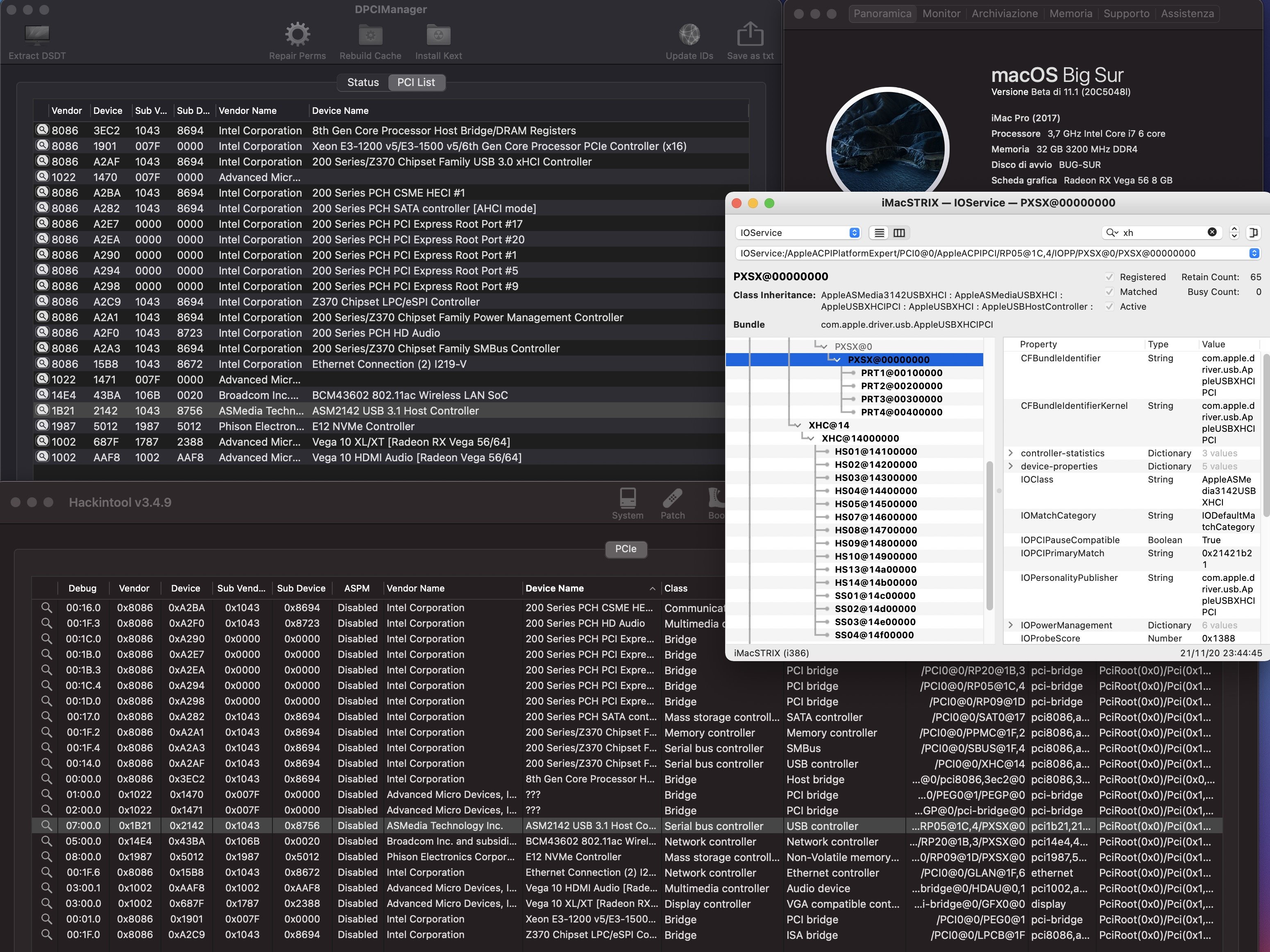

iCanaro Posted November 21, 2020 Share Posted November 21, 2020 to me it comes to think that it is more a problem of your PCI card in combination with the motherboard, have you tried to change pci slots where inserted? On my Z370 is a built-in chip on the motherboard and on big sur it is properly recognized from ioreg on big sur works with the driver asmedia 3142 but in reality it's 2142 2 1 Link to comment https://www.insanelymac.com/forum/topic/284656-clover-general-discussion/page/999/#findComment-2745068 Share on other sites More sharing options...
yapan4 Posted November 22, 2020 Share Posted November 22, 2020 (edited) Hi, all. Now Clover is stable and is used as the main bootloader to install macOS and to run an already installed system. Thank you developers and all for assist. But x299 and c422 users have a problem. I'm not sure if this is Clover's problem, because Open Core users also report the same or similar problem. There are also isolated reports from other chipsets but mostly it's the x299 and my c422 machine. This is a stop on a black screen with a thick horizontal cursor and POST code 97 after reboot. The reset button does not help. Only the power button helps. Problem has been present steadily since Clover version 5123 - 5124 (exactly unknown) and on the Big Sur betas and release. Apeares after the user, bootloader or system has made any changes to the NVRAM (my guesses). Hope somebody known solution. Or need developers intervention? Thank You and sorry my google translated English. yapan4_C422_EFI.zip yapan4_C422_debug.log Edited November 22, 2020 by yapan4 1 Link to comment https://www.insanelymac.com/forum/topic/284656-clover-general-discussion/page/999/#findComment-2745090 Share on other sites More sharing options...
jlrycm Posted November 22, 2020 Share Posted November 22, 2020 13 hours ago, iCanaro said: to me it comes to think that it is more a problem of your PCI card in combination with the motherboard, have you tried to change pci slots where inserted? On my Z370 is a built-in chip on the motherboard and on big sur it is properly recognized from ioreg on big sur works with the driver asmedia 3142 but in reality it's 2142 @iCanaro, thanks for your feedback. Unfortunately I only have one PCIEX4 slot available for this card. I ordered a Startech card which uses the ASMEDIA 3142 and claims to be supported in Big Sur. 2 Link to comment https://www.insanelymac.com/forum/topic/284656-clover-general-discussion/page/999/#findComment-2745095 Share on other sites More sharing options...

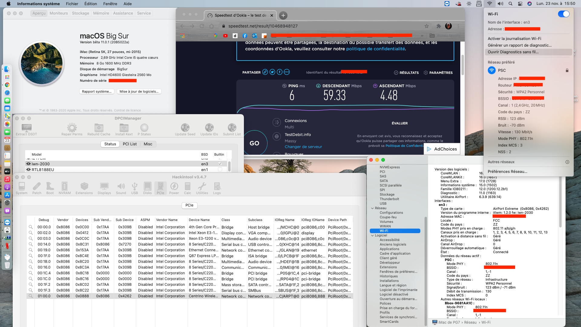

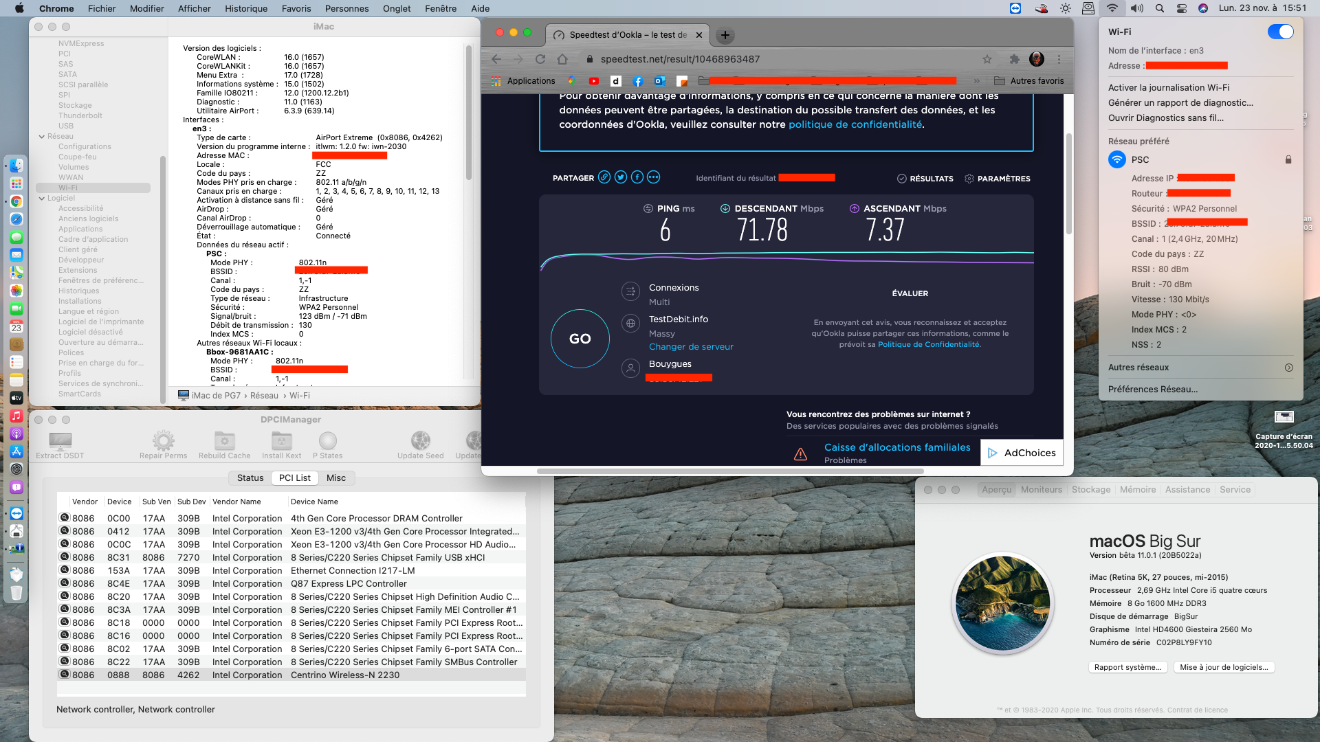

Matgen84 Posted November 23, 2020 Share Posted November 23, 2020 27 minutes ago, PG7 said: leave here the link of the kext intel here Thanks I test this alpha version with Clover r5126 (Other folder): the kext is well injected via Clover, but it's unstable in ac wifi connection (Intel 9560), and above all we cannot change the country code (ZZ to FR) Wait and see. Link to comment https://www.insanelymac.com/forum/topic/284656-clover-general-discussion/page/999/#findComment-2745216 Share on other sites More sharing options...
PG7 Posted November 23, 2020 Share Posted November 23, 2020 1 hour ago, Matgen84 said: Thanks I test this alpha version with Clover r5126 (Other folder): the kext is well injected via Clover, but it's unstable in ac wifi connection (Intel 9560), and above all we cannot change the country code (ZZ to FR) Wait and see. good afternoon - test with this Kext to see if it is more stable as for the region I can't help! - here I am using it even if the region is not in FR but in ZZ I have no problems or stability! https://we.tl/t-bjfRLgq0xx Link to comment https://www.insanelymac.com/forum/topic/284656-clover-general-discussion/page/999/#findComment-2745221 Share on other sites More sharing options...
kushwavez Posted November 23, 2020 Share Posted November 23, 2020 1 hour ago, Matgen84 said: Thanks I test this alpha version with Clover r5126 (Other folder): the kext is well injected via Clover, but it's unstable in ac wifi connection (Intel 9560), and above all we cannot change the country code (ZZ to FR) Wait and see. I just tried itlwm with an Intel AC-7260 to see if it's improved or not, it's good for light browsing, but nothing else really at this state. I barely hit 7 MB/s speed on 5 GHz, that normally would be like ~80 MB/s. I also had some very annoying bug when using it with OpenCore, after booting to Windows the wifi cannot be launched and used (error code: 10). Even a CMOS reset couldn't help! The only way to get it working again was to boot with Clover (or delete OC and boot with Windows loader)...strange! I opened a bug report but they said it's a problem with OC. Well, nice work anyway, not gonna lie. Link to comment https://www.insanelymac.com/forum/topic/284656-clover-general-discussion/page/999/#findComment-2745223 Share on other sites More sharing options...

Matgen84 Posted November 23, 2020 Share Posted November 23, 2020 4 minutes ago, PG7 said: good afternoon - test with this Kext to see if it is more stable as for the region I can't help! - here I am using it even if the region is not in FR but in ZZ I have no problems or stability! https://we.tl/t-bjfRLgq0xx Thanks again I talked stability for wifi ac 5GHZ/80Mhz only. 3 minutes ago, matxpa said: Intel Wifi AC9560 --> https://github.com/AppleIntelWifi/adapter This repo is archived. Now the good one, is OpenIntelWireless 2 1 Link to comment https://www.insanelymac.com/forum/topic/284656-clover-general-discussion/page/999/#findComment-2745228 Share on other sites More sharing options...
