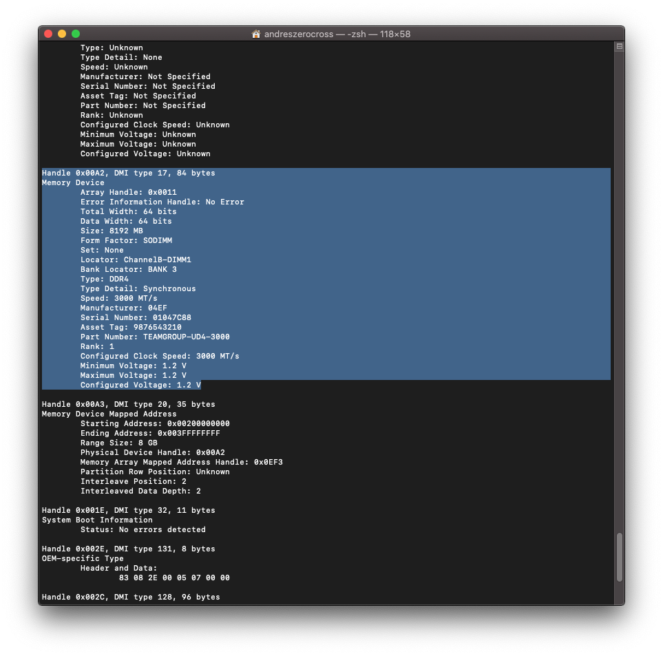

16 hours ago, Pene said:
Following this problem, I have narrowed it down to the rank of DIMMs used.
This error appears during install when he is trying to install with Single-Rank DIMMs (2x8GB).
The error does not appear, and he can install successfully, when trying to install with Dual-Rank DIMMs (also 2x8GB).
The memory rank information appears in SMBIOS, at Type17->Attributes (0Bh), maybe it needs to be taken into consideration for something? (currently we are not doing anything with it within Clover)
It still baffles me though how it can affect the installer to give this error. Also, if the Single-Rank DIMMs are put back after macOS is already installed, everything seems to be functioning properly.

Hi Slice,
Thank you for the response. But I think I didn't explain myself well.
0Bh is the location of of the "Attributes", not it's content.
The content is newSmbiosTable.Type17->Attributes = 1 in case of Single-Rank DIMMs and newSmbiosTable.Type17->Attributes = 2 in case of Dual-Rank DIMMs.
But this information is *already present* in SMBIOS, without us doing anything special in Clover.
He sent me two dmidecodes from a booted Mac, for each case, with the different DIMMs installed. Look:
This is the non-working case with the Single-Rank DIMMS: (notice the RANK: 1, it is present in smbios and read from the Attributes address at 0Bh):
Handle 0x1101, DMI type 17, 40 bytes
Memory Device
	Array Handle: 0x1000
	Error Information Handle: No Error
	Total Width: 64 bits
	Data Width: 64 bits
	Form Factor: DIMM
	Set: 1
	Locator: DIMM0
	Bank Locator: BANK 1
	Type: DDR4
	Type Detail: Synchronous Unbuffered (Unregistered)
	Speed: 2998 MT/s
	Manufacturer: Corsair
	Serial Number: 0000000000000000
	Asset Tag: Not Specified
	Part Number: CMW16GX4M2C3000C15
	Rank: 1
	Configured Clock Speed: 2133 MT/s
	Minimum Voltage: 1.2 V
	Maximum Voltage: 1.2 V
	Configured Voltage: 1.2 V
And this is the non-working case with the Dual-Rank DIMMS: (notice the RANK: 2, it is present in smbios and read from the Attributes address at 0Bh):
Handle 0x1100, DMI type 17, 40 bytes
Memory Device
	Data Width: 64 bits
	Form Factor: DIMM
	Set: 1
	Locator: DIMM0
	Bank Locator: BANK 0
	Type: DDR4
	Speed: 3200 MT/s
	Manufacturer: G Skill Intl
	Part Number: F4-3200C16-8GTZB
	Rank: 2
This is the only real difference between the chips.
He has two pairs of chips that it is working OK for install with them (one pair is 2x8GB - GSKILL the other is 2x16GB - CORSAIR). Both of these are working OK for install and both are with "Rank: 2".
He has only one pair with "Rank: 1" (they are more rare I think), but install keeps giving the error with them in all cases, also if using only a single DIMM, also when using both DIMMs.
I don't know what we should be doing with this information, I was mentioning it as maybe together we can understand what is going on here...
I tried, on my system, to add:
newSmbiosTable.Attributes = 1
Just to see if it makes me also get the error (as my Rank also was 2) - but the error did not appear on my System (I don't actually have single-rank DIMMs to test with them, so I tried only to fake the rank).
There are many reports on the net (at other sites) about this issue, no one mentioned the Rank, but in most cases it was closed by using other DIMMs or moving the DIMMs in other slots (on boards that have more slots). So this is a memory issue, and in my opinion is is somehow related to the Rank.
  • Thanks 1
My computer reported
0000: 11 28 00 11 00 10 ff ff ff ff ff ff 00 00 09 01
0010: 01 02 00 80 00 00 00 00 00 00 00 00 00 00 00 00
0020: 00 00 00 00 00 00 00 00
Memory Device
	Total Width: Unknown
	Data Width: Unknown
	Size: No Module Installed
	Form Factor: DIMM
	Set: 1
	Locator: DIMM0
	Type: <OUT OF SPEC>
	Speed: Unknown
	Manufacturer: Not Specified
	Serial Number: Not Specified
	Part Number: Not Specified
	Rank: Unknown
	Configured Clock Speed: Unknown
	Minimum voltage:  Unknown
	Maximum voltage:  Unknown
	Configured voltage:  Unknown
So why I have similar problem?
It was empty slot.
Occupied slot has info
Handle 0x1103, DMI type 17, 40 bytes
0000: 11 28 03 11 00 10 ff ff 40 00 40 00 00 10 09 02
0010: 01 02 1a 80 00 55 08 03 04 00 06 01 00 00 00 00
0020: 55 08 b0 04 b0 04 b0 04
Memory Device
	Data Width: 64 bits
	Form Factor: DIMM
	Set: 2
	Locator: DIMM1
	Type: <OUT OF SPEC>
	Speed: 2133 MHz (0.5 ns)
	Manufacturer: 0000
	Part Number: unknown
	Rank: 1
	Configured Clock Speed: 2133 MHz (0.5 ns)
	Minimum voltage:  1.200 V
	Maximum voltage:  1.200 V
	Configured voltage:  1.200 V
There is Rank=1, and there is Type <OUT OF SPEC>. I think Apple doesn't like wrong field in Smbios. We should somehow fill them.
It was empty slot.
Is this the computer that gives you similar error in install (by the way, is it the exact same message?) Does the error reproduce when you run an installation? If yes maybe it really is the same problem with single rank.
Also, I can't be sure that it will happen in all cases with Rank=1, it may depend also on placement in slots, or other factors.
But in his case information is correct in smbios. He really has single-rank ram memory in both slots and it is reported accordingly.
Edited by Pene
Yes, it is this computer.
I got this error updating 10.14.3 to 10.14.6, while clean installation of 10.14.6 was successful.
Strange that the error was checked only by installer. Final OS works.
Also strange my way to resolve the problem: boot by legacy Clover. It is not using AptioFix and this is the difference related to memory.
It's a pity we have no reproducible tests.
  • Thanks 1
  • Sad 1

What is your memory rank in dmidecode -t 17?
Also, your error is the exact one that my friend is reporing?
Hi Pene,
I see real iMac18,3 also has Rank=1

What is the size of your DIMM? Before my latest commit there was a problem with 32Gb modules. Ticket 595.

The dimm where install fails is a rank1 8gb x2 chips each (Corsair, total 16gb)
Install was ok with rank 2 8gb x2 chips (Gskill, total 16gb)
And also was ok on with rank 2 16gb x2 chips  (Corsair, total 32gb)
That's why I thought it is probably related to rank, as there was no other major difference between the chips where it worked and failed. Same size also as you see.
He was using iMac19,2 model.
Edited by Pene
3 hours ago, Andres ZeroCross said:
I have rank 1,,  Memory model and frequency in my signature. No problem fresh Install Mojave and Catalina
So it must not be (olny) it. But it would be good if we got to the bottom of this.
