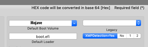

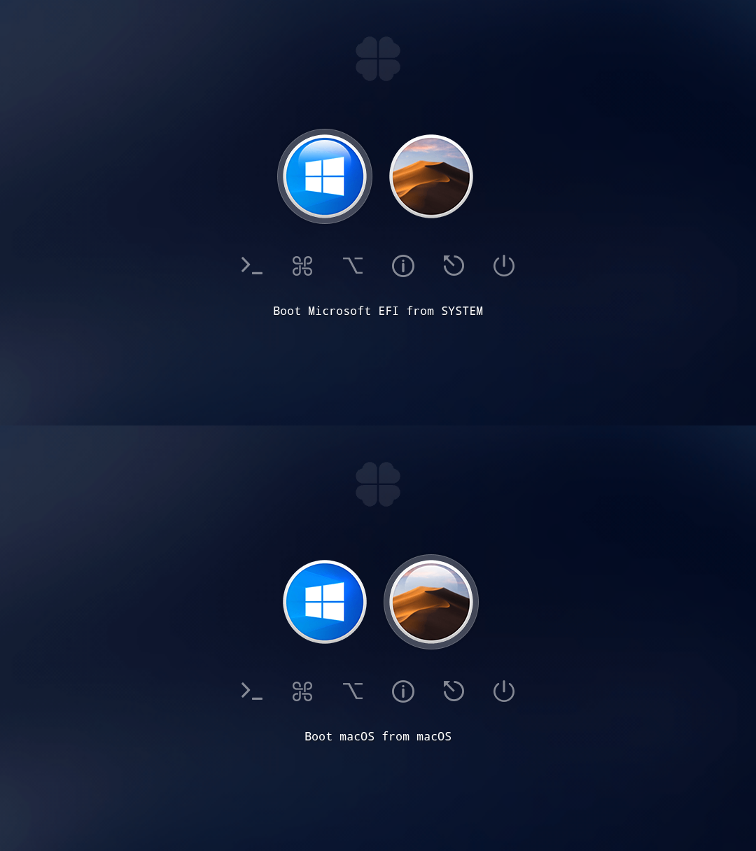

I'm sure I am doing something wrong but...my custom entries are not showing up how I excepted them to.
With my config (attached) shouldn’t the entries be listed "Mojave" on the left (first) and "Windows Pro 10" on the right?
Also, as you can see from screen shot, the full title I manually entered is not showing up. It still shows "SYSTEM" and "macOS," not "Mojave" and "Windows 10 Pro."
config.plist
config.plist

5 hours ago, Matgen84 said:
Can you try this:
Put Mojave in Last Volume
Sorry for my bad english
That did absolutely nothing. Boot screen still looks the same.
The issue is not that it doesn’t pick the correct volume, it is that they do not have the labels set in the config.
  • Sad 1
config.plist

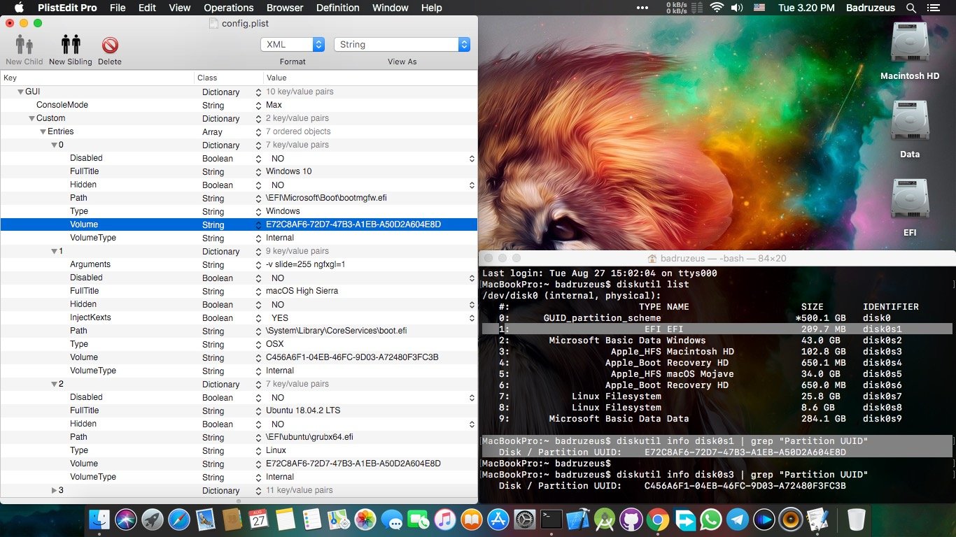

here is what i did for a Custom entry for macOS and Windows on a single disk with this layout:
$ diskutil list
/dev/disk0 (internal, physical):
   #:                       TYPE NAME                    SIZE       IDENTIFIER
   0:      GUID_partition_scheme                        *512.1 GB   disk0
   1:                        EFI EFI                     209.7 MB   disk0s1
   2:                 Apple_APFS Container disk1         459.7 GB   disk0s2
   3:       Apple_KernelCoreDump                         655.4 MB   disk0s3
   4:       Microsoft Basic Data W10                     50.6 GB    disk0s4
   5:           Windows Recovery                         995.1 MB   disk0s5
my Window bootmgr is the Microsoft folder but in the ESP/EFI (vs SYSTEM) along side CLOVER
$ cat /Library/Logs/CloverEFI/boot.log |grep Custom
0:120  0:000  Custom boot CUSTOM_BOOT_DISABLED (0x0)
6:657  0:001  === [ AddCustomEntries ] ==================================
6:657  0:000  Custom entry 0 FullTitle:"macOS" Path:"\System\Library\CoreServices\boot.efi" Type:1 Flags:0x6 matching Volume:"CE105F19-A28D-4A84-83D5-CDF4D547E35A"
6:709  0:000  Custom entry 1 FullTitle:"Windows 10" Path:"\EFI\Microsoft\Boot\bootmgfw.efi" Options:"-s -h" Type:7 Flags:0x0 matching Volume:"2A125BB9-B377-4701-9244-FBA3EADB8B4D"
Then looking at the clover logs i can see what GUIDs to use:
refer to the GUID for HD(1, and HD(2
HD(1 is the EFI which seems wrong but that where MS bootmgfw thing is
$ cat /Library/Logs/CloverEFI/boot.log |grep Volume
6:370  0:064  === [ ScanVolumes ] =======================================
6:370  0:000  - [00]: Volume: PciRoot(0x0)\Pci(0x1F,0x2)\Sata(0x0,0xFFFF,0x0)
6:371  0:000  - [01]: Volume: PciRoot(0x0)\Pci(0x1F,0x2)\Sata(0x1,0xFFFF,0x0)
6:371  0:000  - [02]: Volume: PciRoot(0x0)\Pci(0x1F,0x2)\Sata(0x0,0xFFFF,0x0)\HD(1,GPT,2A125BB9-B377-4701-9244-FBA3EADB8B4D,0x28,0x64000)
6:379  0:007          This is SelfVolume !!
6:379  0:000  - [03]: Volume: PciRoot(0x0)\Pci(0x1F,0x2)\Sata(0x0,0xFFFF,0x0)\HD(2,GPT,CE105F19-A28D-4A84-83D5-CDF4D547E35A,0x64028,0x35840BD8)
6:379  0:000  - [04]: Volume: PciRoot(0x0)\Pci(0x1F,0x2)\Sata(0x0,0xFFFF,0x0)\HD(3,GPT,4539F38D-62B6-46EF-A59F-E0D35A1366D2,0x358A4C00,0x138800)
6:380  0:000  - [05]: Volume: PciRoot(0x0)\Pci(0x1F,0x2)\Sata(0x0,0xFFFF,0x0)\HD(4,GPT,882E2BDA-CBF5-4C17-8404-35EC11AB98BA,0x359DD400,0x5E284CA)
6:381  0:000  - [06]: Volume: PciRoot(0x0)\Pci(0x1F,0x2)\Sata(0x0,0xFFFF,0x0)\HD(5,GPT,D9951696-A967-46D5-AE22-B9CD84B2AEF0,0x3B806000,0x1DA800)
which look like this in config.plist
$ diskutil list
		<key>Custom</key>
		<dict>
			<key>Comment</key>
			<string>Windows Entries</string>
			<key>Entries</key>
			<array>
				<dict>
					<key>FullTitle</key>
					<string>macOS</string>
					<key>Type</key>
					<key>Volume</key>
					<string>CE105F19-A28D-4A84-83D5-CDF4D547E35A</string>
				</dict>
				<dict>
					<string>Windows 10</string>
					<key>Type</key>
					<string>Windows</string>
					<key>Volume</key>
					<string>2A125BB9-B377-4701-9244-FBA3EADB8B4D</string>
				</dict>
			</array>
		</dict>

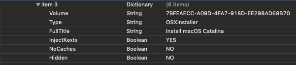

I use two HDD (macOS Mojave and Windows 10). There isn't CloverEFI folder in /Library/Logs. I don't understand why?

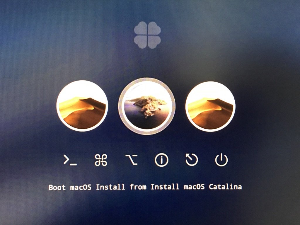

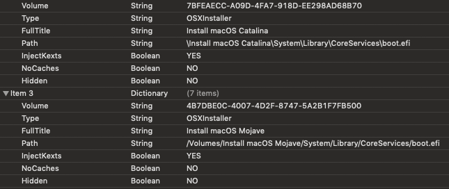

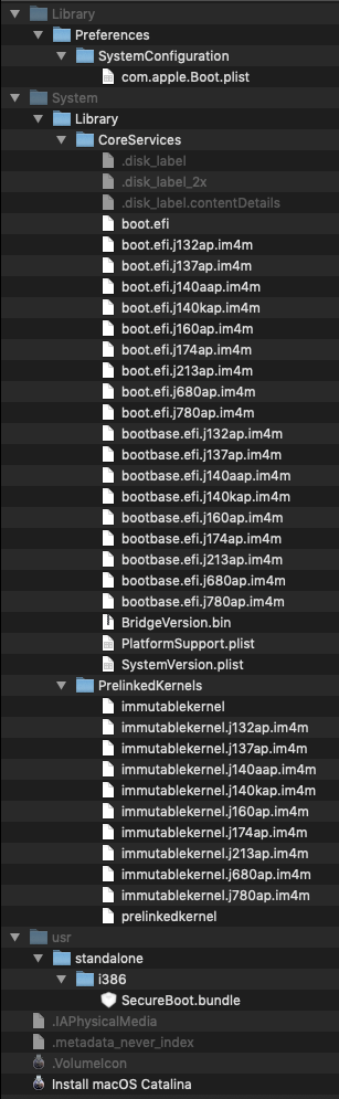

Could someone please remind me which UUID I choose from a USB stick (With two installers on) to get it correctly detected in the Clover GUI?
Currently I get this but it should just say "Install macOS Catalina" (Same for Mojave installer)...
