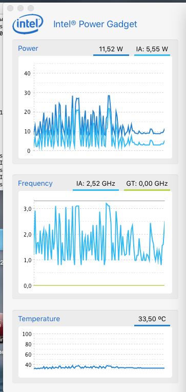

This is my speedstep on Skylake (#1 in signature):
- no external SSDT
- config->ACPI->SSDT->Generate->PState=Yes, CState=Yes.
- CPU->SavingMode=15
- HWPEnable=NO
others by default.

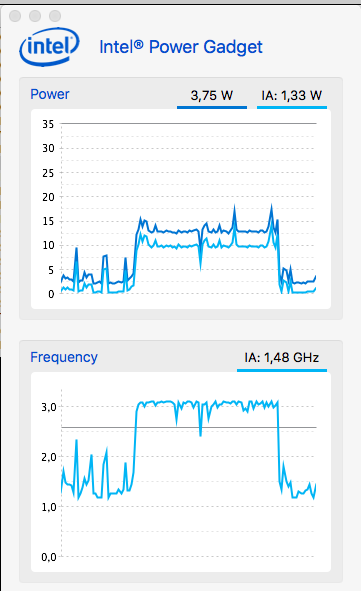

And  this is speedstep for my IvyBridge laptop (#2 in signature)
boot-arg = -xcpm
no CPU SSDT
Generate=YES (don't know if needed for xcpm)
- no external SSDT
- HWPEnable=NO
others by default.
boot-arg = -xcpm
no CPU SSDT

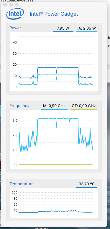

I think TDP is not influenced although it included into state generator in Clover.
I checked my performance, it is the same as in Windows 7 Pro by same tests.
The whole point of p-states is to change the power consumption, it most definitely matters. I imagine that it would work somewhat if you enter the exact TDP wattage for your CPU in settings but if not then you are not getting correct p-states, or even close. Since generate p/c-states is enabled by default, most people probably are not setting the TDP, that should maybe put out some sort of warning.
EDIT: I don't see how you could only be getting ~20W of consumption on a 65W TDP CPU, even in windows. That can't possibly be correct, just one core of my CPU uses 20W+ when at full load. Currently I am overclocked and with just five minutes of pretty much just typing it maxed out at 27.99W for just one core...

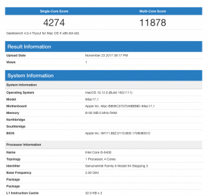

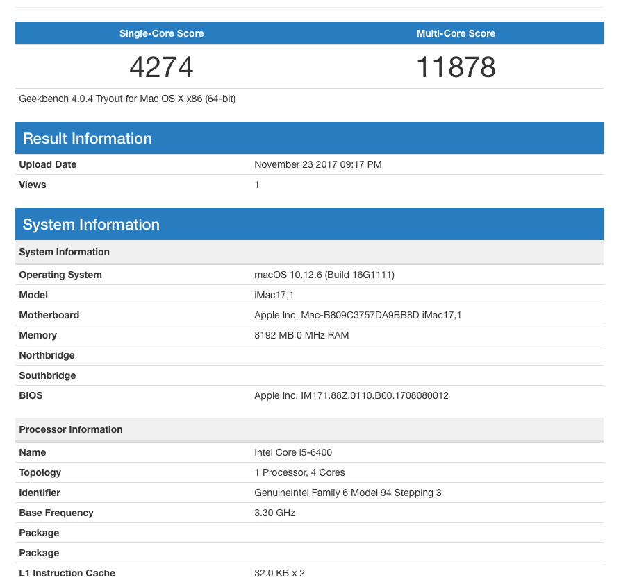

What about results like this? I see many of those, that have much higher scores, just that one in particular is only operating at the correct base frequency 2.7GHz where yours is the turbo 3.3GHz, and still has higher scores.... I would show you my results showing vastly different outcomes in macOS but I can't boot macOS currently because I can't figure out why I am getting panic. That's for later on when I have time to sit and mess with it though. As for windows, here is HWMonitor of my CPU for just one second, nothing open. I have it set to 3.3GHz with 36/38/40/42 turbos, and higher overhead for those states. Appears that all cores at 1.6GHz uses only 2.21W. The whole CPU package went up to 24.86W at only 20% usage because the uncore appears to always consume ~3.5W. Three of the cores jumped up to 2.7GHz at some point, can't tell you if it was at once or individually. But during this time 20.11W was used when only at 20% CPU usage. Which makes sense 20W * 20/100 = 20W * 5 = 100W. The TDP is 95W, so I'm sure the math works out better if I knew exactly which cores were being used for how long, etc. You should dump your generated p-states table and compare them to the original table, what is the difference in expected power consumption for each state? If this number is too high, you will be stuck in lower p-states, if this number is too low then you will get higher p-states only. The CPU generates so much power for each state (you can't change this unless it's one of the newer CPUs and you reprogram the hardware power features), so if the CPU is producing 40W but all your states say you need 100W, you will never reach any lower states. Similarly if your CPU produces 40W but you set all your states to say you need 20W, you will never go above your lowest state. I think I said that right, if not I'm pretty sure you can understand what I mean.

His result is higher may be because of RAM.
He also may has overclocked FSB.
And there is no twice difference as you say about 20W 65W

You said my CPU is underpowered? 20W while it should be 65W? But I see no such differencies in CPU score.
I set SavingMode to 15. It means slow transition from low frequency to high frequency. In the case of gigbench it may leads to lower result because ot many transition up and back as we see in Intel Power Gadget.
At evening I will try to overclock my BIOS.
But I just showed you multiple examples of geekbench scores much higher than yours, also it should be running at full load, so the taking more steps to get up there shouldn't matter. I have a feeling it's actually more related to how often and how long it enters turbo. And even in Intel power gadget, there is some telling evidence. In your first one which is 65W TDP, you can see that it doesn't really bounce around at the top power levels, it's almost a flat line, but the frequency bounces. The second one with a 35W TDP, both lines bounce accordingly.
