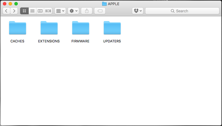

Guys, I've done something really stupid.
I bought a Retina Macbook Pro 13 late-2013 and installed Sierra 10.12.1 onto it. No problems so far. Then I created a new partition and tried to install the Beta onto it, using a USB drive made with Clover (hackintosh style) and at first I selected OSX Base System on boot up. And it got to the installer and got an error (error 0 or something like that). And now I think I know why that happened.
Anyway, then I selected EFI (also from the USB drive) and it loaded up Clover. Then I selected the USB drive from the Clover UI (like I would do if I want a Hackintosh installation) and...it would just stay there with the Apple logo and no loading bar. After a while, I force shut down the computer. And tried to boot up normally. Removed the USB and everything.
But since then, it goes into boot loop, with no Apple logo, only the chime. It sounds the chime over and over again.
Please, tell me you know how to fix this. It's clearly a software issue. I'm pretty sure something got corrupted. I just don't know what and how to fix it. :(
I tried booting in Safe Mode (holding the Shift key while booting), tried booting in Recovery (holding Command + R), tried selecting a different boot drive (Option key). I don't know what else to try....
Sorry about the possible off-topic. I just don't know what to do. I even made a new USB installation and tried to boot from it. But..I only got the endless loop and nothing else.

Well, then begin using clover on it then ;)
You said that it works.

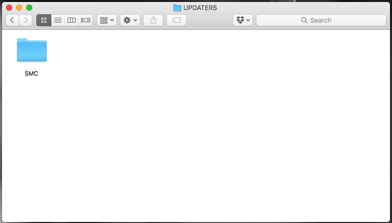

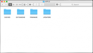

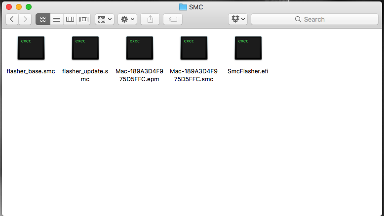

did your clover boot stick have a apple folder? if it did it might have tried installing an smc update and if it was from another model then you might have to load the correct one into it.
 also if you can pull the drive and see if the bootloop stops then you know its just a corrupted drive.
I can't select any boot drive anymore. It doesn't respond to Option + Power. It just keeps rebooting.
I don't know.... If it ads one when installing it, then it might have had one indeed. And yeah, it was surely from another model.... Stupid me. I just realized it. Of course it couldn't have worked.
I'm pretty sure it will stop. Just as I'm pretty sure it's just a corrupted EFI.

So..I got the SSD out... Connected it to my hackintosh. And the only thing I noticed different from my other macbook's EFI, is the presence of an UPDATERS folder, containing what I can only assume is what Clover tried to flash onto it.
post-1303722-0-62218600-1481134591_thumb.png post-1303722-0-76575900-1481134612_thumb.png post-1303722-0-10709400-1481134625_thumb.png
Problem is that, even with no SSD installed, it still goes into the endless chime... So..I guess it's either cached somewhere. Or I don't know... But it doesn't seem to be the SSD anymore. Any ideas what else could it be?
mac-189a3d4f975d5ffc seems to be MacBook Pro 11,1 but i do not see an SMC update for it at https://support.apple.com/en-us/HT201518only an EFI Boot Rom.
maybe a methode like this one might help https://pubmem.wordpress.com/2011/04/09/flash-efi-firmware-update-manually-on-a-macbook-51/
even if you can create it on a hack and compare/ transfer it. or boot the hack with the MAC HDD using the correct smbios and trying.
attachicon.gifScreen Shot 2016-12-07 at 8.08.00 PM.png attachicon.gifScreen Shot 2016-12-07 at 8.08.08 PM.png attachicon.gifScreen Shot 2016-12-07 at 8.08.16 PM.png

I did, but not using Clover. As I said above, I bought a PCI adapter for Mac SSDs to have direct access to it. But it's not the SSD since it does this even without the SSD plugged in. It doesn't even show the boot drive picker (Option key + Power)
Update: fixed by replacing the EFI chipset on the motherboard. Apparently, the firmware on that chipset got corrupted due to an incomplete update (I suppose when I force shut it down, that happened). It was like a $60 repair. Could have been a lot worse. Just for everyone wondering if it can be fixed without replacing the entire board. Yeah, it can.
