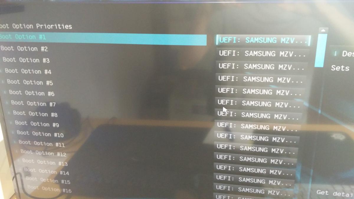

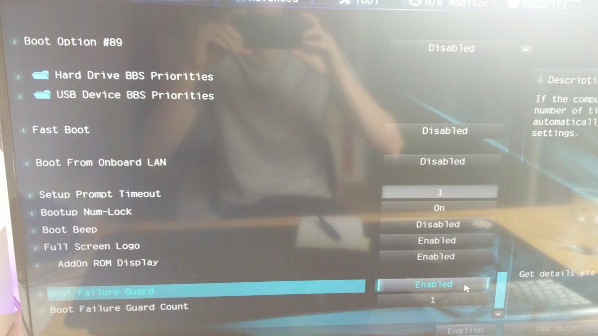

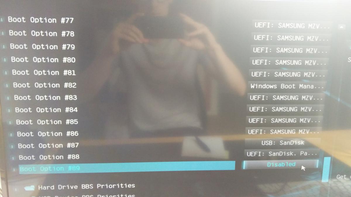

I need some input/help from you due to my personal rig update 2016. I've decided to go with a basic x99 update, even that I've found out that I'm the only one running my mobo at the moment as an hackintosh?
Hardware: Asrock x99m Extreme4, i7-5820k, 32GB DDR4, GTX970, SM951 Samsung NVME.
I have some problems with USB (not part of this post) and my UEFI entries in my Bios. Strangely, Clover does create a huge amount of uefi-boot entries in the bios section (at the moment around 80). That is the same for my NVME M2 SSD or normal SATA attached SSDs. I know that there was someone else with this problem in the community, but I dont find his post again and the help he had received from you guys.
Do you need any other information regarding my problem for helping me? Is this just a cosmetic issue?
what you mean? can you attached photo?
This is not a cosmetic issue. Those entries are taking up space in NVRAM and slow down your BIOS UI.
I think it's the BIOS that creates those. Try using EasyUEFI in Windows to remove the duplicates, then add a new entry that points to the Clover partition. The new entry should include a file path like this:\EFI\BOOT\BOOTX64.EFI
Remove entries that don't have a file path (except for the Hard Drive and CD/DVD Drive options). Move the one you want to be the default (probably the new Clover option you just added) to the top.
Then restart your computer, and check the BIOS boot menu to make sure your entries are there. Boot into Clover and Mac OS X a few times to make sure duplicates are no longer added.
