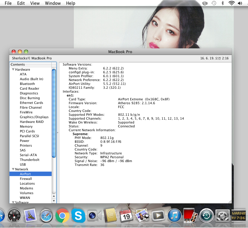

Sherlocks Posted June 18, 2016 Share Posted June 18, 2016 i found clover binary patch for snow leopard this is AR9285 Local Patch "ATHR: unknown locale" no need update rom in windows AirPortAtheros21 FC 64 74 6D 77 0E 41 83 FC 64 EB 6D 77 0E 41 83 Enjoy 1 Link to comment https://www.insanelymac.com/forum/topic/284656-clover-general-discussion/page/417/#findComment-2244267 Share on other sites More sharing options...

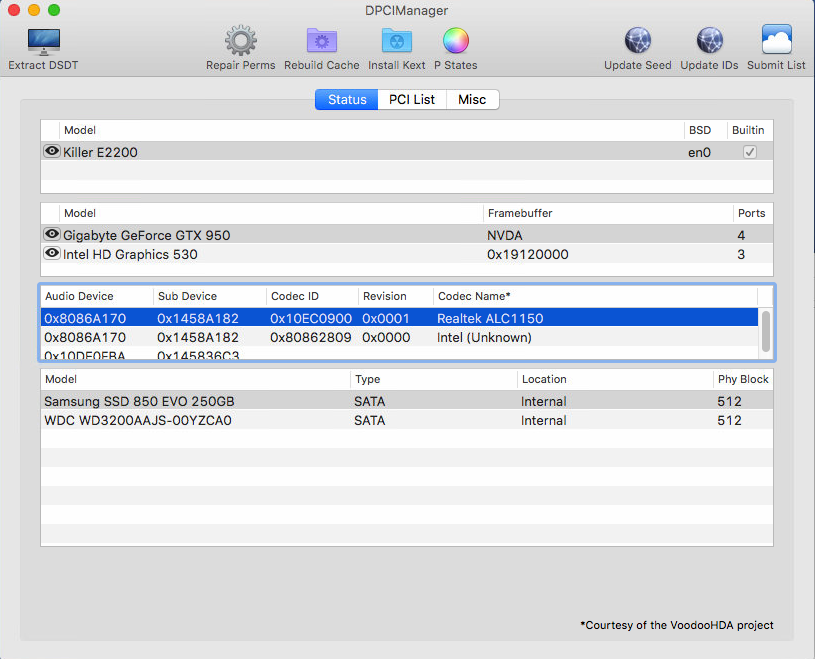

arsradu Posted June 18, 2016 Share Posted June 18, 2016 An EFI/Clover + Clover bootlog + ioreg should help clarify what is happening... Looks like this one is using class=040100 as you can see in the log. 0:100 0:000 PCI (00|00:1F.03) : 8086 A170 class=040100 Keep in mind that I didn't have HDEF by default. I had to rename it from HDAS. So maybe that's why Clover can't find what it's looking for. Clover zip attached Boot log attached HDEF ioreg screenshot attached (sorry, can't attach the full ioreg). Screenshot from DPCI Manager (looks like the device is properly recognized there) boot.log.zip CLOVER.zip Link to comment https://www.insanelymac.com/forum/topic/284656-clover-general-discussion/page/417/#findComment-2244276 Share on other sites More sharing options...

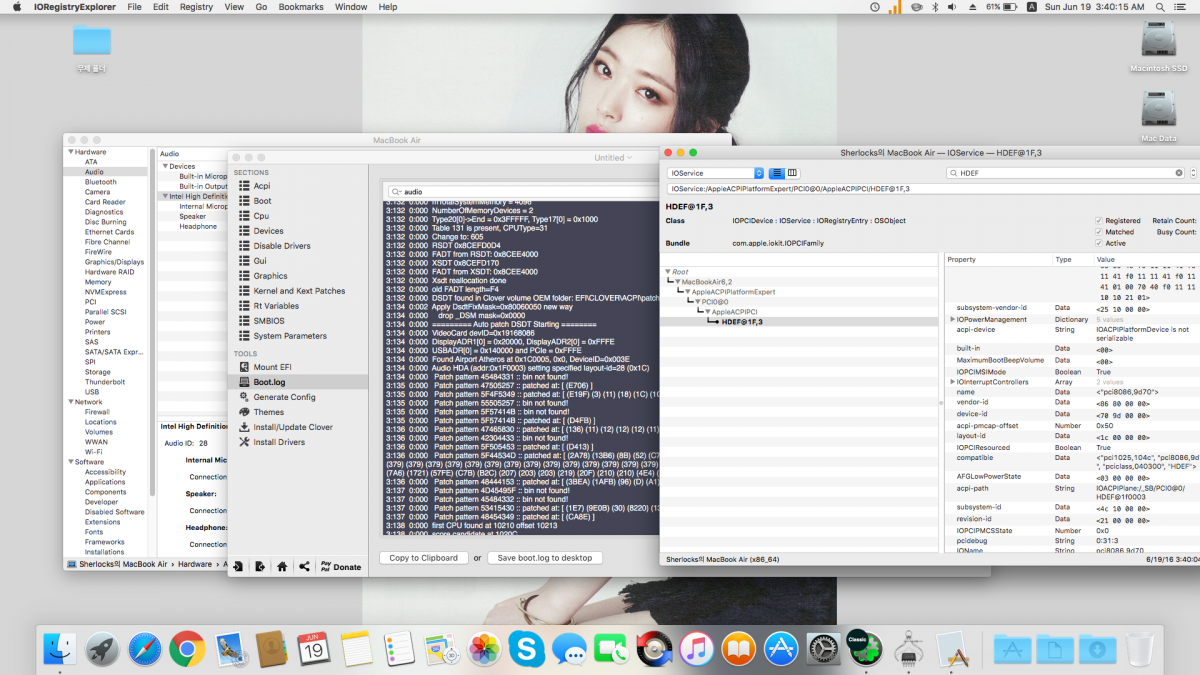

Sherlocks Posted June 18, 2016 Share Posted June 18, 2016 Looks like this one is using class=040100 as you can see in the log. 0:100 0:000 PCI (00|00:1F.03) : 8086 A170 class=040100 Keep in mind that I didn't have HDEF by default. I had to rename it from HDAS. So maybe that's why Clover can't find what it's looking for. Clover zip attached Boot log attached HDEF ioreg screenshot attached (sorry, can't attach the full ioreg). Screenshot from DPCI Manager (looks like the device is properly recognized there) Screen Shot 2016-06-18 at 9.02.15 PM.png Screen Shot 2016-06-18 at 1.22.34 PM.png My Skylake laptop system works clover audio injection. here Config DSDT HDAS->HDEF Patch + Clover Audio Injection 28 layout + AppleALC custom builded for ALC255 by me. i tried to test layout 28 to 1. i dont get sound. 28 is works. as result, clover surely works audio injection on my laptop. i like it to use DSDT.aml patch or SSDT-HDEF.aml for Audio. Link to comment https://www.insanelymac.com/forum/topic/284656-clover-general-discussion/page/417/#findComment-2244279 Share on other sites More sharing options...

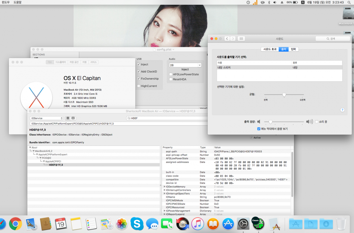

arsradu Posted June 18, 2016 Share Posted June 18, 2016 My Skylake laptop system works clover audio injection. here Config DSDT HDAS->HDEF Patch + Clover Audio Injection 28 layout + AppleALC custom builded for ALC255 by me. i tried to test layout 28 to 1. i dont get sound. 28 is works. as result, clover surely works audio injection on my laptop. i like it to use DSDT.aml patch or SSDT-HDEF.aml for Audio. 스크린샷 2016-06-19 오전 3.23.38.png Laptop and desktop chipsets might be different. Also, I can see the gorgeous girl in the background, but I can't see the layout-id in your screenshot. Which one do you think I'm most interested in right now? ) 1 Link to comment https://www.insanelymac.com/forum/topic/284656-clover-general-discussion/page/417/#findComment-2244282 Share on other sites More sharing options...

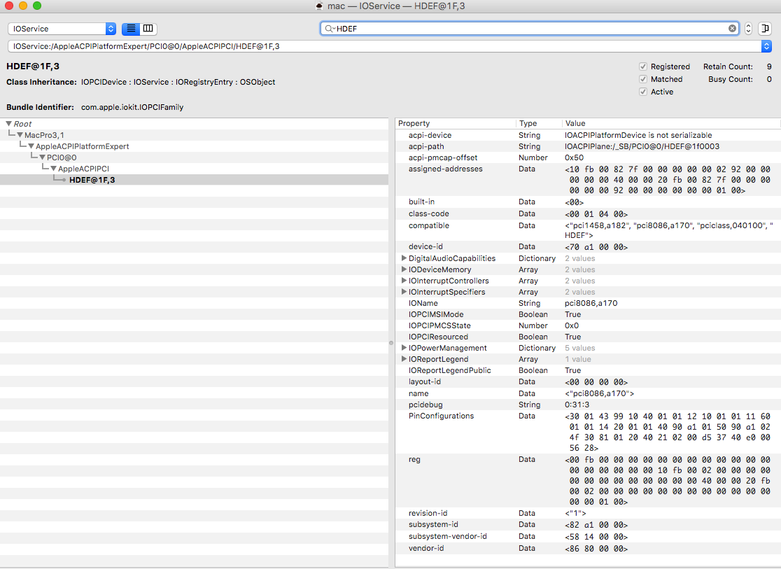

RehabMan Posted June 18, 2016 Share Posted June 18, 2016 Looks like this one is using class=040100 as you can see in the log. 0:100 0:000 PCI (00|00:1F.03) : 8086 A170 class=040100Keep in mind that I didn't have HDEF by default. I had to rename it from HDAS. So maybe that's why Clover can't find what it's looking for. This is the exact case I was referring to... You cannot use config.plist/Devices/Audio/Inject with the Clover code in its current state. Someone with checkin privs for Clover can fix it (it is a relatively trivial change). Or you can use Devices/Arbitrary or ACPI to inject layout-id. My Skylake laptop system works clover audio injection. here Config DSDT HDAS->HDEF Patch + Clover Audio Injection 28 layout + AppleALC custom builded for ALC255 by me. i tried to test layout 28 to 1. i dont get sound. 28 is works. as result, clover surely works audio injection on my laptop. i like it to use DSDT.aml patch or SSDT-HDEF.aml for Audio. 스크린샷 2016-06-19 오전 3.23.38.png Note class-code... With ioreg showing <00 03 04 00> Clover injection via config.plist/Devices/Audio/Inject expected to work. Contrast to the <00 01 04 00> as seen in post #10482. 1 Link to comment https://www.insanelymac.com/forum/topic/284656-clover-general-discussion/page/417/#findComment-2244283 Share on other sites More sharing options...

Sherlocks Posted June 18, 2016 Share Posted June 18, 2016 This is the exact case I was referring to... You cannot use config.plist/Devices/Audio/Inject with the Clover code in its current state.Someone with checkin privs for Clover can fix it (it is a relatively trivial change).Or you can use Devices/Arbitrary or ACPI to inject layout-id.Note class-code... With ioreg showing <00 03 04 00> Clover injection via config.plist/Devices/Audio/Inject expected to work.Contrast to the <00 01 04 00> as seen in post #10482. Screenshot Link to comment https://www.insanelymac.com/forum/topic/284656-clover-general-discussion/page/417/#findComment-2244285 Share on other sites More sharing options...

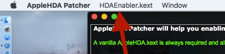

Micky1979 Posted June 18, 2016 Share Posted June 18, 2016 Thanks!! Why don't use an HDAEnabler.kext directly from EFI/CLOVER/kexts? Link to comment https://www.insanelymac.com/forum/topic/284656-clover-general-discussion/page/417/#findComment-2244294 Share on other sites More sharing options...
arsradu Posted June 18, 2016 Share Posted June 18, 2016 Thanks!! Why don't use an HDAEnabler.kext directly from EFI/CLOVER/kexts? Cause...I never thought about it? What exactly does that do? It enables HDA. That's why it's called an enabler. Ok, but how? I never knew. Link to comment https://www.insanelymac.com/forum/topic/284656-clover-general-discussion/page/417/#findComment-2244296 Share on other sites More sharing options...
Micky1979 Posted June 18, 2016 Share Posted June 18, 2016 inject the layout-id. Link to comment https://www.insanelymac.com/forum/topic/284656-clover-general-discussion/page/417/#findComment-2244299 Share on other sites More sharing options...
RehabMan Posted June 18, 2016 Share Posted June 18, 2016 Screenshot Screen Shot 2016-06-19 at 3.40.15 AM.png You realize you're proving my point, right? 1 Link to comment https://www.insanelymac.com/forum/topic/284656-clover-general-discussion/page/417/#findComment-2244300 Share on other sites More sharing options...
arsradu Posted June 18, 2016 Share Posted June 18, 2016 inject the layout-id. LOL. Couldn't you say that like 20 posts ago?? Maybe yesterday too? ) Ok, will give that one a try, as well. So I can use the HDAEnabler from the bucket of goodies that the AppleHDA Patcher created on my Desktop? Link to comment https://www.insanelymac.com/forum/topic/284656-clover-general-discussion/page/417/#findComment-2244303 Share on other sites More sharing options...
