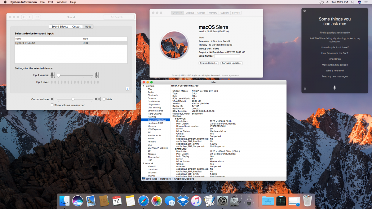

I have ALC898 working on my X79 using CloverALC method (Clover binary patches and injecting xml files to AppleHDA as zml files).
For 10.12 you may need to zero out 8A19D411 in AppleHDA to get your codec working (especially if you had to zero out 8319D411 for 10.11).
Did Anyone get audio injection working?
Yep, ALC889 with clover injection, but I had to edit applehda manually.

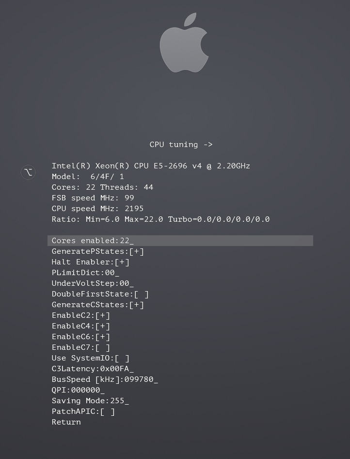

@Slice on the Broadwell issue. After some testing looks like clover (even the latest one) gets stuck on injecting kext on el cap and Sierra.
Can it be ecc issue?
/Edit. Sorry forgot to add the logs.
Also on the CPU section it doesn't show numbers for turbo, and doesn't it suppose to have 2x the cores/threads for dual CPU system?

Try zeroing out that codec and see if it helps (it won't do any harm). ALC892 is enabled by replacing 8419D411 so there might be some relation.
I did zero it out, so now I have 4 outputs in sound preference, but no sound, tried to zero out 8A19, but nothing, tried to switch them with my codec ID, but the only one where I can at least see output options is 8B19
Probably something isn't patched correctly.
In case someone would like to take a quick look at it, here are my IORegistryExporer output, appleHDA kext and Clover config.plist.
EDIT: I fixed it, nulled both 8A19 and 8419 and plus I've edited Toleda's CloverALC command scrip to fit Sierra and also instead of putting all kext into "other", I've created 10.12 folder and put it all there, don't know which step fixed it, but thanks to all developers and people who help. :thumbsup_anim:
With or without patching.
Thanks a lot
Looks like kext patching is good. There are normal messages.

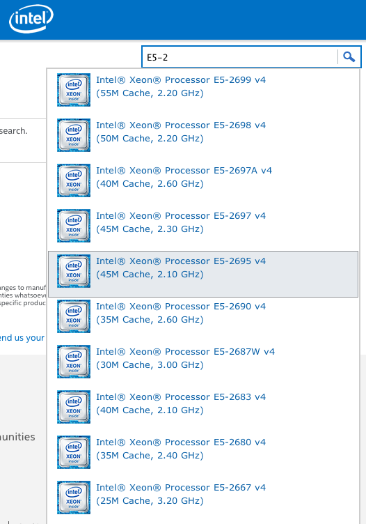

About turbo frequency there is a little problem. I have no Intel datasheet for it. Give me AIDA64 report about the CPU.
