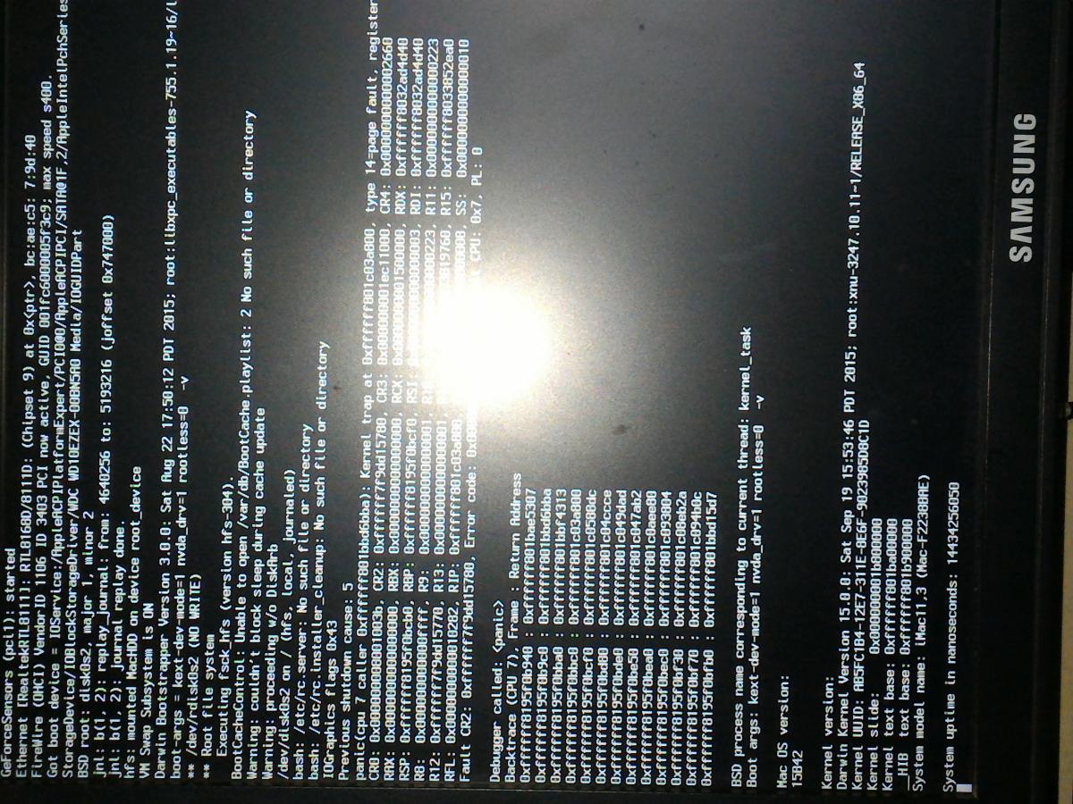

T a D Posted October 30, 2015 Share Posted October 30, 2015 I have a strange problem with Clover that only seems to appear after I have updated the Nvidia web drivers. Clover fails to load any kexts in EFI/CLOVER/kexts/ Specifically FakeSMC.kext isn't loaded and then the system hangs after "Waiting for DSMOS...". It will boot in single user, command prompt, but once you run fsck, remount / and then exit it hangs at the same point. The issue seems to be resolved when I boot into Windows and then back into OS X (booting into Linux doesn't fix it). I don't even have to do anything in Windows, just boot to login and then re-boot. I'm not using any DSDT and have Clover drop CpuPm from SSDT. SMBIOS is iMac14,2 It has happened since r31xx and happened most recently with r3292. Any pointers on how to get more debugging information if this happens again? Is it possible to get bdmesg information from a single user, command prompt boot? Link to comment https://www.insanelymac.com/forum/topic/284656-clover-general-discussion/page/348/#findComment-2183889 Share on other sites More sharing options...
TheRacerMaster Posted October 30, 2015 Share Posted October 30, 2015 What does your folder structure look like? Clover only will load kexts from EFI/CLOVER/kexts/Other & EFI/CLOVER/kexts/<OS version>, not EFI/CLOVER/kexts. 1 Link to comment https://www.insanelymac.com/forum/topic/284656-clover-general-discussion/page/348/#findComment-2183898 Share on other sites More sharing options...
T a D Posted October 31, 2015 Share Posted October 31, 2015 What does your folder structure look like? Clover only will load kexts from EFI/CLOVER/kexts/Other & EFI/CLOVER/kexts/<OS version>, not EFI/CLOVER/kexts. <deleted irrelevant stuff> So, it turns out that somewhere along the line I managed to install Clover to the hard drive El Capitan was installed on (HD#2) (in /EFI/CLOVER on the root volume). This installation didn't have a config.plist or any kexts. It seems that occasionally when booting from the primary hard drive (HD#1) Clover would start fine, use config.plist from (HD#1)/EFI/CLOVER but when it came to boot El Cap from HD#2 it was looking in (HD#2)/EFI/CLOVER/kexts/... and didn't find any. That was the cause of my seemingly random failure to inject any kexts. I'm not sure why it worked sometimes and other times it didn't. I've now checked all hard drives for EFI folders and partitions and made sure that the only one being used is from HD#1. The system now boots OS X and injects kexts every time. Sorry for wasting everyone's time. Link to comment https://www.insanelymac.com/forum/topic/284656-clover-general-discussion/page/348/#findComment-2184197 Share on other sites More sharing options...
