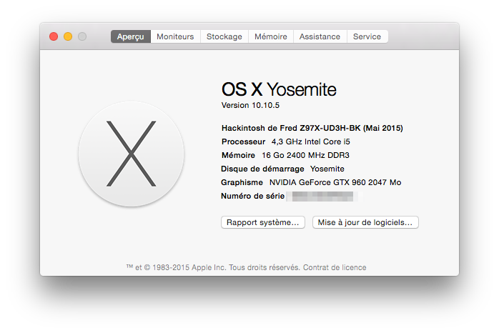

hello ,
my GTX 950 works CI/QE but not recognize with Clover or Chameleon , an idea ? thanks :)
 NVIDIA Graphics Device :
  Jeu de composants : NVIDIA Graphics Device
  Type : Processeur graphique (GPU)
  Bus : PCIe
  Longueur de la voie PCIe : x4
  VRAM (totale) : 2047 Mo
  Fournisseur : NVIDIA (0x10de)
  Identifiant du périphérique : 0x1402
  Identifiant de révision : 0x00a1
  Révision de la ROM : VBIOS 84.06.2f.00.7d

Don't use NVIDIA graphics injection, let the Web drivers deal with it. "NVIDIA Graphics Device" is usual for super-new cards that don't have full support in the Web driver yet.
