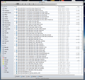

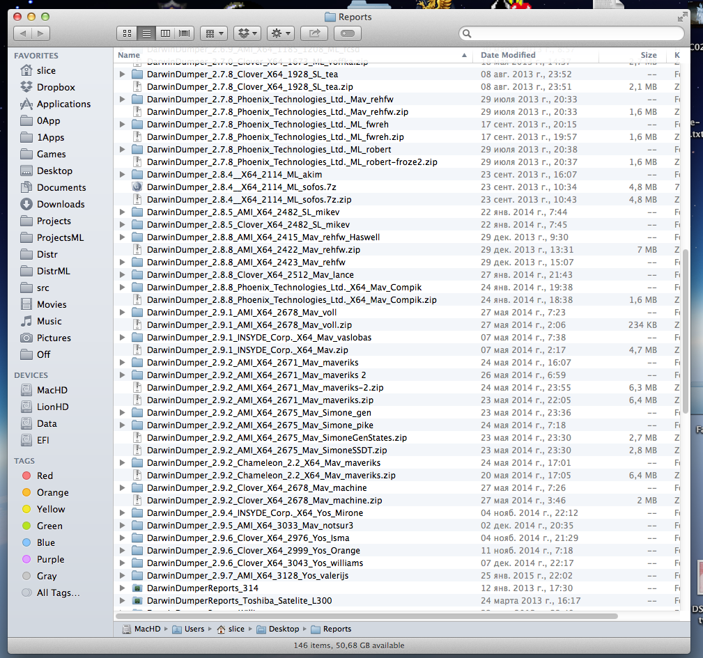

Legacy Clover exists and works for many users. It works due to presence CSM in BIOS. If you disable CSM then you can't start legacy Clover.
As well legacy Clover can start from MBR Partition Table. Do you need hundreds proofs? DurwinDumper reports from different users? Or what?

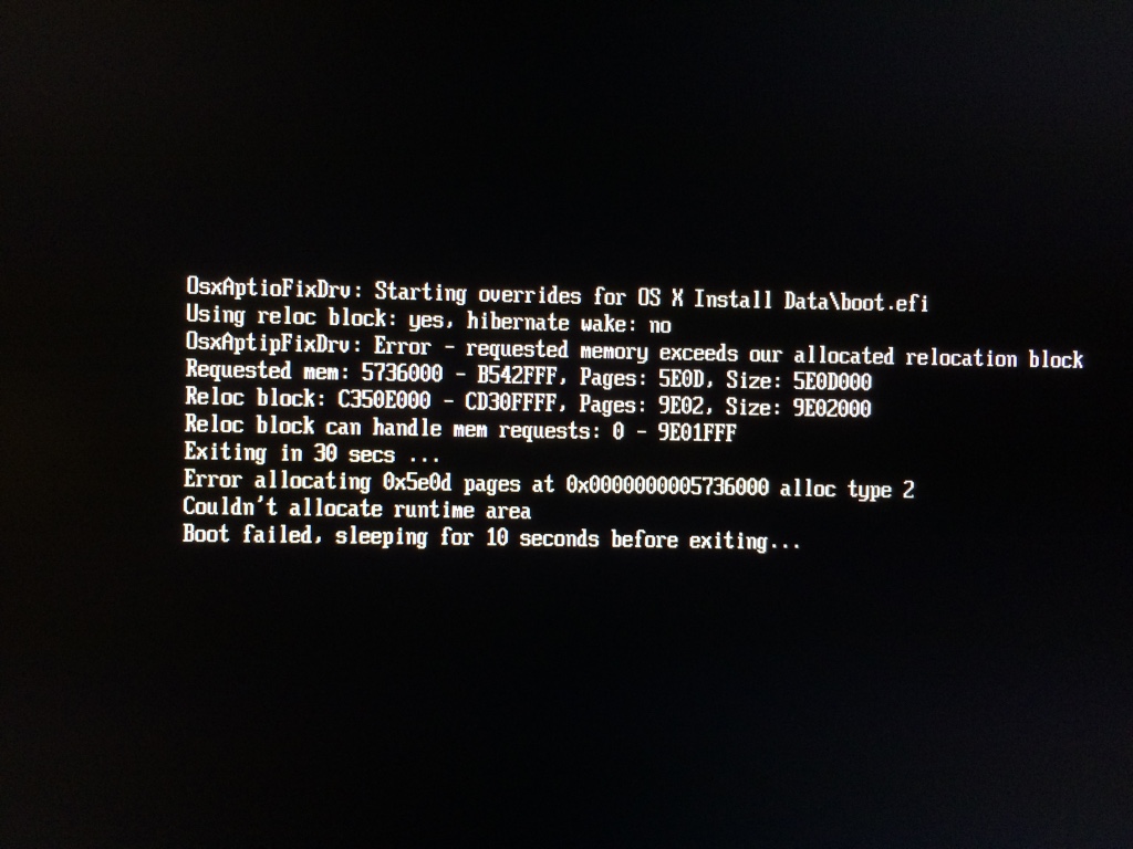

EDIT: Tried to run the installer from Clover after it rebooted the system and got this error...

For your error, do you use OsxAptioFixDrv-64 or OsxAptioFixDrv2-64 ?
(v2 is supposed to handle this)
I currently use the none v2 one, never had to use it previously.
I wasn't sure if the v2 one did everything the original does just differently?
I had the same issue : I installed NVidia Web drivers for my eGPU. It worked for some time and then I got this error, solved by using v2.
v1
  UEFI driver for enabling loading of OSX by using memory relocation.
v2
  UEFI driver for enabling loading of OSX without memory relocation.
I want to say that v2 is not a replacement for v1. They are different.
With v2 I have working hibernation but I can't boot into 10.7.5.
With v1 I can boot both system but hibernation is not working. I prefer this version because I use soft sleep on the desktop. It is faster then hibernation that needed mostly for mobile computers.
Thanks Slice, if they are both present in the folder which one would be used as this morning I copied the v2 one in there along with the v1 and got the same error?
First priority is OsxAptioFixDrv,
second is OsxAptioFix2Drv,
third is LowMemFix.
Next priority driver will be skipped.
