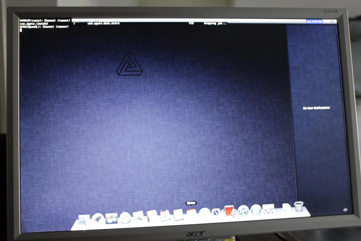

spakk Posted June 3, 2013 Share Posted June 3, 2013 (edited) Hi guys, I was sick a few days, so I was not possible to report me. The last test I made, were working successful with OpenGL with my Nvidia GTX 550Ti, it works and Mountain Lion starts, the graphics memory is displayed completely correct, OpenGL Viewier recognize my working graphics card, but the construction of the dock are very slow! Occasionally I get an error message NVDA (Private): Channel timeout! com.apple.launched com.apple.dock.extra NVDA(OpenGL):Channel timeout! (see image) I get this message when I install only one injector in S / L / E for example patched NVkush.kext Once when I install three patched injectors such as: NVKush.kext, Natit.kext and ATY_Init.kext, I get no error message, but that does not stay that way, so we desperately need someone to modified the GeForceGLDriver.bundle by various adjust the GeForceGLDriver.bundle \ Contents \ MacOS \ libclh.dylib from the previous OSX versions and the patch of IONDRVSupport.kext. Conclusion: we need to modify the libclh.dylib, unfortunately I have no idea how to do. PS: Bronzovka, I have tested your kernel, unfortunately no success boot Edit: Netkas, did you see an opportunity to fix the problem? Edited June 3, 2013 by spakk Link to comment https://www.insanelymac.com/forum/topic/281450-mavericks-kernel-testing-on-amd-formerly-mountain-lion-kernel-testing-on-amd/page/94/#findComment-1919570 Share on other sites More sharing options...

spakk Posted June 5, 2013 Share Posted June 5, 2013 Hi guys, I was sick a few days, so I was not possible to report me. The last test I made, were working successful with OpenGL with my Nvidia GTX 550Ti, it works and Mountain Lion starts, the graphics memory is displayed completely correct, OpenGL Viewier recognize my working graphics card, but the construction of the dock are very slow! Occasionally I get an error message NVDA (Private): Channel timeout! com.apple.launched com.apple.dock.extra NVDA(OpenGL):Channel timeout! (see image) I get this message when I install only one injector in S / L / E for example patched NVkush.kext Once when I install three patched injectors such as: NVKush.kext, Natit.kext and ATY_Init.kext, I get no error message, but that does not stay that way, so we desperately need someone to modified the GeForceGLDriver.bundle by various adjust the GeForceGLDriver.bundle \ Contents \ MacOS \ libclh.dylib from the previous OSX versions and the patch of IONDRVSupport.kext. Conclusion: we need to modify the libclh.dylib, unfortunately I have no idea how to do. PS: Bronzovka, I have tested your kernel, unfortunately no success boot Edit: Netkas, did you see an opportunity to fix the problem? because no one has any idea how I can fix this? Link to comment https://www.insanelymac.com/forum/topic/281450-mavericks-kernel-testing-on-amd-formerly-mountain-lion-kernel-testing-on-amd/page/94/#findComment-1920041 Share on other sites More sharing options...

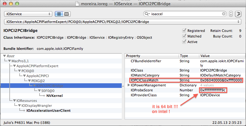

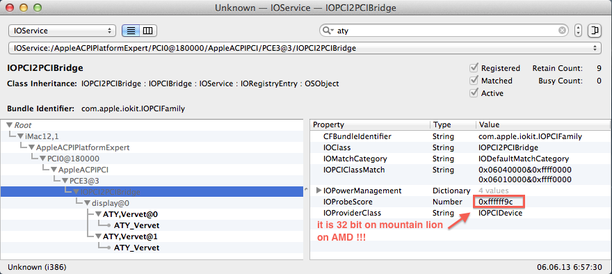

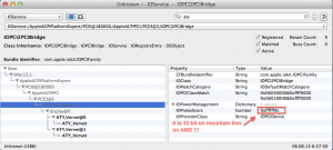

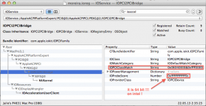

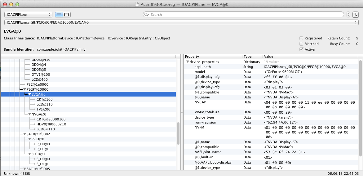

Bronya Posted June 6, 2013 Share Posted June 6, 2013 Hi to all ! I found one problem ! 1) on intel : 2) on AMD : Why ? What is this? Should show how "0xffffffffffffff9c" on amd !!! 5 Link to comment https://www.insanelymac.com/forum/topic/281450-mavericks-kernel-testing-on-amd-formerly-mountain-lion-kernel-testing-on-amd/page/94/#findComment-1920168 Share on other sites More sharing options...
+ira Posted June 6, 2013 Share Posted June 6, 2013 Hi to all !I found one problem ! 1) on intel : 2) on AMD : Why ? What is this? Should show how "0xffffffffffffff9c" on amd !!! Hey Bronya don't forget what my specs are: P4631 mobo GA-VM900M (Via) and the card a nvidia gt 440... It would be helpful if someone with a nforce or amd chipset and nvidia card could post a ioreg for you to compare those values, it wouldn't? We need to check if those values of the pci2pcibridge on nforce chipsets are also on 32bit then we can possibly blame it for the graphics corruption. 1 Link to comment https://www.insanelymac.com/forum/topic/281450-mavericks-kernel-testing-on-amd-formerly-mountain-lion-kernel-testing-on-amd/page/94/#findComment-1920179 Share on other sites More sharing options...
theconnactic Posted June 6, 2013 Author Share Posted June 6, 2013 Well, Bronzovka, I think you did find the problem. That's really big deal, so way to go! Now the next logical step would be to search the cause of this. I'm reading the sources of the kernel (AnV version) and until now find nothing. I'll post here if I step at anything. All the best! 1 Link to comment https://www.insanelymac.com/forum/topic/281450-mavericks-kernel-testing-on-amd-formerly-mountain-lion-kernel-testing-on-amd/page/94/#findComment-1920195 Share on other sites More sharing options...

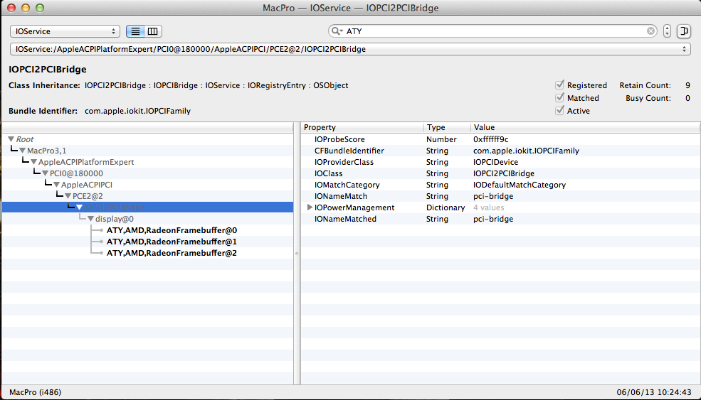

JorgeMax Posted June 6, 2013 Share Posted June 6, 2013 PC with AMD 785G chipset, this picture serves Bronya? Link to comment https://www.insanelymac.com/forum/topic/281450-mavericks-kernel-testing-on-amd-formerly-mountain-lion-kernel-testing-on-amd/page/94/#findComment-1920233 Share on other sites More sharing options...
Bronya Posted June 6, 2013 Share Posted June 6, 2013 Interesting ! Then it is address 0xffffff9c does not is cause ... . Then what problem ? )) Framework OPENGL ? )) Or controller driver ? Example ATI5000Controller . I need try on intel ati radeon 5770 ... Link to comment https://www.insanelymac.com/forum/topic/281450-mavericks-kernel-testing-on-amd-formerly-mountain-lion-kernel-testing-on-amd/page/94/#findComment-1920253 Share on other sites More sharing options...
Bronya Posted June 6, 2013 Share Posted June 6, 2013 hello gils83 ! It is Graphicsinjector - it same how aty_init.kext or other . On ioreg show how "PCE2@2" , why no show how on intel "PEGP", "PEXG", "POP2" ?? maybe AppleACPI for PCE2 not supporting ? Link to comment https://www.insanelymac.com/forum/topic/281450-mavericks-kernel-testing-on-amd-formerly-mountain-lion-kernel-testing-on-amd/page/94/#findComment-1920260 Share on other sites More sharing options...

Bronya Posted June 6, 2013 Share Posted June 6, 2013 I think that it is problem IOPCIFamily and AppleACPIPCI , because in ioreg in "IOACPIPlane" on amd no configure for videocard . On intel there is configure for video card. Why and how fix for amd ? Only dsdt ? Link to comment https://www.insanelymac.com/forum/topic/281450-mavericks-kernel-testing-on-amd-formerly-mountain-lion-kernel-testing-on-amd/page/94/#findComment-1920317 Share on other sites More sharing options...
