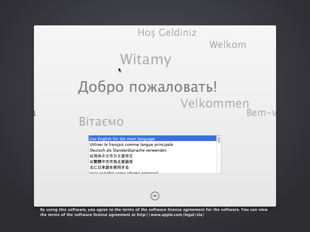

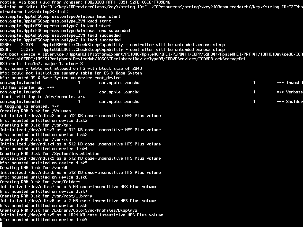

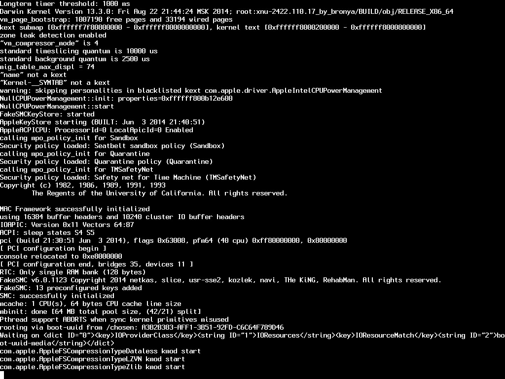

hi Bronya,
I have problem with kernel rc2 and kernel rc3 , if I remove not compatible kext drivers from S/L/E then I get problems with System.kext / plugins / unsupported.kext
can system.kext be the cause?
my problem is exactly as on picture 1 ( problem with Memory allocation error )

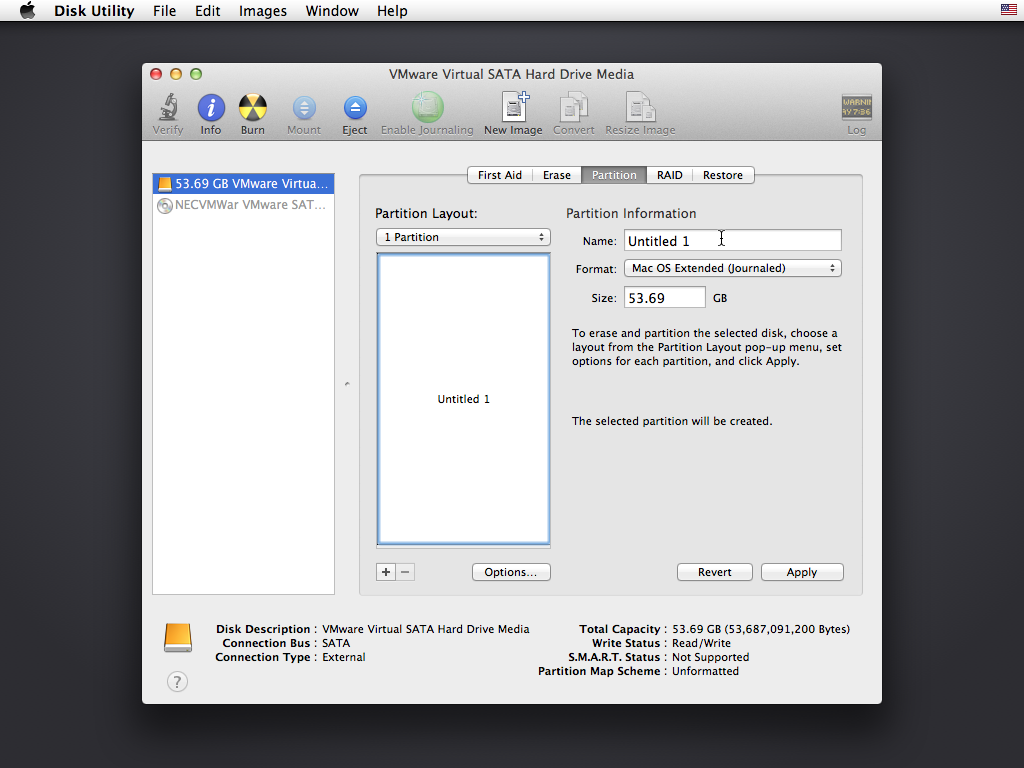

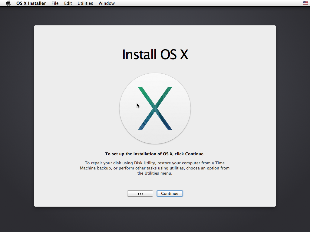

Tested this and managed to get VMWare 10 to start the installer, though my mouse and keyboard aren't working. I managed to get the mouse to work, but keyboard is still a no go. Will test more thoroughly once I get that to work. The load time to get to the initial installer welcome screen is quite slow, but the welcome screen itself seems is quite fast. Must faster than what I experienced with Niresh's distro.
As for VirtualBox, It get's stuck after SMC initialization, right after USBF CheckSleepCapability. No kernel panics or errors. Will post up the video (zip file) anyway and hopefully someone could shed some insight here.
Will come back once I got VMWare 10 working perfectly fine with some more results. If anyone knows and can tell me why my keyboard isn't working on VMWare 10, I would much appreciate it ^_^
Also another thing I noticed, when you only have a single core (processor) setup in VirtualBox you get the "divide by 0" panic again.
Will also post up some screenshots from VMWare 10 boot.

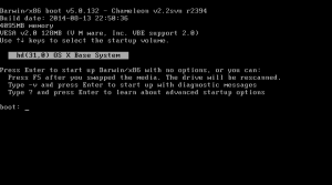

hi !
@spakk, your problem - "Memory Allocation Error " - it is because is many kexts in extra or modules . But it is problem only from bootloader chameleon, it is size buffer for memory .
Yosemite on amd - is only my patched kernel for test ! But don't working "sysenter" 32 bit .
@AlmirKadric, in VirtualBox no continue , because you should insert driver - AppleIntelPIIXATA.kext. If don't work keyboard , need kext ApplePS2Controller.kext and AppleACPIPS2Nub.kext !
I see in my paypal , is account is null , no gifts ... :\ .
hi Bronya,
with your statement of the problem: "Memory Allocation Error " in connection with /Extra/modules folder or may not be compatible driver in folder /Extra/Extensions/
I had yesterday removed these two folders and behold, the error does not occur. (test with rc1)
but as soon as I use a different kernel, for example rc2 or rc3 without exchanging System.kext,  I get this error message "Memory Allocation Error" ...
I think it somehow is related in connection with System.kext/plugins./unsupported.kext, because this error appears at the end after I have removed all incompatible drivers. funny
What is modified in the patched System.kext? Can the binary be patched with Clover?
