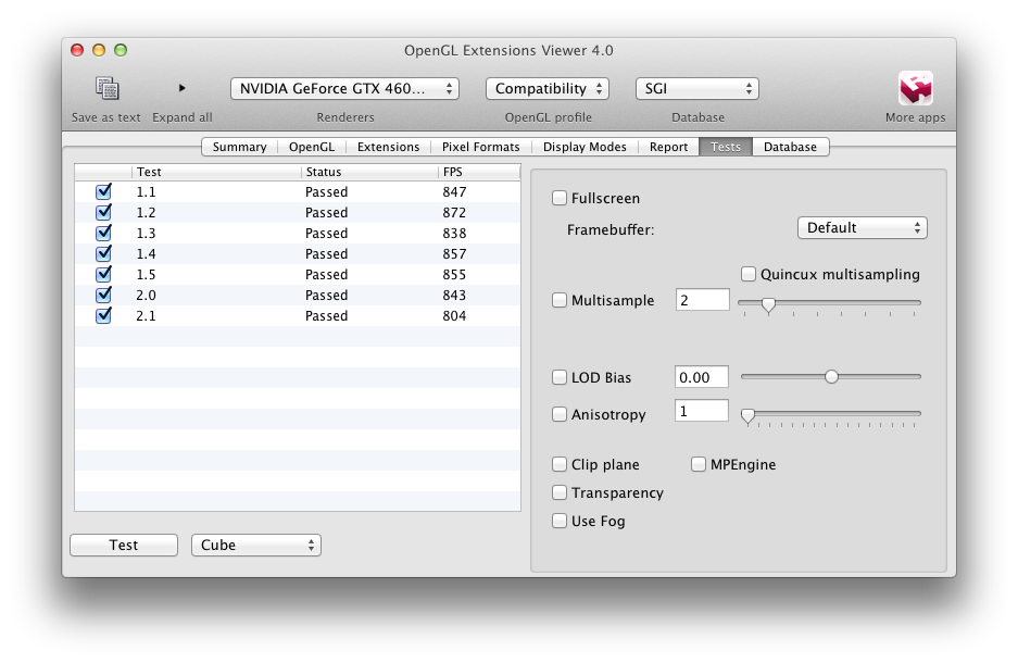

Blah101 Posted February 17, 2012 Share Posted February 17, 2012 I can confirm that on GT 425M, needed to patch AGPM on SL and Lion, now on ML it works OOB. I can also confirm my 460 is working fine OOB, no OpenGL fix needed. However, Luxmark does not run properly, so I think I may need an OpenCL fix. Proof: Link to comment Share on other sites More sharing options...

Riley Freeman Posted February 17, 2012 Share Posted February 17, 2012 I went ahead and replaced my Lion install with a fresh Mountain Lion. My GTX 460 worked OOB with my DSDT edit but how can I check that the power management is working without a AGPM edit? Link to comment Share on other sites More sharing options...

Riley Freeman Posted March 11, 2012 Share Posted March 11, 2012 Is there any way to confirm that the cards no longer need an AGPM edit for power management? I know my 460 is probably running full speed when I benchmark it, but how can I tell if it's throttling down when I'm just idling at the desktop? Link to comment Share on other sites More sharing options...
TH3L4UGH1NGM4N Posted March 11, 2012 Share Posted March 11, 2012 @Riley Freeman you could always use iStats to check on the temps of your card during the bench and when it's done and just idling at the desktop and see if there's a difference between the temps there. Link to comment Share on other sites More sharing options...
Gringo Vermelho Posted March 11, 2012 Share Posted March 11, 2012 Riley: Start OpenGL Extensions viewer and run the test in Full Screen. If it starts out with FPS in the hundreds and then suddenly jumps to 4000+ FPS then throttling is working. Link to comment Share on other sites More sharing options...
Riley Freeman Posted March 12, 2012 Share Posted March 12, 2012 Start OpenGL Extensions viewer and run the test in Full Screen. If it starts out with FPS in the hundreds and then suddenly jumps to 4000+ FPS then throttling is working. Good idea! I tried this a couple of times. First it started out around 2500 and quickly ramped up to around 3200. Then I left it for a few minutes, tried again and it seemed to start around 1000 or so. So it looks like throttling is working! Link to comment Share on other sites More sharing options...
^Andy^ Posted March 12, 2012 Share Posted March 12, 2012 That doesn't sound right to me - my 570 starts in the 100's and a second or so later jumps up to 5,900 ish on the first run - may depend what you have running in the background though. Link to comment Share on other sites More sharing options...
Riley Freeman Posted March 12, 2012 Share Posted March 12, 2012 I've nothing running in the background. It's just idling. I doubt the model identifier matters if the throttling is being done in the nVidia drivers but I have mine set as iMac9,1. I'll try it a few more times with different pauses in between to make sure everything is nice and idle but it certainly didn't start off as low as 100s. And it made it up to the full 3200-ish within a second or two. It's kinda hard to see exactly what it starts at. Would speedstepping also be a factor? I have it disabled here as I have my C2D overclocked. So the CPU is always at full speed. Link to comment Share on other sites More sharing options...
Gringo Vermelho Posted March 12, 2012 Share Posted March 12, 2012 I'm seeing the exact same behavior as Andy (low hundreds and then boom) except 5900 FPS is insane! I'm getting around 4300 here at 1280x1024 - GTX 460, 10.7.3 with the new nvidia drivers, MacPro3,1 identifier - which means no AGPM.kext loaded. AGPM loads on iMac9,1 so you might have a conflict of interests there? Remember that the iMac9,1 is built almost like a laptop, it makes sense for its AGPM configuration to employ agressive throttling. Even if you have customized it yourself, try temporarily removing AGPM.kext and see what happens then. I believe it's safe to remove it! Make sure to do sudo touch /System/Library/Extensions after moving it out so that it doesn't linger in the cache. 3200 FPS sounds kind of low which I guess confirms my theory, unless you're running at a really high resolution? Even then I don't think your score should be a whole 1000 FPS lower than mine, that's a bit much. Link to comment Share on other sites More sharing options...
Riley Freeman Posted March 13, 2012 Share Posted March 13, 2012 I stopped using the legacy AGPM kext a while back so I'm not sure the AGPM kext is doing much as it isn't going to match the 460's vendor/device id without the legacy kext override. When I had it installed I was getting scores around 2400 as I had it geared for power management rather than raw power. So just removing the legacy AGPM has given a 33% performance boost. The benchmarks are running at 1680x1050 as that's my native screen res. Also, the values I'm throwing out are just for the first test (OpenGL 1.1). Link to comment Share on other sites More sharing options...
