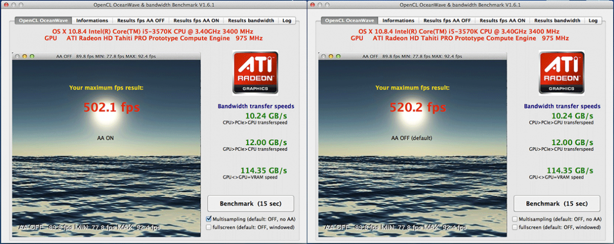

eep357 Posted March 22, 2013 Share Posted March 22, 2013 Eep357, differ from who/what? That was precisely my point, thus my surprise seeing nVidia benching higher in this topic. But i think mitch_de explained things quite well. Sorry! I hadn't noticed Nvidia benching higher, was looking only at the "pole position" on page 1 where it got stomped And above graph where only Nvidia cards in SLI were able to top single AMD. Kinda figured below that, it all depends on cards age who score best. Link to comment https://www.insanelymac.com/forum/topic/268209-opencl-oceanwave-bench-and-new-compubench-cl/page/13/#findComment-1899707 Share on other sites More sharing options...

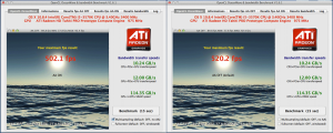

fau7i Posted May 11, 2013 Share Posted May 11, 2013 First time I got no error. In fact, I have to turn off HD 4000 to get this scores. Link to comment https://www.insanelymac.com/forum/topic/268209-opencl-oceanwave-bench-and-new-compubench-cl/page/13/#findComment-1914262 Share on other sites More sharing options...

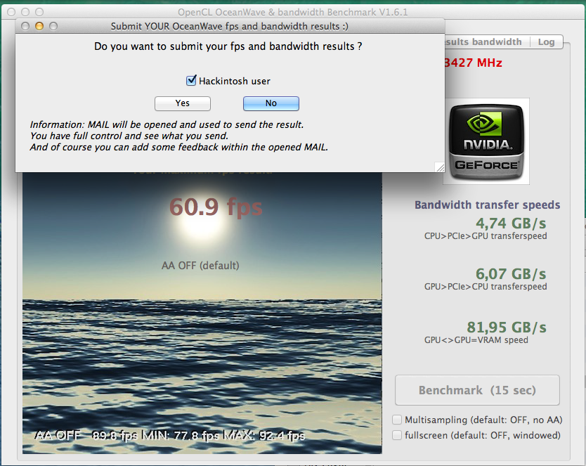

k3nny Posted June 11, 2013 Share Posted June 11, 2013 Test with 10.9 DP1: FPS is locked at ~60. Probably an issue with VSync? Link to comment https://www.insanelymac.com/forum/topic/268209-opencl-oceanwave-bench-and-new-compubench-cl/page/13/#findComment-1921614 Share on other sites More sharing options...
stefano.85 Posted June 11, 2013 Share Posted June 11, 2013 Test with 10.9 DP1: FPS is locked at ~60. Probably an issue with VSync? +1 same here... on first system in signature Link to comment https://www.insanelymac.com/forum/topic/268209-opencl-oceanwave-bench-and-new-compubench-cl/page/13/#findComment-1922848 Share on other sites More sharing options...

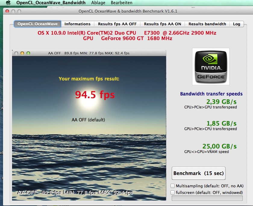

mitch_de Posted June 12, 2013 Author Share Posted June 12, 2013 MY 9600 GT getting 94 FPS (on 60 Hz TFT, same as 10.8) with 10.9 DP1 - so perhaps other problem (driver dependend, gpu type depended) Link to comment https://www.insanelymac.com/forum/topic/268209-opencl-oceanwave-bench-and-new-compubench-cl/page/13/#findComment-1923079 Share on other sites More sharing options...

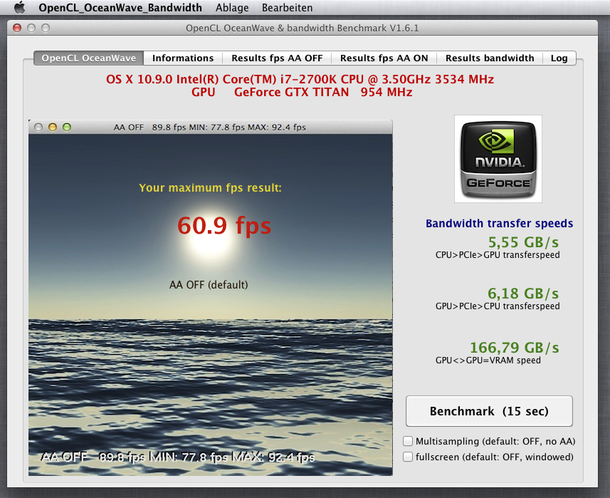

RobertX Posted October 7, 2013 Share Posted October 7, 2013 ...@mitch_de ...got that issue here using the GM Link to comment https://www.insanelymac.com/forum/topic/268209-opencl-oceanwave-bench-and-new-compubench-cl/page/13/#findComment-1951652 Share on other sites More sharing options...
fau7i Posted October 23, 2013 Share Posted October 23, 2013 In Mavericks GM, same issue. And, Tahiti becomes FirePro Link to comment https://www.insanelymac.com/forum/topic/268209-opencl-oceanwave-bench-and-new-compubench-cl/page/13/#findComment-1957016 Share on other sites More sharing options...

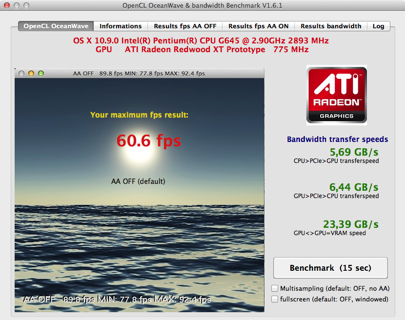

XanthraX Posted October 23, 2013 Share Posted October 23, 2013 Mavericks 10.9 on Gigabyte GA-B75M-D3H, CPU: Intel® Pentium® Processor G645 (3M Cache, 2.90 GHz), Graphic card: Asus EAH5670 (AMD Radeon HD 5670, GDDR5 1GB) Link to comment https://www.insanelymac.com/forum/topic/268209-opencl-oceanwave-bench-and-new-compubench-cl/page/13/#findComment-1957019 Share on other sites More sharing options...

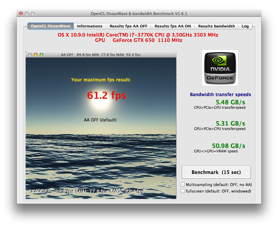

DanMcQ Posted October 23, 2013 Share Posted October 23, 2013 Running 10.9 Build 13A603 on a Gigabyte GA-Z77X-UP5-TH, GTX650, Core i7 3770k @ 3.5ghz Link to comment https://www.insanelymac.com/forum/topic/268209-opencl-oceanwave-bench-and-new-compubench-cl/page/13/#findComment-1957115 Share on other sites More sharing options...

mitch_de Posted October 28, 2013 Author Share Posted October 28, 2013 60 FPS has to do with 10.9 AND kind of GPU. My 440 GT (NVDAGF100Hal) hasnt that effect even running 10.9 on 60 Hz tft (getting 105 FPS). Perhaps some Nvidia driver bug using vsync even if programm disable that. Link to comment https://www.insanelymac.com/forum/topic/268209-opencl-oceanwave-bench-and-new-compubench-cl/page/13/#findComment-1959874 Share on other sites More sharing options...
shiecldk Posted November 12, 2013 Share Posted November 12, 2013 HD6850 is locked at 60fps too. I guess it might has something to do with Maverick's energy-saving feature. @mitch_de When I put a window cover the Oceanwave app, the score will boost back. 1 Link to comment https://www.insanelymac.com/forum/topic/268209-opencl-oceanwave-bench-and-new-compubench-cl/page/13/#findComment-1966933 Share on other sites More sharing options...
RobertX Posted November 18, 2013 Share Posted November 18, 2013 HD6850 is locked at 60fps too. I guess it might has something to do with Maverick's energy-saving feature. @mitch_de When I put a window cover the Oceanwave app, the score will boost back. same...window covered , back to normal scores Link to comment https://www.insanelymac.com/forum/topic/268209-opencl-oceanwave-bench-and-new-compubench-cl/page/13/#findComment-1969530 Share on other sites More sharing options...

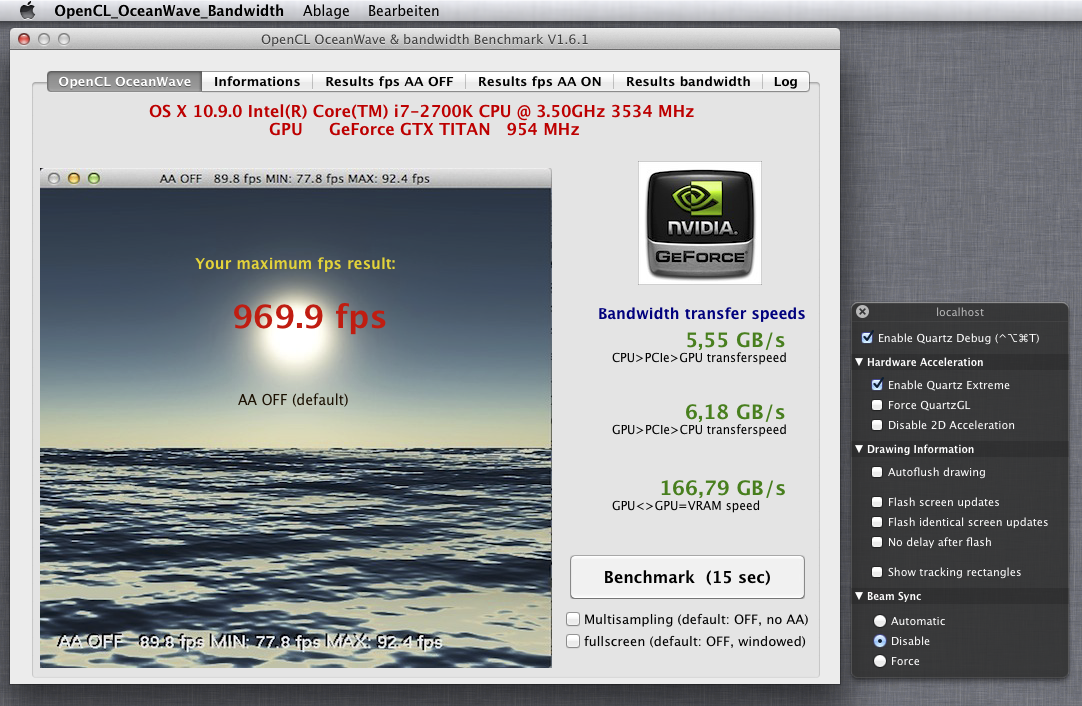

npwski Posted November 20, 2013 Share Posted November 20, 2013 GTX Titan oc'ed @1132, OS 10.9 /13A603 This 60 fps - with default settings:As I understand, it's because refresh is locked. This 969 fps - with option "BeamSync=Disable" (Quartz Debug.app)I don't know, this result is correct or not. May be is there other way to disable vsync? Link to comment https://www.insanelymac.com/forum/topic/268209-opencl-oceanwave-bench-and-new-compubench-cl/page/13/#findComment-1969900 Share on other sites More sharing options...

beasty uk Posted November 20, 2013 Share Posted November 20, 2013 Well the debug app fixed my score 280fps from 60 but fcpx runs great without this app i think it only gives you better ocean wave score Link to comment https://www.insanelymac.com/forum/topic/268209-opencl-oceanwave-bench-and-new-compubench-cl/page/13/#findComment-1969985 Share on other sites More sharing options...

beasty uk Posted November 21, 2013 Share Posted November 21, 2013 You just drag a window over the benchmark when its going and it speeds up from 60fps to the right fps. And the other is an app you can click disable beam sync and it sorts the score out without a window. And thats all the 2 things do is make the fps right in ocean wave nothing else. I thought it would make mavericks run smoother but it does not lol Link to comment https://www.insanelymac.com/forum/topic/268209-opencl-oceanwave-bench-and-new-compubench-cl/page/13/#findComment-1970207 Share on other sites More sharing options...
