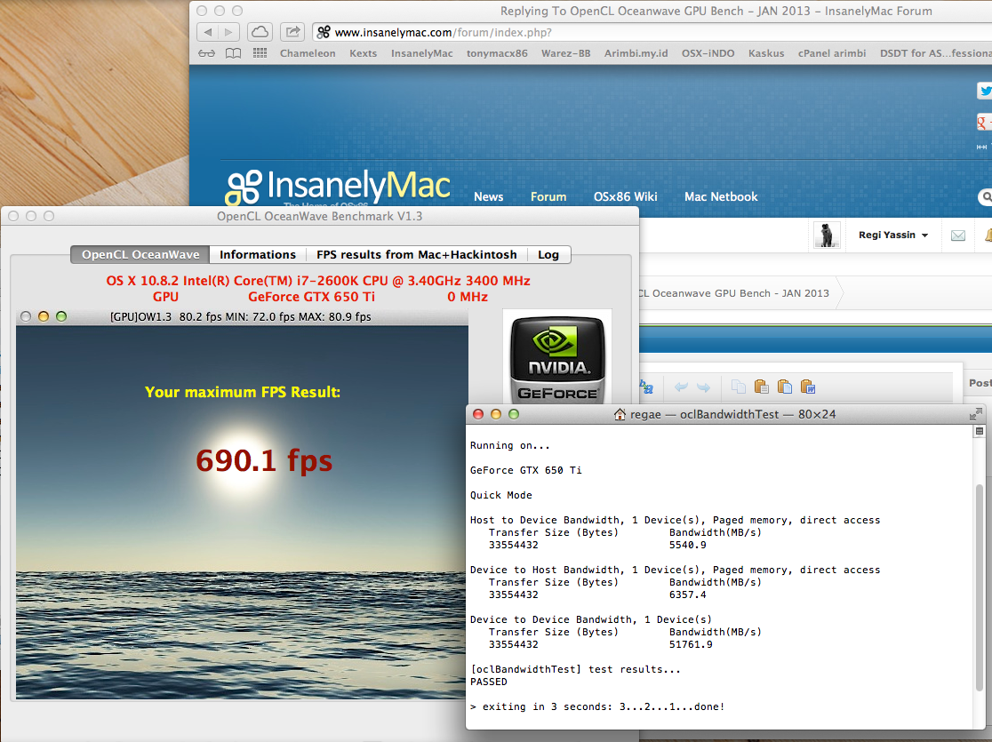

Regi Yassin Posted February 4, 2013 Share Posted February 4, 2013 here is my results hw details, in sig nvidia official driver for 10.8.2 + cuda 5.0.37 + agpm edit iMac 12,2 Link to comment https://www.insanelymac.com/forum/topic/268209-opencl-oceanwave-bench-and-new-compubench-cl/page/10/#findComment-1885999 Share on other sites More sharing options...
mitch_de Posted February 4, 2013 Author Share Posted February 4, 2013 Great to see GTX 650 Ti works well & fast. Link to comment https://www.insanelymac.com/forum/topic/268209-opencl-oceanwave-bench-and-new-compubench-cl/page/10/#findComment-1886055 Share on other sites More sharing options...

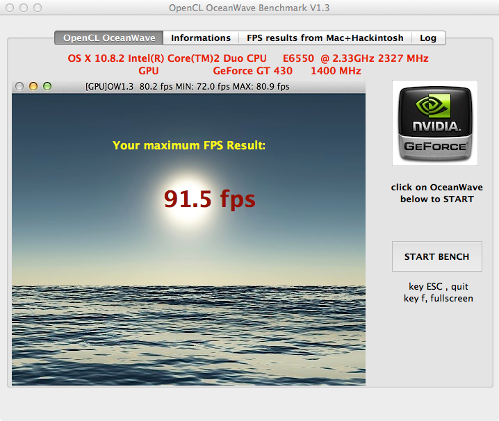

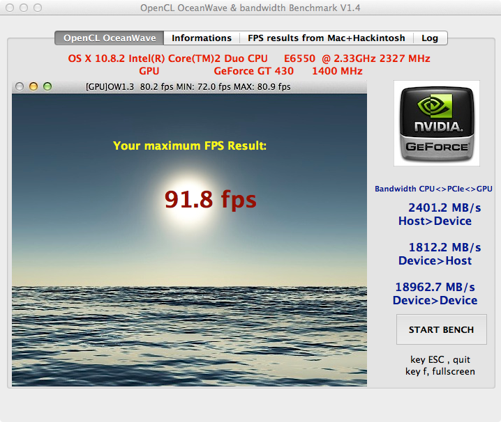

RobertX Posted February 4, 2013 Share Posted February 4, 2013 ...and now for something completely different... /Users/leslie/Downloads/oclBandwidthTest Starting... Running on... GeForce GT 430 Quick Mode Host to Device Bandwidth, 1 Device(s), Paged memory, direct access Transfer Size (Bytes) Bandwidth(MB/s) 33554432 161.5 Device to Host Bandwidth, 1 Device(s), Paged memory, direct access Transfer Size (Bytes) Bandwidth(MB/s) 33554432 202.9 Device to Device Bandwidth, 1 Device(s) Transfer Size (Bytes) Bandwidth(MB/s) 33554432 12265.7 [oclBandwidthTest] test results... PASSED > exiting in 3 seconds: 3...2...1...done! logout Link to comment https://www.insanelymac.com/forum/topic/268209-opencl-oceanwave-bench-and-new-compubench-cl/page/10/#findComment-1886110 Share on other sites More sharing options...
mitch_de Posted February 5, 2013 Author Share Posted February 5, 2013 uuups, really low (never seen!) Bandwidth speeds of your GT 430 card. Test it again - dont use it beside any other app running , and dont move mouse as it runs. Isnt a burner but should perform at least the CPUGPU MB/s many times faster. At least 3-4 times faster should even lowest end GPUs like GT GT 210 /220 the PCIe Slot + CPU + BUS transfer the data to/from gpu. Such PCIe Speed looks like AGP transferspeeds (old GPU slot type). Perhaps some Interrupt problems ? We should collect some similar gpu bandwidth results for that user. background: low bandwidth speeds may NOT end in also low OpenGL/OpenCL speeds but will have an negative effect. On OpenGL for texture transfers, for OpenCL/CUDA data transfers. Link to comment https://www.insanelymac.com/forum/topic/268209-opencl-oceanwave-bench-and-new-compubench-cl/page/10/#findComment-1886234 Share on other sites More sharing options...
RobertX Posted February 5, 2013 Share Posted February 5, 2013 Running on... GeForce GT 430 Quick Mode Host to Device Bandwidth, 1 Device(s), Paged memory, direct access Transfer Size (Bytes) Bandwidth(MB/s) 33554432 162.4 Device to Host Bandwidth, 1 Device(s), Paged memory, direct access Transfer Size (Bytes) Bandwidth(MB/s) 33554432 203.1 Device to Device Bandwidth, 1 Device(s) Transfer Size (Bytes) Bandwidth(MB/s) 33554432 11875.8 [oclBandwidthTest] test results... PASSED > exiting in 3 seconds: 3...2...1...done! system profiler says my x16 pci-e card (128bit)is running at x1 ...examining the card i've found two or more of the gold connector pins appear damaged(not full length like the others) windows8 also reports x1 lane width and it's still faster than my gt520(which is only 64bit) Link to comment https://www.insanelymac.com/forum/topic/268209-opencl-oceanwave-bench-and-new-compubench-cl/page/10/#findComment-1886346 Share on other sites More sharing options...
RobertX Posted February 6, 2013 Share Posted February 6, 2013 rolled back my drivers... new results /Users/leslie/Downloads/oclBandwidthTest Starting... Running on... GeForce GT 430 Quick Mode Host to Device Bandwidth, 1 Device(s), Paged memory, direct access Transfer Size (Bytes) Bandwidth(MB/s) 33554432 10129.9 Device to Host Bandwidth, 1 Device(s), Paged memory, direct access Transfer Size (Bytes) Bandwidth(MB/s) 33554432 31610.5 Device to Device Bandwidth, 1 Device(s) Transfer Size (Bytes) Bandwidth(MB/s) 33554432 6642.8 [oclBandwidthTest] test results... PASSED > exiting in 3 seconds: 3...2...1...done! EDIT: got it working... http://www.insanelymac.com/forum/topic/286133-asus-gt430-running-pci-e-lane-width-x1/ Link to comment https://www.insanelymac.com/forum/topic/268209-opencl-oceanwave-bench-and-new-compubench-cl/page/10/#findComment-1886395 Share on other sites More sharing options...

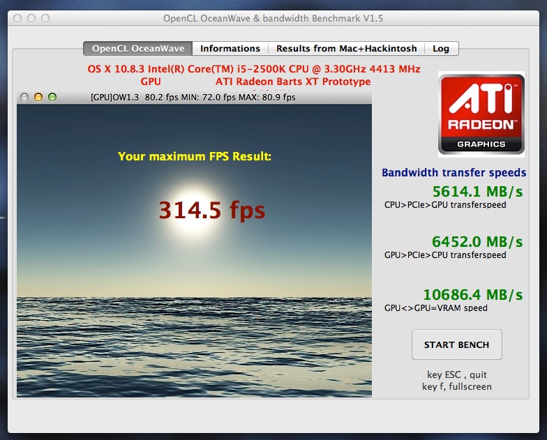

mitch_de Posted March 1, 2013 Author Share Posted March 1, 2013 Wow got fast bandwidth results: HACKINTOSH OS X 10.8.3 Intel® Core™ i5-3570K CPU @ 3.40GHz 3400 MHz GPU ATI Radeon HD Pitcairn XT Prototype Compute Engine 1000 MHz 444.9 fps Bandwidthes: device>host: 12002.8 MB/s host>device:10074.9 MB/s device >device (VRAM): 83085.6MB/s What kind of AMD 6/7xxx gpu? Most users will be limited by PCi 2.0 with max. 8000 MB/sec. Link to comment https://www.insanelymac.com/forum/topic/268209-opencl-oceanwave-bench-and-new-compubench-cl/page/10/#findComment-1893215 Share on other sites More sharing options...
k3nny Posted March 1, 2013 Share Posted March 1, 2013 It is an XFX Raden HD 7870 DD with the hardware in my signature. Would be interesting to see a comparison to another 7xxx card. eep357, where are you? Link to comment https://www.insanelymac.com/forum/topic/268209-opencl-oceanwave-bench-and-new-compubench-cl/page/10/#findComment-1893219 Share on other sites More sharing options...

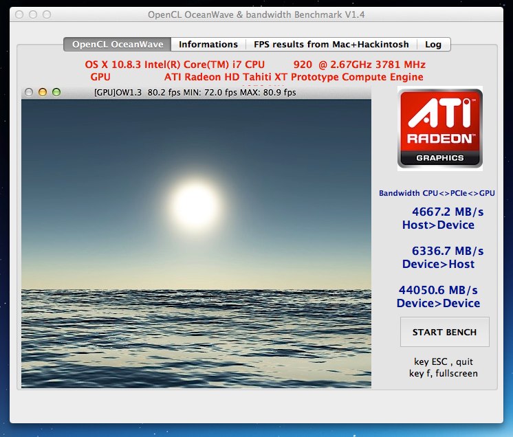

eep357 Posted March 2, 2013 Share Posted March 2, 2013 @k3nny- If 90000MB/s is max possible for 512bit VRAM, I don't think device >device (VRAM): 83085.6MB/s can be possible with 256bit GDDR5 memory on the 7870? Since your using Clover to boot, in config.plist be sure there are no values entered for CPU speed or Turbo as this can slow down the OS system clock and cause OS to think things are going faster than they really are. Link to comment https://www.insanelymac.com/forum/topic/268209-opencl-oceanwave-bench-and-new-compubench-cl/page/10/#findComment-1893374 Share on other sites More sharing options...
