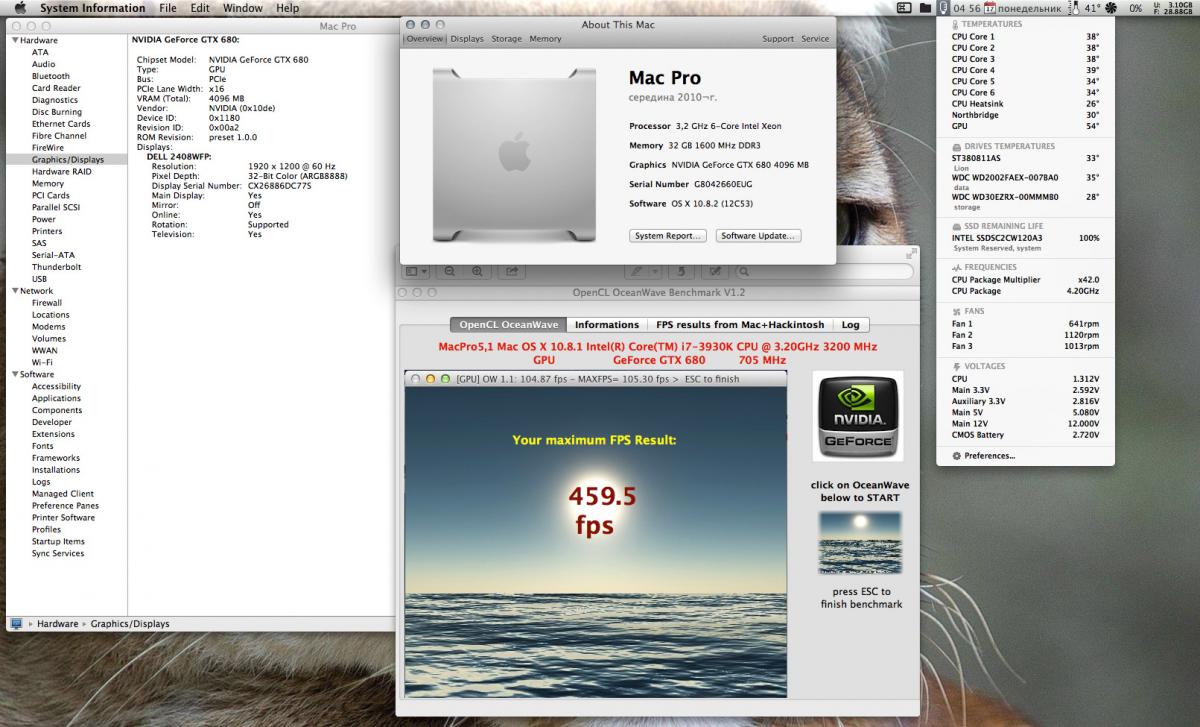

choocha777 Posted September 12, 2012 Share Posted September 12, 2012 3930K 4.2GHz + GTX680 Link to comment https://www.insanelymac.com/forum/topic/268209-opencl-oceanwave-bench-and-new-compubench-cl/page/8/#findComment-1852155 Share on other sites More sharing options...

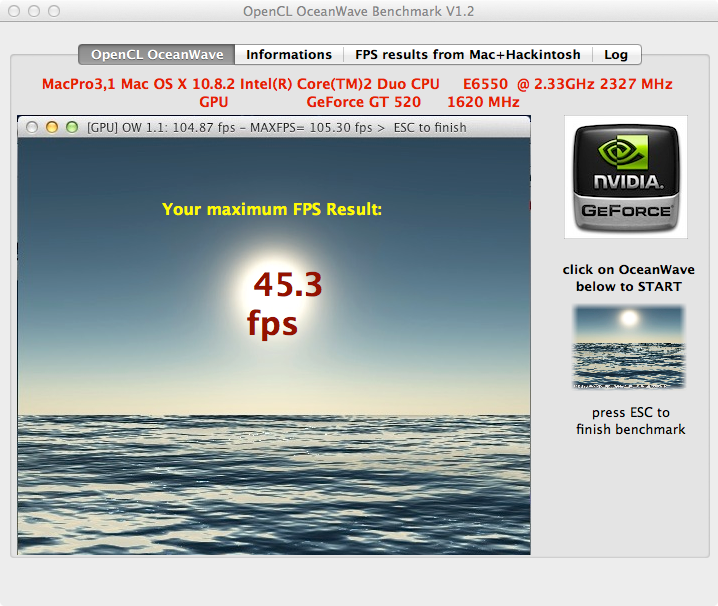

RobertX Posted September 14, 2012 Share Posted September 14, 2012 got it working now with the new nvidia drivers...an opencl patch can be found here http://www.insanelym...ic=266318&st=80 my humble results... Link to comment https://www.insanelymac.com/forum/topic/268209-opencl-oceanwave-bench-and-new-compubench-cl/page/8/#findComment-1852669 Share on other sites More sharing options...
mitch_de Posted September 14, 2012 Author Share Posted September 14, 2012 Yep, but GT520 is more an low end gpu, even newer. Link to comment https://www.insanelymac.com/forum/topic/268209-opencl-oceanwave-bench-and-new-compubench-cl/page/8/#findComment-1852697 Share on other sites More sharing options...
RobertX Posted September 14, 2012 Share Posted September 14, 2012 Yep, but GT520 is more an low end gpu, even newer. ...and yet, it does work :wink2: 1 Link to comment https://www.insanelymac.com/forum/topic/268209-opencl-oceanwave-bench-and-new-compubench-cl/page/8/#findComment-1852722 Share on other sites More sharing options...
mitch_de Posted September 14, 2012 Author Share Posted September 14, 2012 Yep, GT520 has good power consumtion. Only the VRAM bandwidth is low (64 Bit vs 128 /192 Bit others). I also looking for some newer low end gpu - perhaps GT630 (similar speed as 9600GT, lower Watt). GT630OEM would be even better (much faster Kepler vs Fermi non OEM). Link to comment https://www.insanelymac.com/forum/topic/268209-opencl-oceanwave-bench-and-new-compubench-cl/page/8/#findComment-1852760 Share on other sites More sharing options...

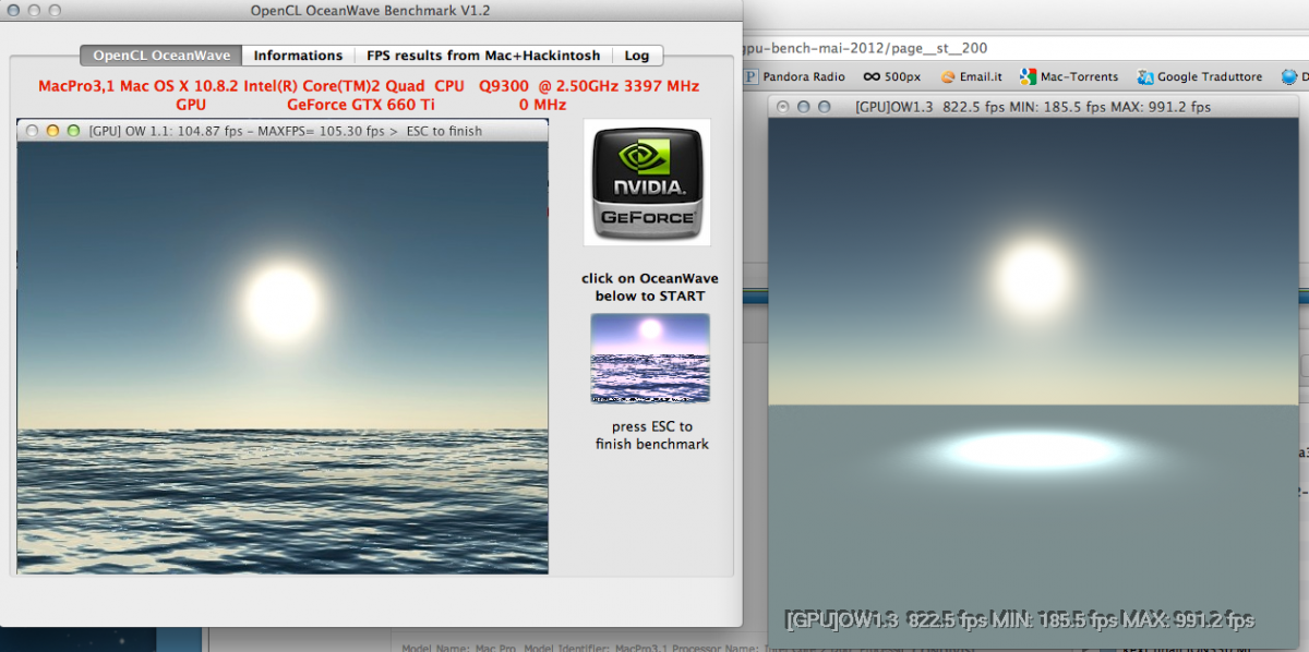

stefano.85 Posted December 4, 2012 Share Posted December 4, 2012 it seems that in this benchmark i've got a problem... Nvidia retail 304.00.05f02 drivers + Cuda 5.0.37 + ONLY opencl 2gb+ patch from netkas. I think i've to do some other patches....right? Link to comment https://www.insanelymac.com/forum/topic/268209-opencl-oceanwave-bench-and-new-compubench-cl/page/8/#findComment-1871028 Share on other sites More sharing options...
mitch_de Posted December 4, 2012 Author Share Posted December 4, 2012 Nope - you have already patched for OpenCL available but the newer drivers fail in the code of Oceanwave. Doesnt matter much if other OpenCL Apps run well. Perhaps next drivers work well (after patching them also) with that Code. In the past often (even OpenCL works in general) OceanWave shows now water reflections = driver bug. Link to comment https://www.insanelymac.com/forum/topic/268209-opencl-oceanwave-bench-and-new-compubench-cl/page/8/#findComment-1871090 Share on other sites More sharing options...

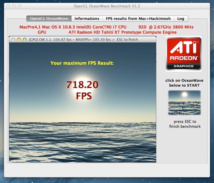

eep357 Posted January 4, 2013 Share Posted January 4, 2013 Link to comment https://www.insanelymac.com/forum/topic/268209-opencl-oceanwave-bench-and-new-compubench-cl/page/8/#findComment-1878115 Share on other sites More sharing options...
mitch_de Posted January 5, 2013 Author Share Posted January 5, 2013 WOW - new pole position with AMD 7970 - added to results list (post 1) 2 Link to comment https://www.insanelymac.com/forum/topic/268209-opencl-oceanwave-bench-and-new-compubench-cl/page/8/#findComment-1878159 Share on other sites More sharing options...
