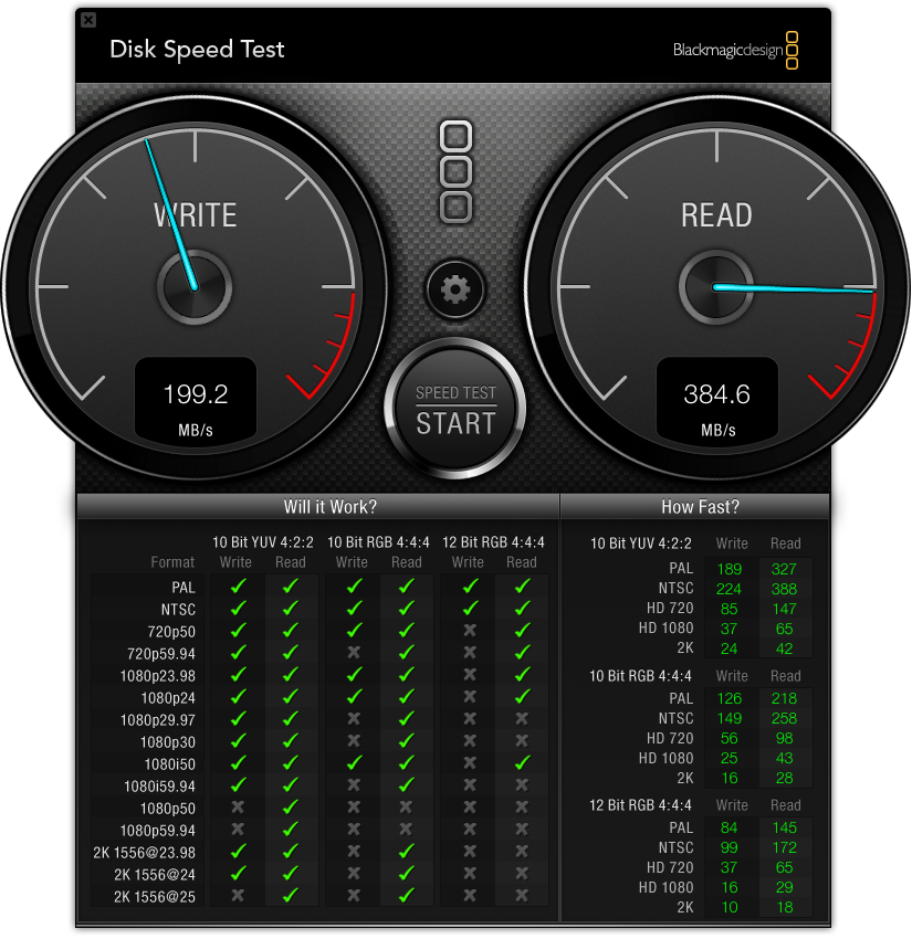

Hexidecimal Posted February 24, 2012 Share Posted February 24, 2012 I ended up picking up one of these cards: http://www.amazon.com/gp/product/B005B0A6ZS/ref=oh_o00_s00_i00_details Installed into a PCI-e 1x slot, had to bend the back plate slightly to get a solid connection and still be able to screw it to the case. Reloaded the OS on the new controller. Detected automatically, no configuration or drivers needed. Solid card, nice to get my SSD off my southbridge. I'm seeing about 200MB/s read speeds with it which is slow for the Crucial M4 128GB I have, but still infinitely faster than my old magnetic drive. Link to comment https://www.insanelymac.com/forum/topic/265281-sata-6gbs-sata-iii-pcie-card-works-in-lion/page/2/#findComment-1800069 Share on other sites More sharing options...
TH3L4UGH1NGM4N Posted February 24, 2012 Share Posted February 24, 2012 Sadly it's because of the limitations on the pcie x1 bus Hexa, it doesn't have enough bandwidth for fledged SATA III drives (dunno why don't they just market it as SATA II as it's works at those speeds). Of course if coming from a magnetic disk that peaks at around ~60-70 mb/s and you're running at near 200 mb/s it will most definitely seem infinetely faster Link to comment https://www.insanelymac.com/forum/topic/265281-sata-6gbs-sata-iii-pcie-card-works-in-lion/page/2/#findComment-1800087 Share on other sites More sharing options...
Hexidecimal Posted February 24, 2012 Share Posted February 24, 2012 (edited) I've got an open 16x slot. Think I'd get better results if I move the card down to there? Edited January 27, 2013 by Gringo Vermelho Fullquote removed Link to comment https://www.insanelymac.com/forum/topic/265281-sata-6gbs-sata-iii-pcie-card-works-in-lion/page/2/#findComment-1800231 Share on other sites More sharing options...
CJP2 Posted February 24, 2012 Share Posted February 24, 2012 Hex, You'll get much better results moving your card to the 16x slot. More bandwidth for those SATAIII speeds. Link to comment https://www.insanelymac.com/forum/topic/265281-sata-6gbs-sata-iii-pcie-card-works-in-lion/page/2/#findComment-1800244 Share on other sites More sharing options...
Hexidecimal Posted February 24, 2012 Share Posted February 24, 2012 Yeah you guys were 100% correct on that one. Moved it down to the PCI-e 16x 2.0 slot and speed shot through the roof. Thanks so much for the advice. This card is great, so happy with the results now! Link to comment https://www.insanelymac.com/forum/topic/265281-sata-6gbs-sata-iii-pcie-card-works-in-lion/page/2/#findComment-1800409 Share on other sites More sharing options...
